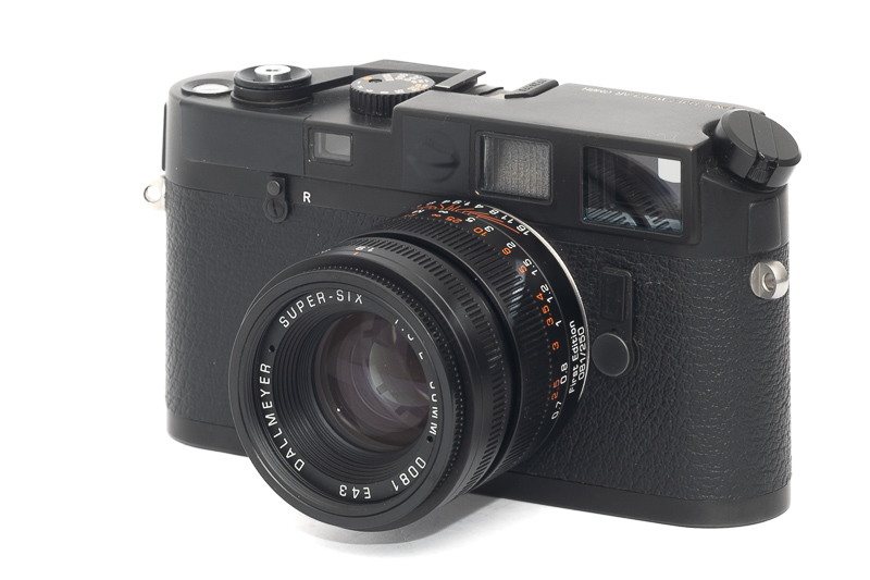

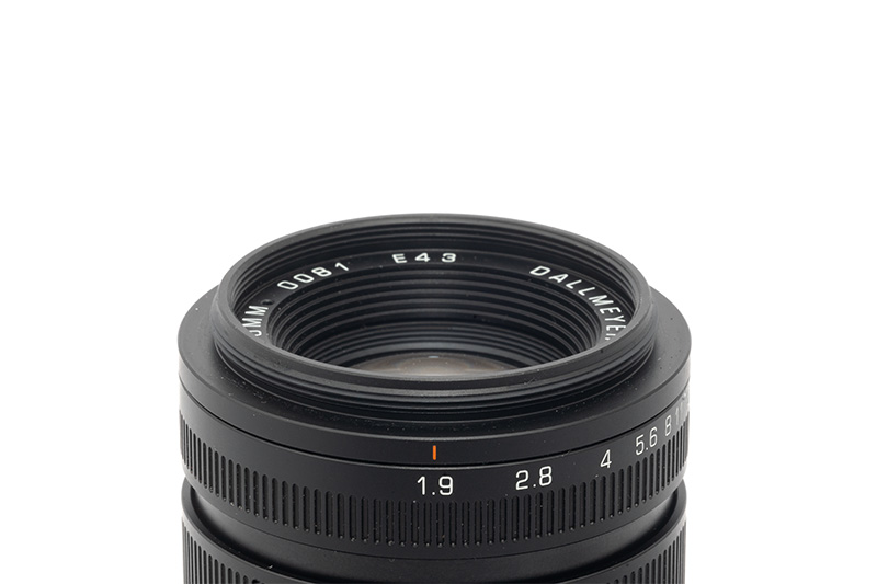

I was approached to have a look at this 50mm 1.9 M-mount lens that will be sold under the "Dallmeyer" brand.
I received the lens yesterday, hence I did not get to use it a lot, but I will already tell you what I know and update this post (of course also with sample pictures) when there is more to show.

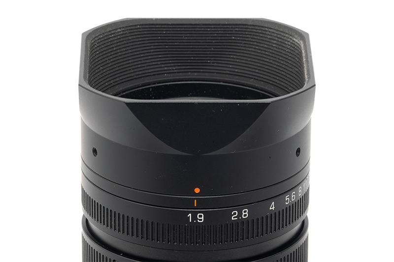

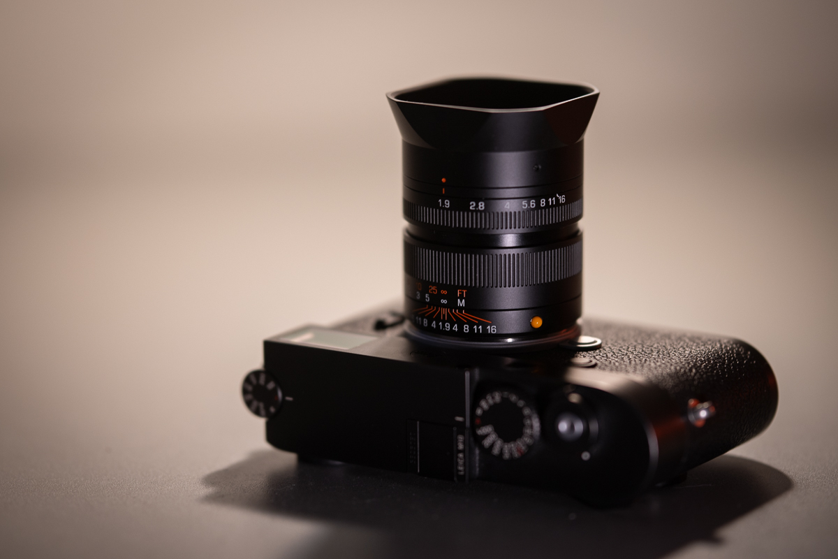

The lens is rangefinder coupled and the build quality does leave a nice first impression.
It has a square hood (and square is the truth here, not rectangular) and also comes with a small ring that can be attached instead of the hood.

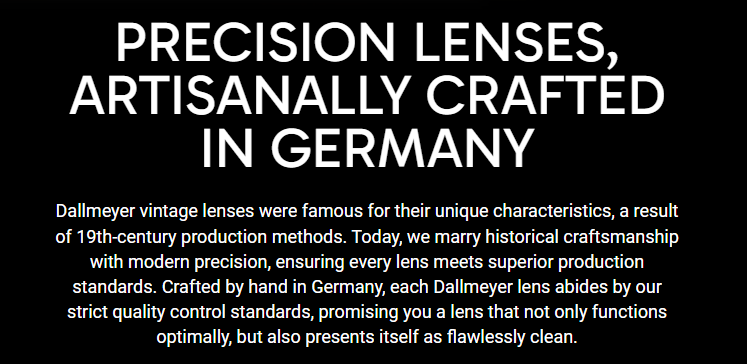

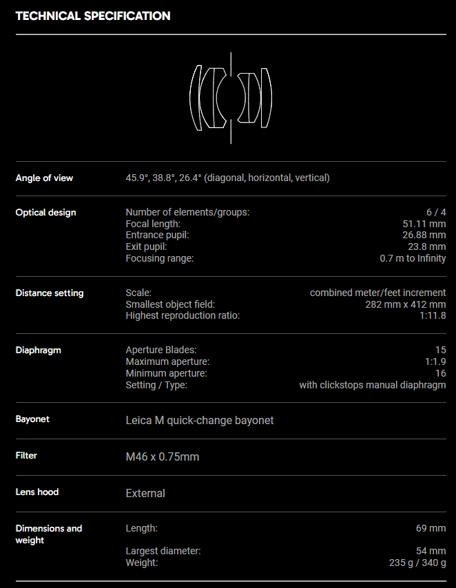

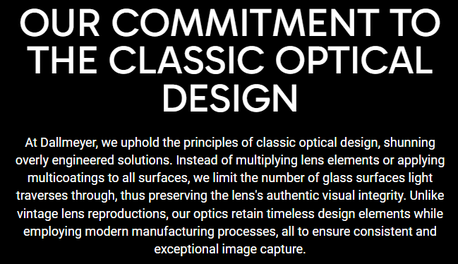

I also got some marketing material:
I was told the lens is made in Germany, I don't know where or by whom though.
There is no "Made in ... " stamp on the lens.
Behind this project is Photo Vision s.r.o. from Czech, who to my knowledge also hold the name to "Kinoptik".
This is not a high performance lens in the sense that it features a retrofocus design with a lot of elements, it is more of a classic double gauss.
Apparently it will start shipping in February 2025.

f/1.9 isn't particularly fast, but 15 aperture blades ... (i.e. bokeh potential vs. exposure / vignetting potential) could be an interesting pairing.

Lens with hood:

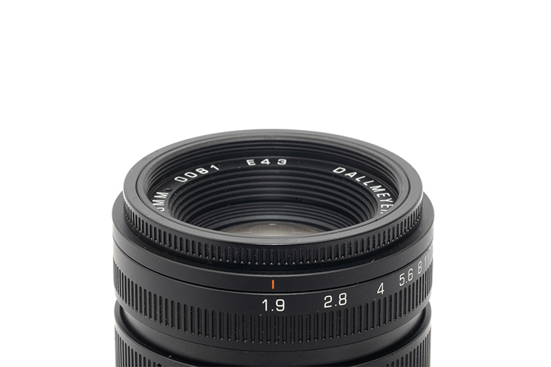

Lens without hood (no idea which size that male thread is, none of my standard metric sized filters fits):
Lens with spare front ring attached:
Lens with front ring on M6:
I think it is about the size of a 50mm 2.0 M-Hexanon without the hood.
