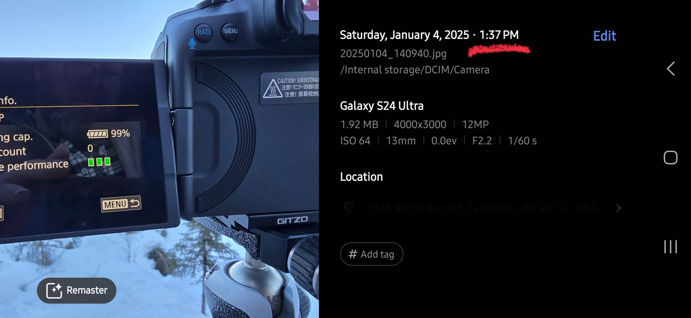

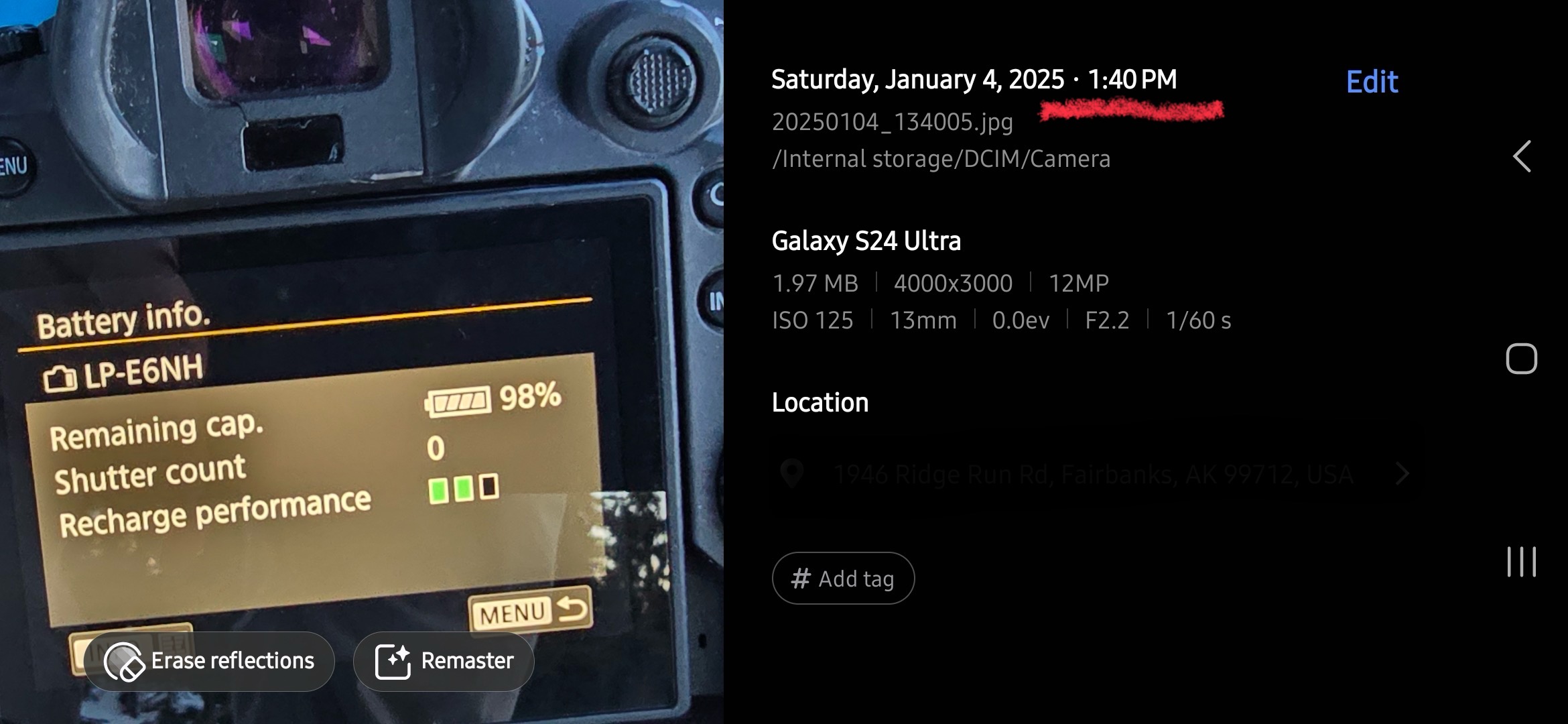

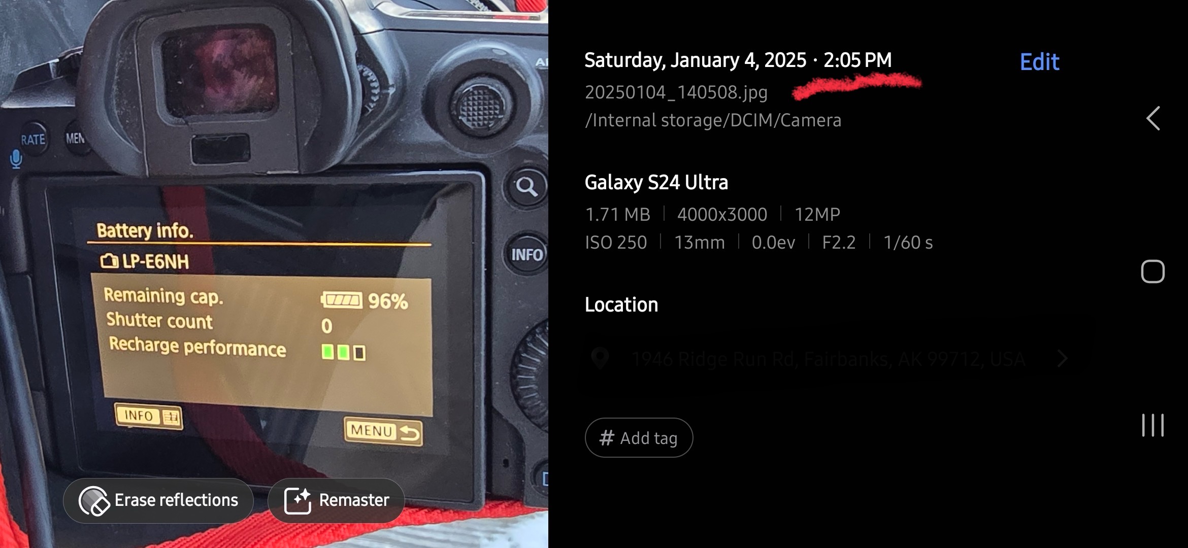

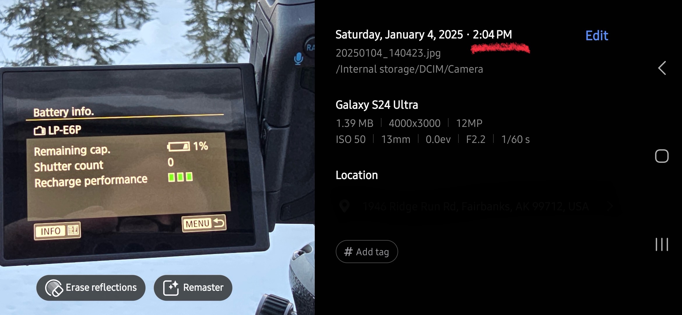

I've been in Yellowstone the last week with temps as low as - 19F, so I'll add my experience.
First day - batteries fully charged sat overnight at 10F. Shot in Lamar Valley at -19F for an hour with no issues.
Second day - batteries at 3/4 charge sat overnight at 15F. In the morning turned the camera on and batteries were nearly dead. Put them in my pocket to warm for 45 min while driving and they recovered. Lamar Valley was -10F and had no issues.
Third day - Fully charged the batteries and stored inside overnight. No issues at -14F.

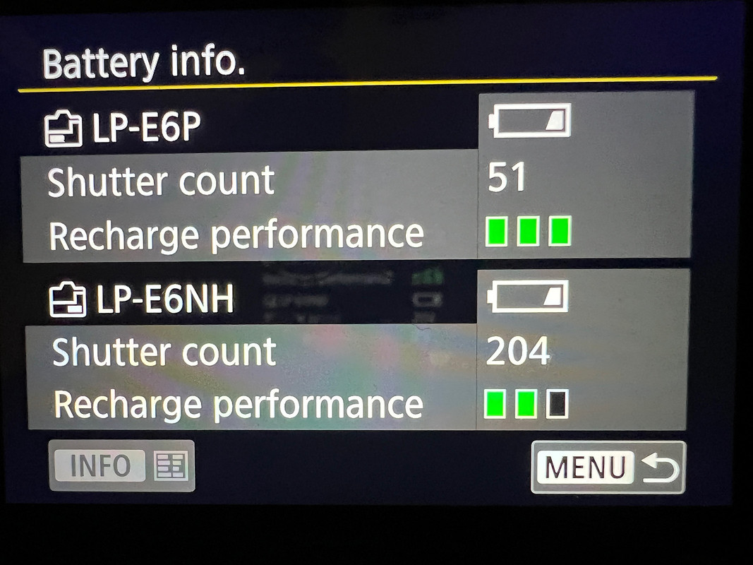

I shot a slow-paced 2-hour indoor event today and this is where the batteries were towards the end. IMO this is considerably worse battery life than I would expect. Maybe it's this specific camera?
Batteries were in a BG-R10 grip.
