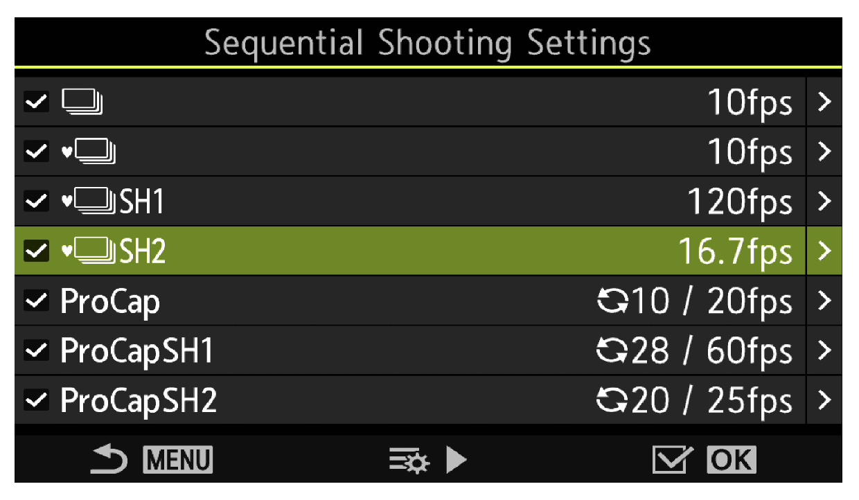

OM-1 MkII
With our Pro Capture Mode when you press the shutter button down halfway, it begins buffering a running series of photos at a maximum 120fps.
With increased memory in the camera, we’ve more than doubled the buffer size, jumping from 92* to an impressive 213 photos at 120 fps in RAW format.
Blackout-free sequential shooting. Now, in addition to the existing 25-120fps, we've added 12.5 fps and 16 fps for better shooting experience for static subjects.

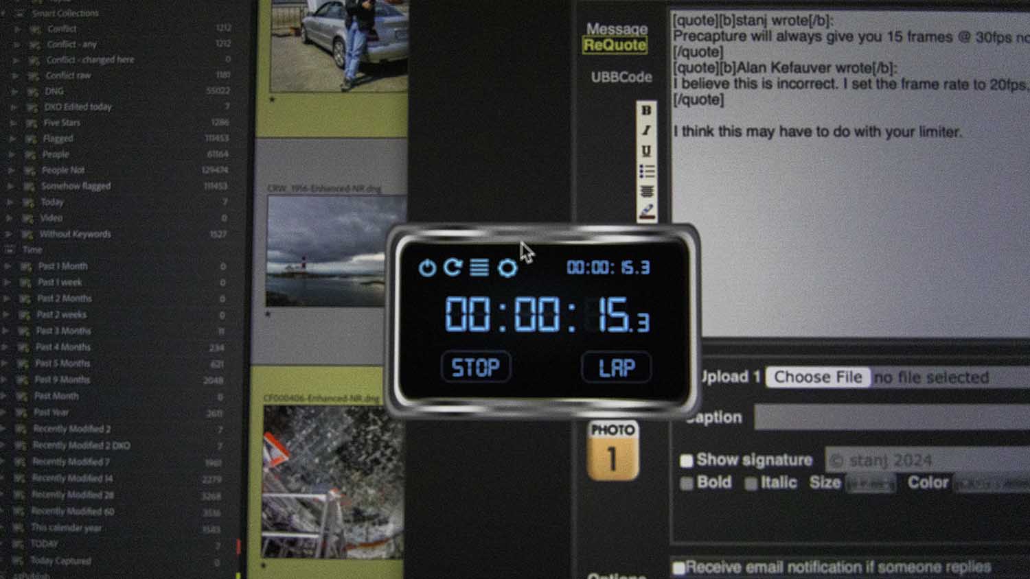

I just set the camera on slow (which in my case is 7.5fps), aimed it at a stopwatch, enabled pre-capture, allowed the buffer to fill, and then pressed as briefly as I can (at that frame rate I am confident to squeeze just one).
Here's the first and last frame. There's 2s difference (the stopwatch shows only one decimal, sorry.)
I confirmed I have frame rate set to 7.5 and 16 frames have been recorded (what's shown is frame #1 and #16).
