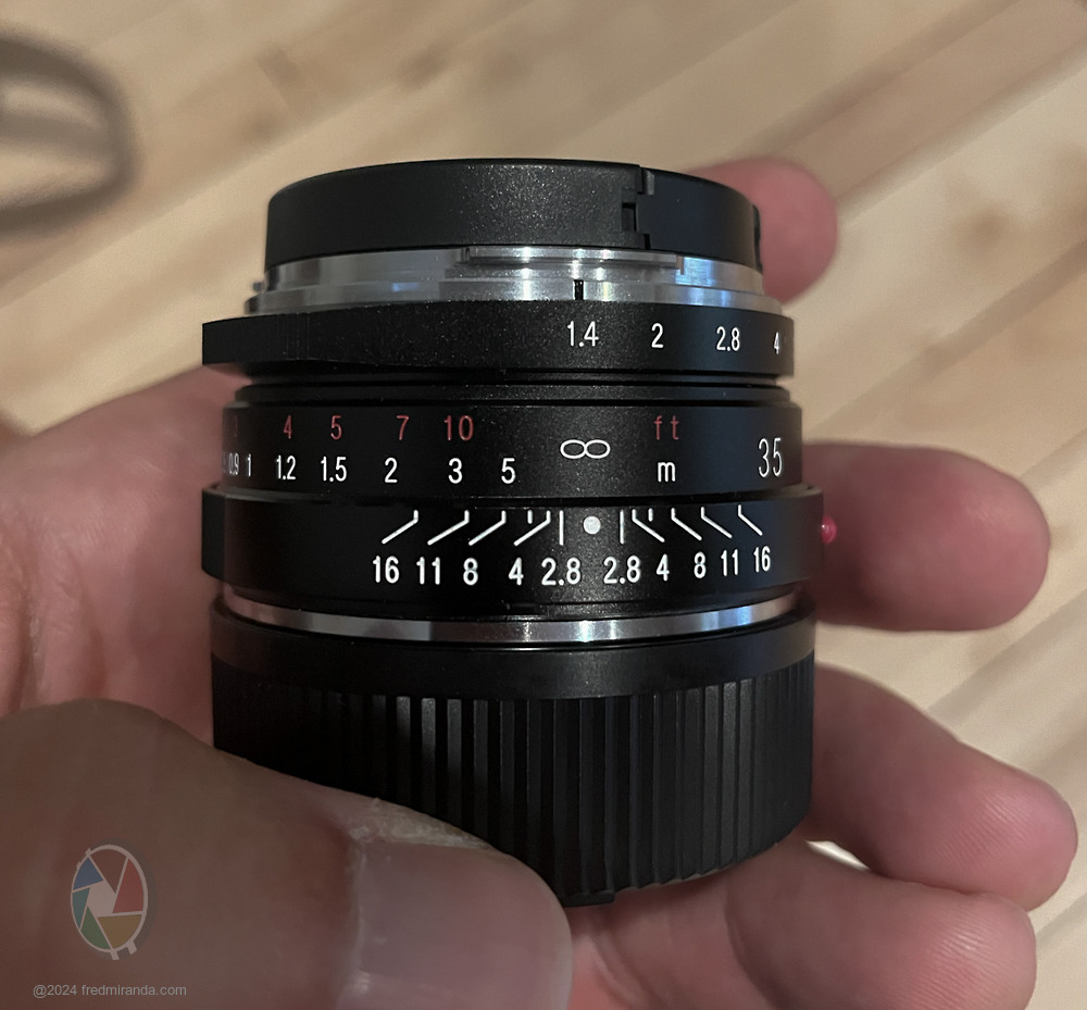

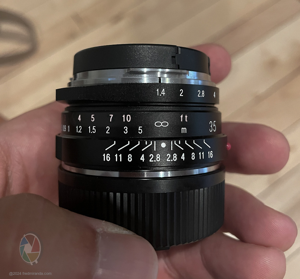

I’m considering changing the “red” engraving color on the 'feet' distance scale of my Voigtlander 35mm f/1.4 Nokton to yellow, orange, or white.
Yellow would align with the current Voigtlander Z-mount lenses, orange would be similar to what Leica uses, and white would resemble the color scheme Cosina offers for their Fuji X-mount lenses.
The primary goal is to enhance visibility, as I find the dark red hard to see in low light when reading the distance scale.
Which color do you prefer and why?
Here’s a simulation I created in Photoshop. The final colors might not be as vibrant as shown here, but this should give you an idea.
Original: Red
Yellow
Orange
White

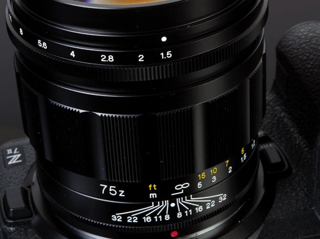

Here's a look at how all the Voigtlander Z-mount lenses are colored, using the 75/1.5 Nokton as an example:
Aug 05, 2024 at 06:14 PM

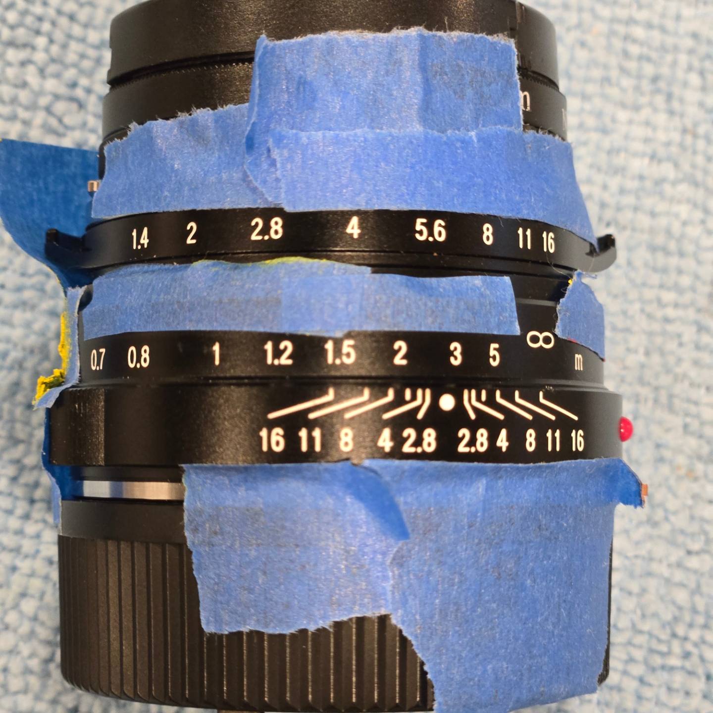

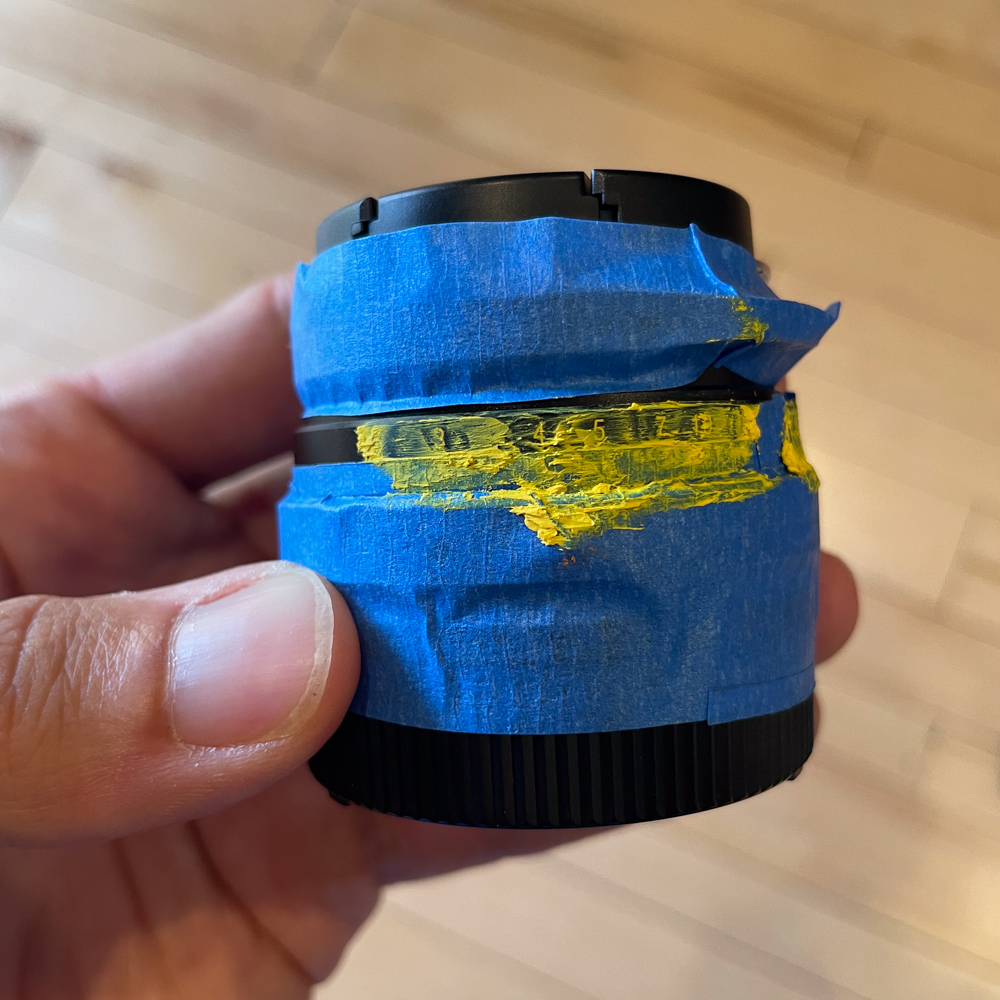

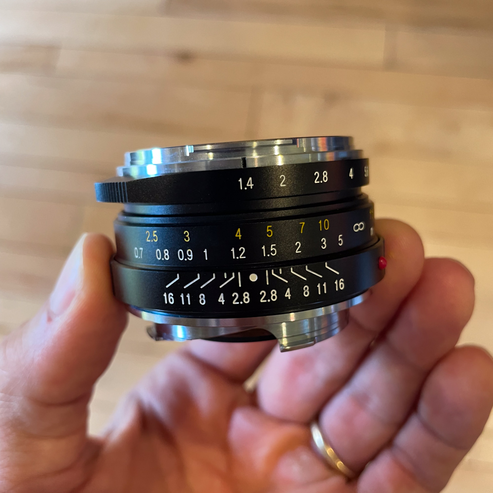

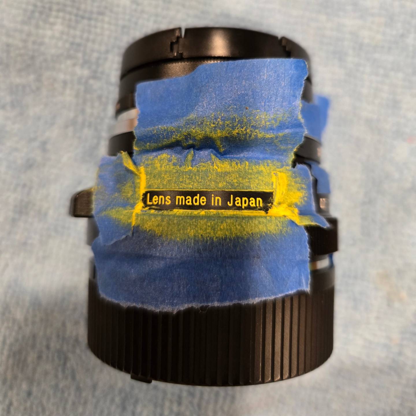

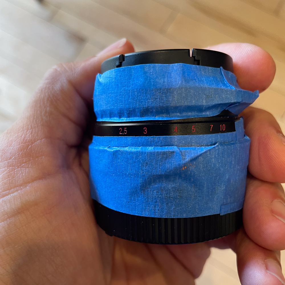

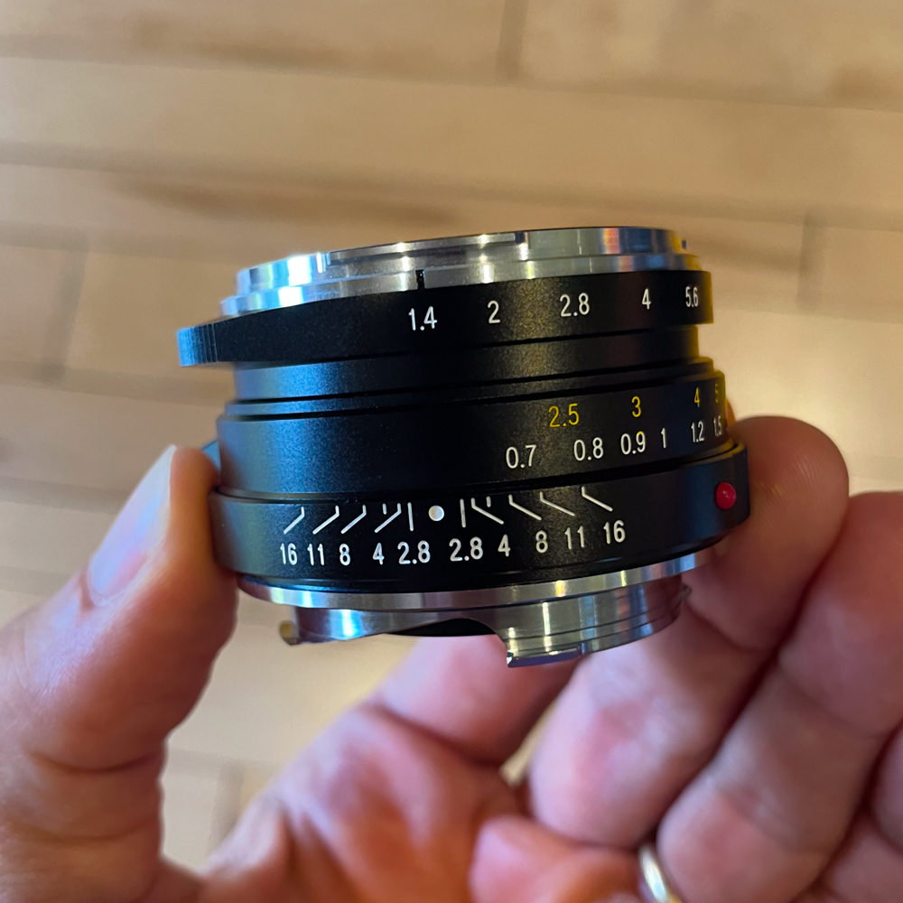

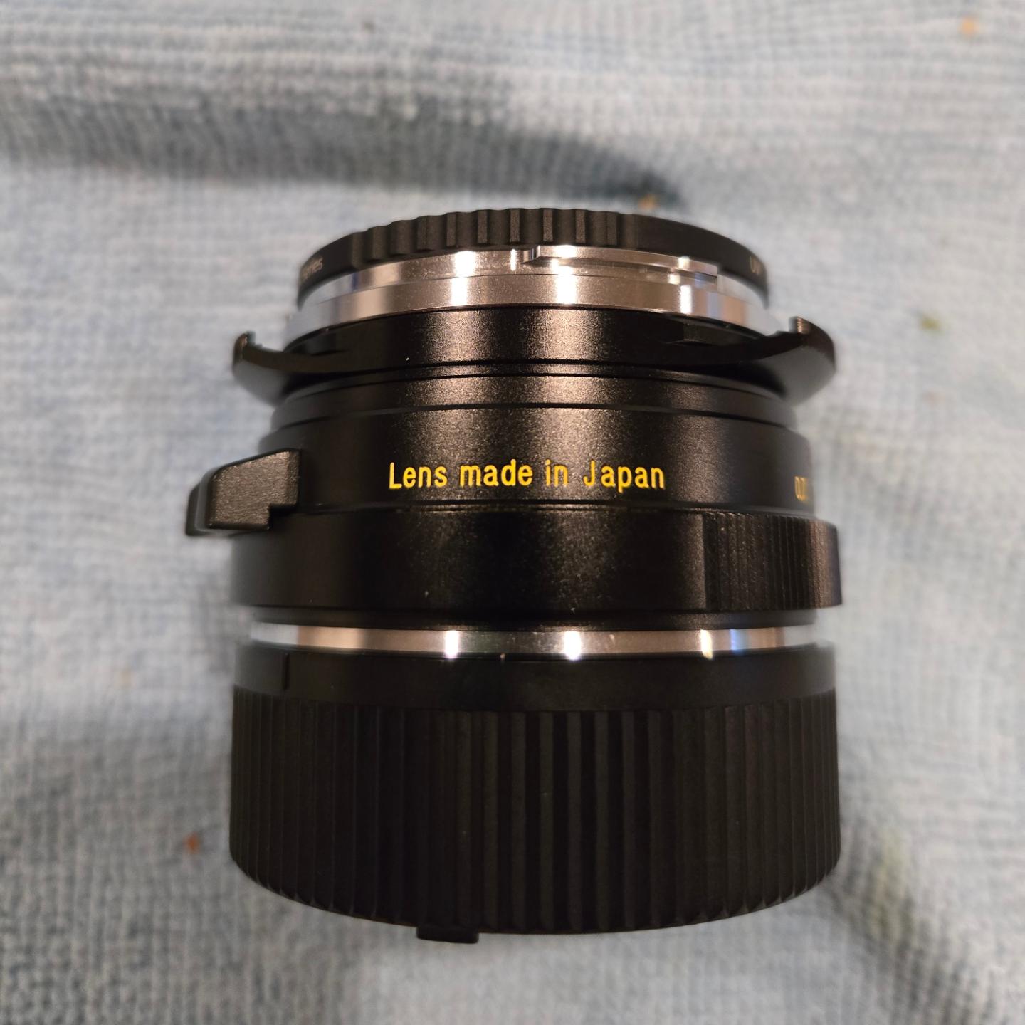

p.1 #7Voigtlander 35mm f/1.4 Nokton: Color Mod

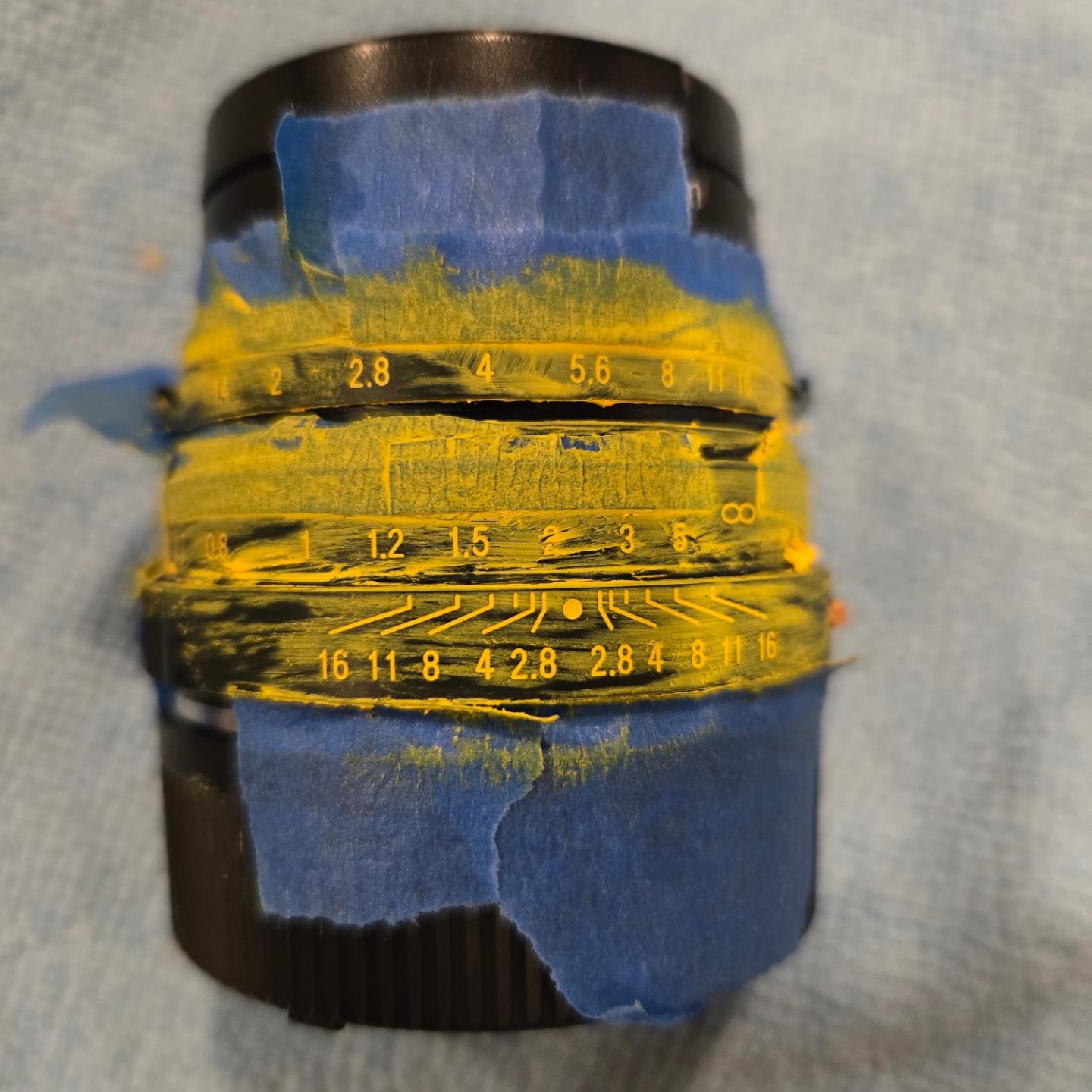

I decided to use yellow paint for the project, applying it with a Paint Stick from Markal. This is real paint and can only be removed with acetone once it's set.
There’s no need to remove the red paint first since there's sufficient space left in the engraving.
Here’s the process and the final result.
Blue tape is used to cover the white numbers to prevent any contamination.
Use the Paint Stick multiple times to ensure the engraving is fully filled with paint.
The result is very clean and easy to read, and I find it aesthetically pleasing as well!
Here's a look at the new 0.6m minimum focusing distance of my modified copy.
Aug 05, 2024 at 08:31 PM

p.1 #9Voigtlander 35mm f/1.4 Nokton: Color Mod
RoamingScott wrote:
Looks great!
The best part is that I can easily see the numbers even in low light!

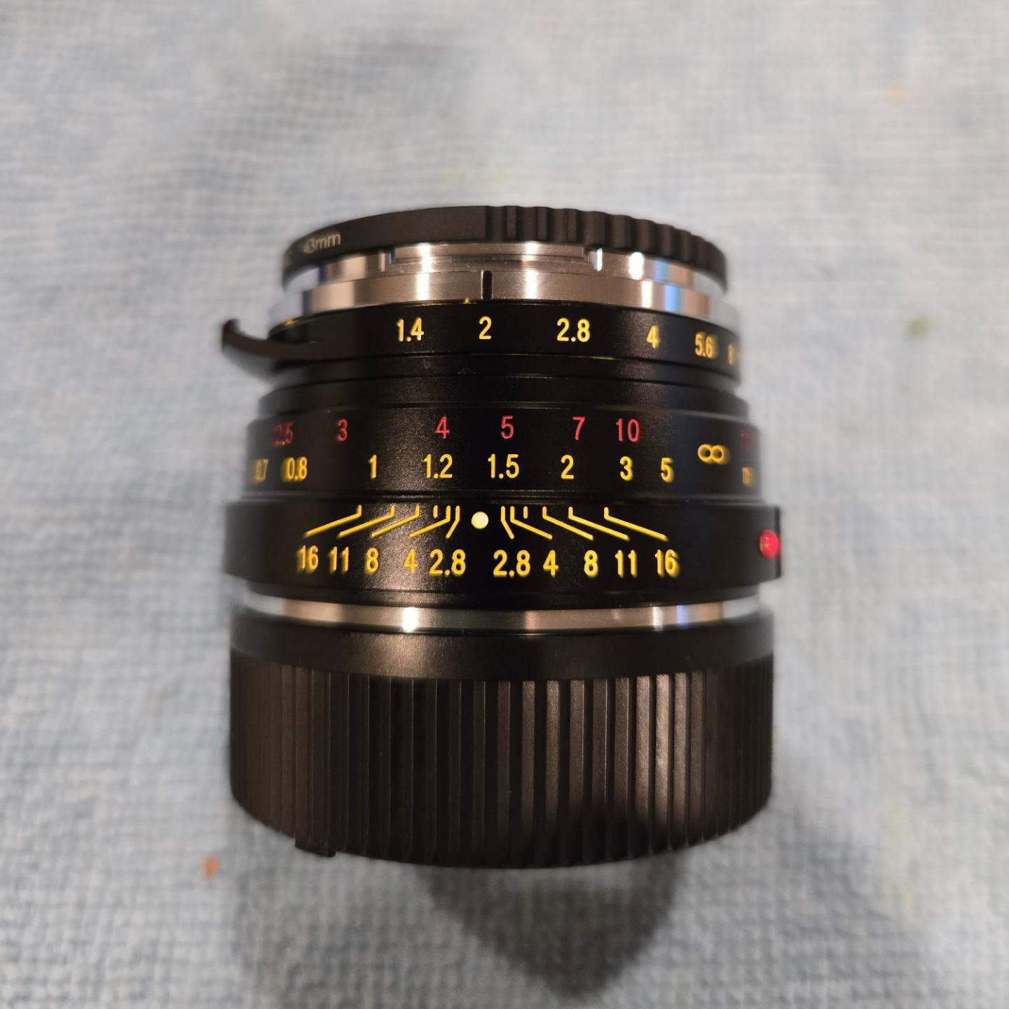

I'm a bit late to the party here, but I wanted to say I love the look of that old orange color on Minolta lens - those Rokkor-X labels.

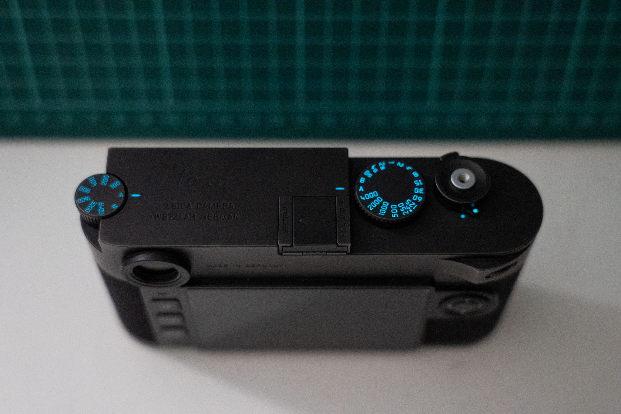

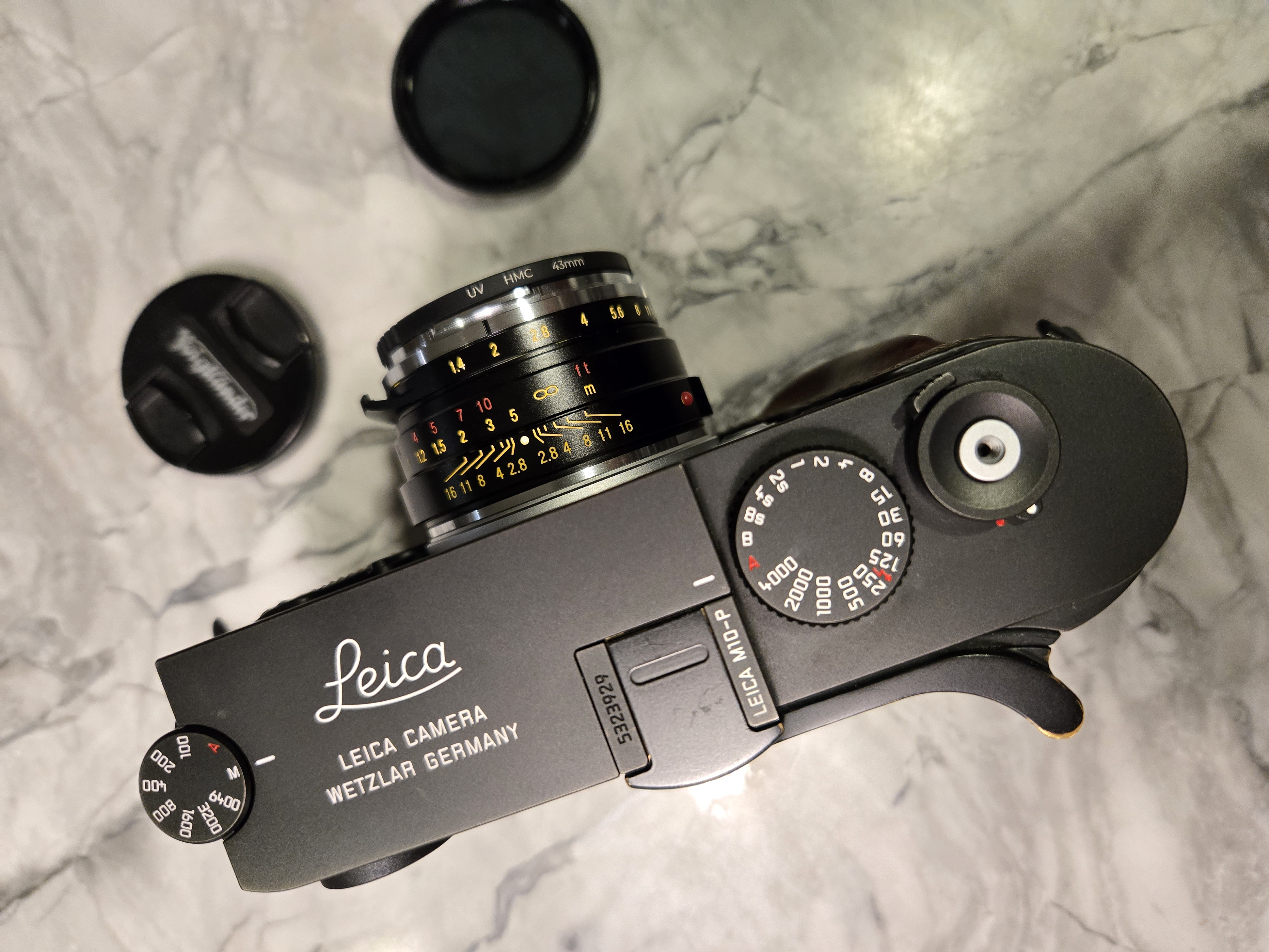

How about none of the above and paint with Super-LumiNova blue-white? Pics below I saw from someone that did this to an M10-P
https://www.keepthetime.com/blog/super-luminova/
