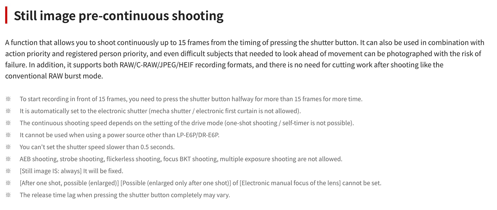

I translated the Canon Japan site about the R5II and it does confirm that PreCapture requires the P. I can't find a direct quote saying that 30FPS requires the P. Still searching....
My Canon R8 tiny LP-E17 batteries have not changed for a decade, but allow Pre-capture in R8.
