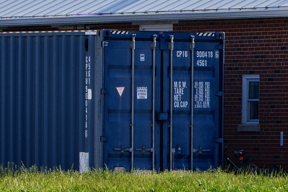

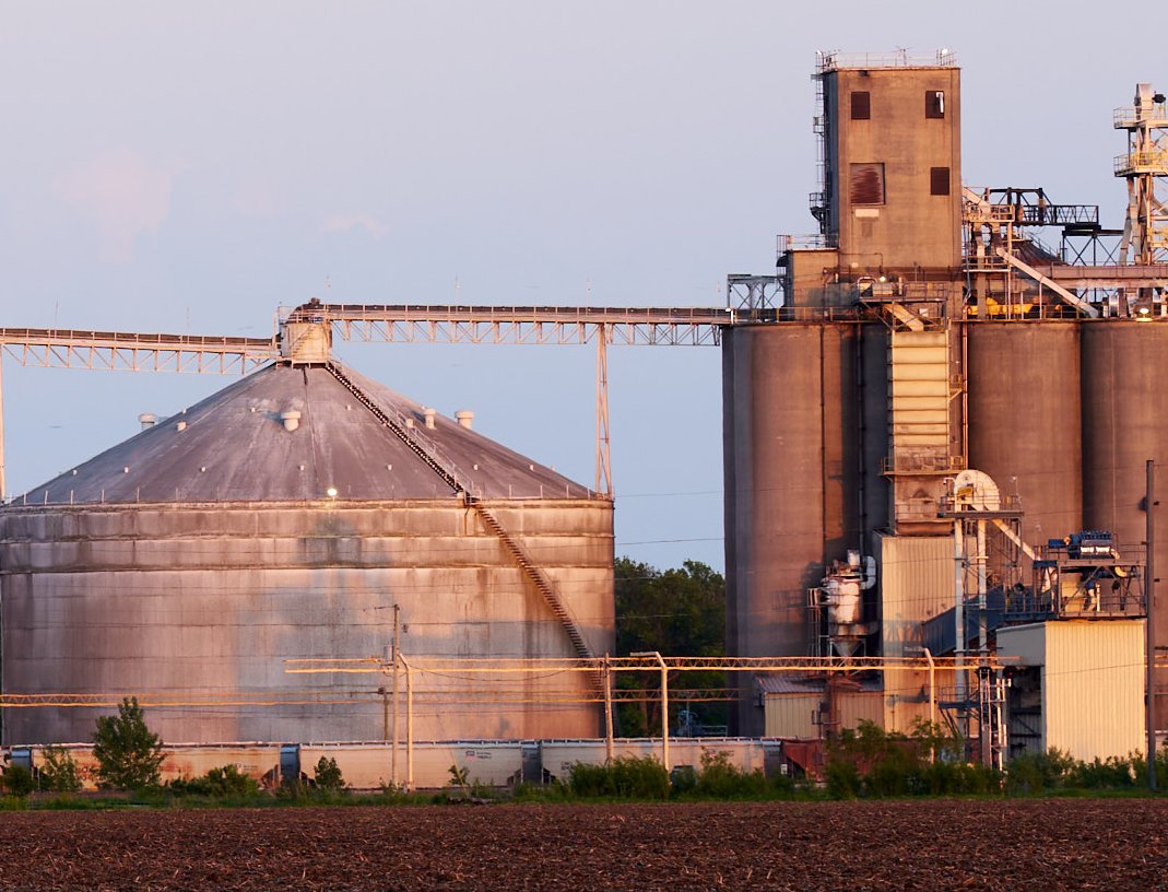

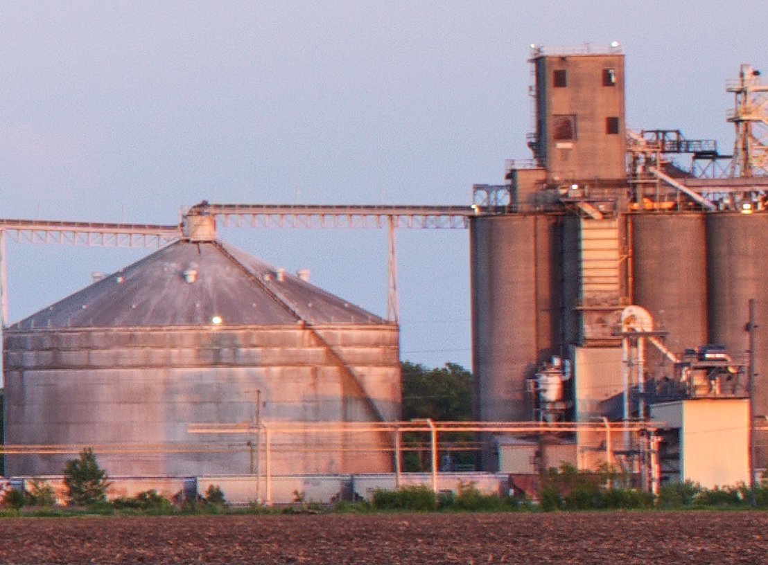

I ran out to get a few shots before sunset. I tried pixel shift with my 135GM and 35GM pointed at some grain bins. All shots were f/8 ISO 100 1/15s (close to sunset).
For 135GM the movement compensation was needed, pointless without that. There was some heat shimmer and a slight wind that moved some trees. The 4 photo image looked slightly better than the single, but not worth the effort. The 16 image looked softer than the 4 or single upscaled to 240MP.
For the 35GM the 16 image had the most detail. There were a few trees that clearly had more detail, but I'm not sure it was worth the effort. I think last time I tried pixel shift was with the Riv, it might have crashed my computer or if it worked I concluded the movement issues were a non-starter.
What I concluded from this exercise is if you want a higher resolution file you should grab a longer focal length and make a pano. I'm sure there are lots of real world issues that degraded the quality of my pixel shift. Wind was pretty light for IL but still present. The shutter speed was slow.
One of the variables I did not correct for on the pano was the f stop. the 35GM was shot at f/8 and the 135GM was shot at f/8. But to keep the same depth of field I would have had to adjust the f stop by the ratio of the focal lengths ie shoot the 135 at f/32. I wouldn't think shooting the 35GM at f/8 would cause diffraction problems, but maybe it did. Probably worth some additional experimentation tomorrow.
35GM upscaled to 240MP then 100% crop taken
35GM 240MP pixel shift then 100% crop
135GM pano then downsampled to same resolution as 240MP on 35GM

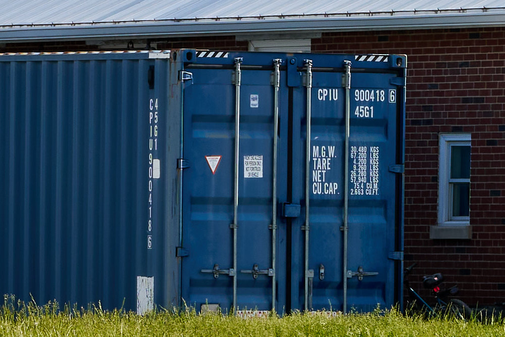

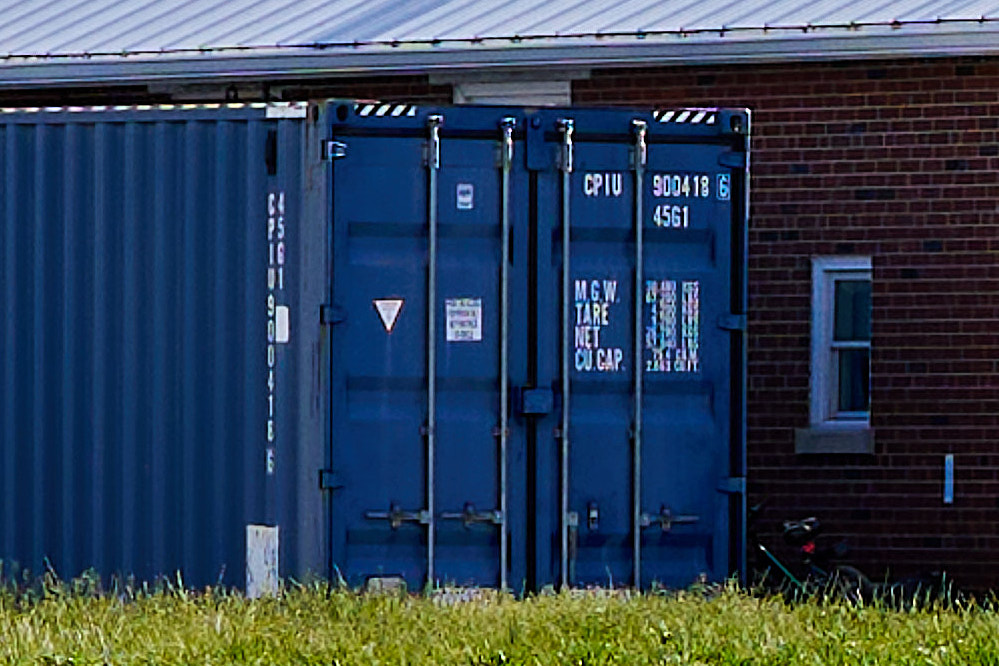

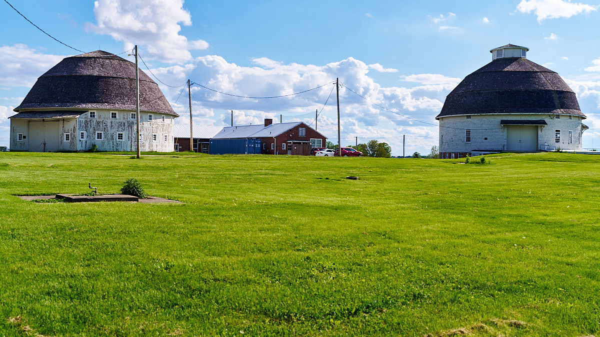

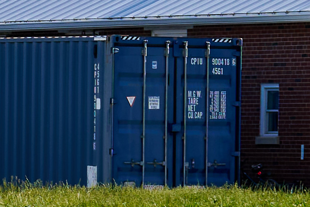

I had the chance to take some more pixel shift images and comparison pano images. I wanted to generate equivalent images that have the same field of view, depth of field, resolution, and diffraction. I used the 35GM for the pixel shift at f/4, one of the 16 images was used for an upscale, I used the 50/1.2 GM at f/5.6 to make a pano that was then upscaled and a Sigma 85DN at f/10 to make a pano that was then downscaled. Since the pixel shift doubles resolution that would be equivalent to shooting a normal image at 70mm assuming the 35GM has enough resolution and the pixel shift works as expected. I chose 50 and 85 to bracket on both sides of the 70mm. Since I did not take a multirow pano for the 85 it was cropped to a different aspect ratio.
I wanted real world images that will reveal real world challenges. Motion is the obvious challenge for pixel shift. The wind was below average for IL at 10 mph sustained, gusting to 15 mph. The tripod was as good as it gets for me, Leofoto LS-324CEX. The ground was good for pushing the spikes into. I'm sure many here have a more robust tripod, but it's what I have. Some parts of the image had movement like the vegetation, golf ball net behind the barns, and clouds. Some parts would be motionless like the barns and shipping container below. For the pano distortion was a challenge in choosing the right projection to match the 35 image.
Based on the last results I was a bit surprised the 35mm pixel shift out resolved the 50mm in motionless areas. There seemed to be some noise in the pixel shift image that doesn't make sense. The colors are a bit different in the pixel shift, I think this is from using imaging edge to develop the raw instead of capture one. Not surprisingly, the 85mm made the sharpest image.
This helped me to understand some of the tradeoffs. As Tim pointed out it's pretty easy to get a pixel shift in addition to a regular if you want, and a bit of storage is the only downside.
I have included a link to download the 200+MP images for review.
https://drive.google.com/drive/folders/1Duke7lH87-roLUmqyzUlnyvbeD4vFOqk?usp=drive_link
Barns at UIUC used for images
  ILCE-7RM5    Sony FE 35mm F1.4 GM (SEL35F14GM) lens    35mm    f/4.0    1/1250s    100 ISO    +0.3 EV
100% crop of 35GM upscaled
100% crop of 50GM pano upscaled
100% crop of 35GM pixel shift
100% crop of 85 pano downscaled
May 11, 2024 at 02:09 PM
