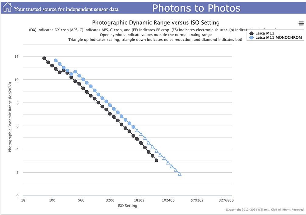

Photonstophotos has just released the Photographic Dynamic Range data for the Leica M11 Monochrome. This data confirms what was already expected: there's an improvement of nearly one stop in dynamic range compared to the regular M11 camera.
However, according to Photonstophotos measurements, it's noteworthy that the lowest ISO setting of the bayer filtered sensor M11, ISO 64, outperforms the minimum ISO setting of the M11 Monochrome, which is 125. Also there is not much difference in DR from ISO 200 until about 320.
https://www.photonstophotos.net/Charts/PDR.htm#Leica%20M11,Leica%20M11%20MONOCHROM
Apr 15, 2024 at 01:25 PM
flash
p.1 #2 · Leica M11 Monochrome Dynamic Range
No it doesn't. There's gobs more detail available for recovery in the M11M. Even at low ISO's. I suppose that when you downscale everything the 8MP they all look about the same.
Just another chart that doesn't correspond to real life usage.
Gordon
Apr 15, 2024 at 03:41 PM
mark1958

I compared M10-R and M10-M files side by side at various ISO settings and observed around a 1-stop improvement for the monochrome version, although this varied slightly depending on the ISO setting. My hands-on experience with real-world files supports the findings above, but I haven't yet compared the M11 to the M11-M directly.
Clearly, there is an advantage to removing the Bayer filtering, but I believe it may have been exaggerated by some reviewers.
Apr 15, 2024 at 04:22 PM
The biggest thing overlooked is most of us shooting the monochrome cameras are also using color filters. Depending on the filter, it can either completely remove any DR advantage or put the monochrome at a several stop disadvantage. So for me, the big advantage to the monochrome sensor comes when shooting without color filters in situations where high ISO is needed. Worth noting that when photon count is extremely low, the noise character of the monochrome is nicer even if the DR/ISO advantage is technically cancelled out by using color filters.

Remove RGB filter will increase light/photon pass to the sensor. in theory, this will increase DR assume M11 and M11M share the same read noise.
However, M11 ISO64 vs M11M ISO125 means M11M can't take advantage of increased signal level at low ISO. Put it in another way, without RGB, M11M have more signal pass through. However, ISO64 of M11 means it can take one stop extra light/signal to offset its RGB filter loss. Hence we see similar DR for both which make sense.
At low light condition, (high ISO). Less signal loss due to no RGB filter clearly show M11M advantage. Due to less light loss, the exposure time can be reduced for M11M, read noise will be reduced so that M11M have about 1 stop DR benefit.
Having said that, I feel M11M benefit is more to the pixel level fidelity (if you pixel PP) than DR as I feel modern cameras's DR are really good enough for a while now.

ISO is a representation of apparent brightness, it is not a setting of the sensor.
As you can see the sixth gain setting has a DR jump on both cameras as the sensor switches to its other gain mode.
There is no such thing as increased signal due to gain setting. If a sensor records more photons at base iso (compared to another at base iso) it has a higher quantum efficiency and thus higher signal to noise ratio if the noise produced by both sensors is identical. If the noise introduced by equivalent gain is less then the snr is likewise higher. ISO 125 on the M11M is the exact same gain setting on the IMX455 as ISO 64 on the M11.
At ISO3200 (for example) both cameras will produce an image of similar brightness, but the M11M is effectively using a lower gain mode due to higher quantum efficiency from removal of the CFA.
The reason the exact same gain setting on the M11M produces less DR than on the M11 is because of minor benefits to noise introduced by Bayer interpolation.
The reason the M11 is so close to the M11M at ISO200-320 is because of the coincidental overlap of the best SNR of second gain mode on the M11 with the worst of the first gain mode on the M11M. This is pretty clear on the graph.

Dynamic range goes from saturation (white) to floor (pure noise). For a CFA camera to max out dynamic range, each color must be equally bright -- like when shooting a clouds or a gray card, assuming each color filter is equally dense. But, if any color exists in the image, it means that one or two channels are meaningfully dimmer than the other(s). The noise in those parts of the image will be higher than the technical optimum. In contrast, monochrome sensors have the same noise level regardless of color, depending only on amount of light captured. So, recovering shadows on a red subject will have a substantial advantage for the monochrome sensor because the blue and both green pixels in the color camera will be dramatically underexposed and thus have higher noise. Of course, the CFA camera has the advantage of being able to render that subject in red.
+1
RGBG ... with 1/4 at R, 1/4 at B, 2/4 (1/2) at G.
Thus, for a pure red or pure blue ... only 1/4 signal vs. monochrome at 4/4 of reflected light being captured. Two stops. Same for blue.
Whereas green would be 2/4 (1/2) or one stop.
Actual colors aren't usually pure, so it'll be portions of each, but that's the base / root relationship(s), AIUI.
