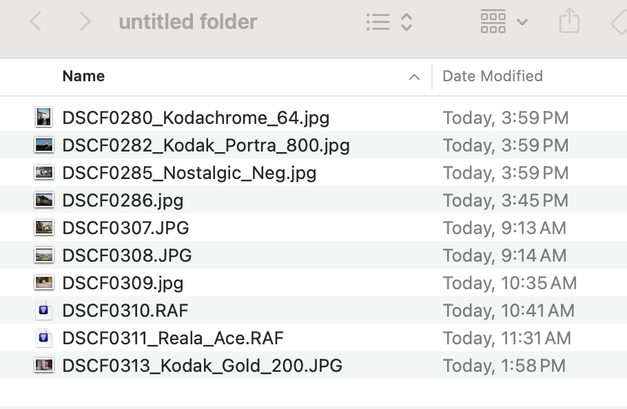

Fred, another great feature of exiftool is its ability to rename files based on the metadata. I use this feature all the time when ingesting images for a lot of my camera tests, for example adding the shutter speed, ISO, aperture, etc.. to the filenames to make it easy to evaluate which images are what.
Here's a recipe that will add the film mode to the end of a Fuji image filename:
exiftool -q "-FileName<%f_${FilmMode;$_=~s/W//g}.%e"
This will turn "DSCF0640.jpg" into "DSCF0640_ClassicChrome.jpg".
The "~s/W//g" removes any non-alphanumeric characters including spaces, which is my personal preference for filenames.
exiftool also supports conditional logic, which you could use to solve the camera not putting the name of the custom settings into the EXIF (ie, use a matching set of EXIF values to inject a new EXIF tag into your file to include a name for your custom settings).
Note for Windows users - if you put this in a batch file you'll need to use two %% instead of % for the %f and %e

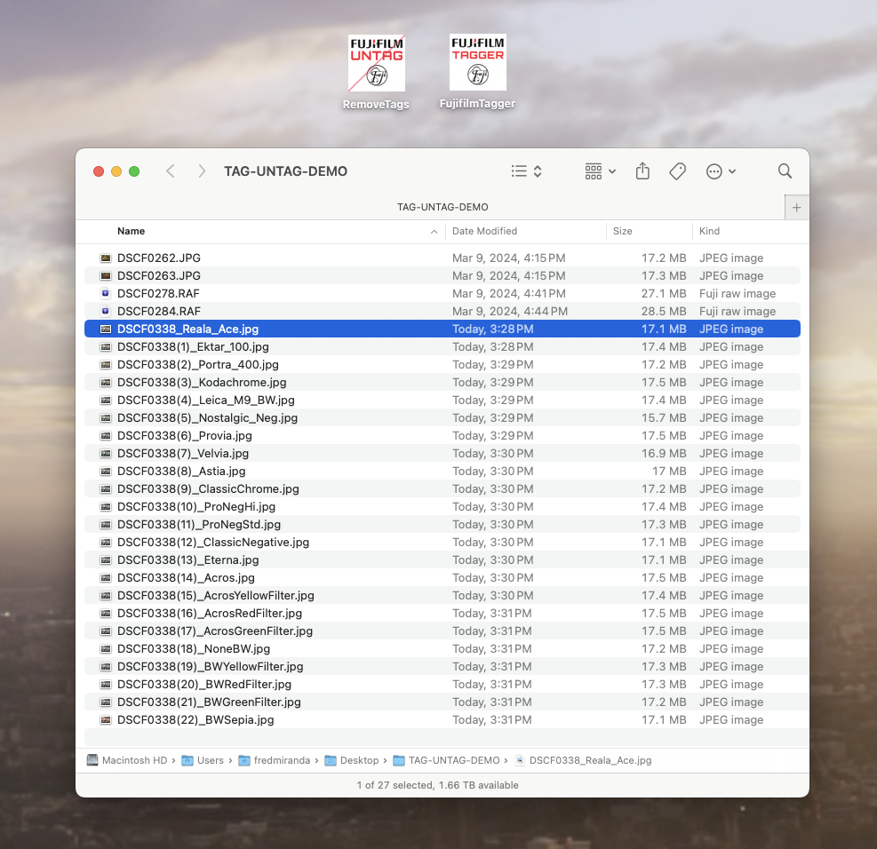

Very interesting Adam. I may start doing this in a batch for my jpg files!
Earlier quoteexiftool also supports conditional logic, which you could use to solve the camera not putting the name of the custom settings into the EXIF (ie, use a matching set of EXIF values to inject a new EXIF tag into your file to include a name for your custom settings).
That's even better. Could you share the code to accomplish this? Thanks in advance.
Sure Fred, here's a basic example that will add "FredLandscapeRecipe" if the image has a specific film mode and grain effect size:
exiftool "-FileName=%f_FredLandscapeRecipe.%e" -if "$FilmMode eq 'ClassicChrome' and $GrainEffectSize eq 'Small'"
Thank you. I've tried this but I'm getting: 1 files failed condition
My JPG file has ClassicChrome and GrainEffectSize Small. I believe it should overwrite FileName to "FredLandscapeRecipe" but I get that error and nothing happens..

That error means your IF condition isn't matching (btw you can suppress that message in the future via -q). Check to make sure the text exactly matches, including case. If you still can't get it then PM me the file and your command line and I'll have a look.

Today, I created a tool using shell scripting (.sh) to make renaming images easier. Whether you have one image or many in a folder, this tool can add the name of the Custom Setting (recipe) used as a tag. It might seem complicated to some, but it worked well for me, so I thought I'd share in case others want to give it a try. It's helpful to have the Custom Setting (recipe) added to the file name.
Custom Recipe Renaming Tool
This tool scans each image file (in formats like JPG, RAF, or HEIC) to identify a unique Color Temperature measured in Kelvins. It then checks if the image was taken using a specific Custom Setting. If it finds a match, it adds the name of that Custom Setting to the filename. If not, it leaves the filename unchanged.
What it Does:
It renames image files by appending the name of the Custom Setting used to capture the image. I depend on two specific white balance temperatures measured in Kelvins: one for outdoors in the 5200 range and the other for indoors in the 3200 range.
How it Works:
Each of my custom settings has a slightly different Kelvin temperature associated with it. For example:
REALA ACE: 5360 or 3360
EKTAR 100: 5350 or 3350
PORTRA 400: 5340 or 3340
Kodachrome: 5330 or 3330
LEICA M9 BW: 5320 or 3320
Nostalgic Neg: 5310 or 3310
FUJIFILM Sim: 5300 or 3330
By aligning these Kelvin temperatures with my custom settings, the script can discern which custom setting was applied to each image. The slight variations in Kelvin have minimal impact on the images as they will see be "Daylight" or "Tungsten", making it a creative approach to associating the Custom Setting name, especially since it's not included in the EXIF data.
To switch to indoor conditions, I manually activate a custom button, so I can change from 5360 to 3360 very quickly in the case of using the Reala Ace sim.
How to Use:
Download, uncompress and save the script file to your computer.
https://www.fredmiranda.com/Buzz/recipe.sh.zip
Open Terminal (or the command prompt on PC) and navigate to the folder containing your image files.
Run the script by typing the following command:
/path/to/recipe.sh /path/to/image_folder
Replace /path/to/recipe.sh with the actual path to the script file, and /path/to/image_folder with the path to the folder containing your image files.
Example:
Suppose the script file is on your desktop and you want to rename files in a folder named "photos". The command would look like this:
/Users/your_username/Desktop/recipe.sh /Users/your_username/photos
That's It!
Once you run the script, it will automatically rename your image files based on the custom settings linked to their Kelvin temperatures. It's a simple yet powerful way to organize and manage your photos!
It's helpful to add White Balance to a custom button on your camera. This way you can easily change the WB from the outdoor setting to the indoor setting. Just make sure to add the correspondent number to it. For example, if you are shooting indoor with Kodachrome custom setting remember to change the Kelvin setting from 5330 to 3330. (just change the 5 number to 3, it's easy with the custom button)
Of course the shell script can be modified with your own Custom setting names.
Here is a screenshot showing how the tool added the custom name to the files with the correct Kelvin settings and ignore those without it.

I converted this into a Mac app today, eliminating the need to use Terminal for command lines.
Now, I can simply drag one file, multiple files, or an entire folder to the FujifilmTagger app, and the custom settings or Fujifilm simulations will be applied to the files. I also added another feature that removes the custom tags from the files, which also works by just dragging the file(s) or folder to the app. This functionality is compatible with any file type. Files can only be tagged once, and images that do not conform to the "Color Temperature" values layout mentioned in my previous post remain unaffected.
If you're interested in trying out these apps, feel free to let me know via private message. 👍
Below is a screenshot displaying several files tagged by the app. The first four files didn't have the correct white balance (WB), so they weren't processed. However, the rest followed my Color Temperature scheme and were successfully tagged.
Mar 17, 2024 at 04:57 PM
