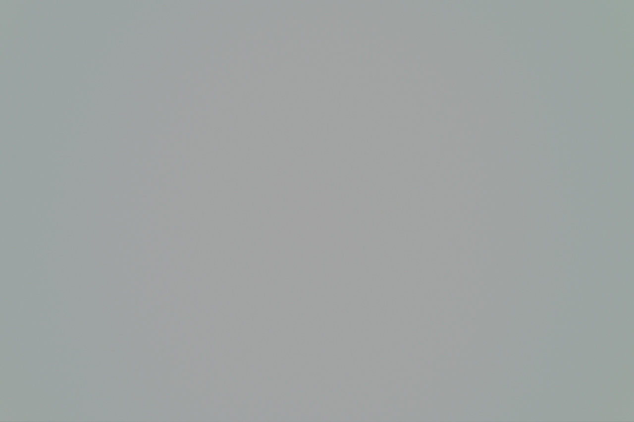

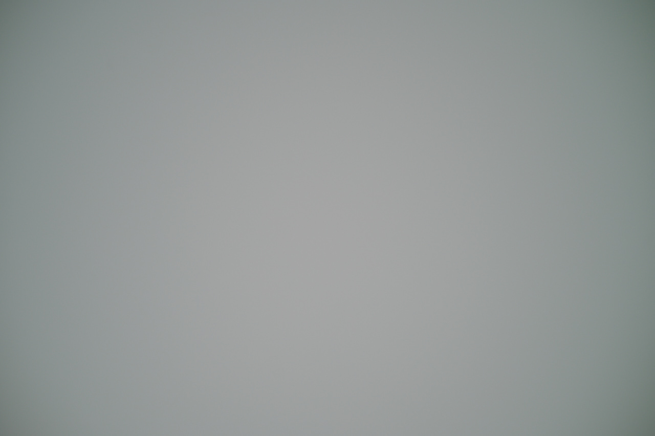

As long as there is no spatial degradation of the image (such as astigmatism), i.e. only color shift towards the periphery, you can use Lens Cast Calibration (LCC) files.
© AcuteShadows 2023
Lens color cast and vignetting of the Leica Summarit f/2.4 lens on the Nikon Z 6 at f/4 and focus at infinity.
Lens color cast (without vignette) of the Leica Summarit f/2.4 lens on the Nikon Z 6 at f/4 and focus at infinity.
