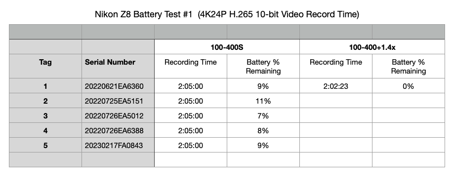

Anyway, I have now ruled out the batteries as being the root cause, nor is it the camera body, at least as far as running it in basic video mode one a tripod goes. Now I have to see if it's a particular lens or lens + TC combination...

That (resetting to defaults) may have done the trick - there is no firmware update for the Z8 yet.
I guess now I have to go back and re-do all my custom settings to see if battery life goes south again...
I did notice from these tests that having the 1.4x TC attached decreased battery life by roughly 10%

Turns out it was a "known issue" after all... which Nikon has now fixed with a firmware update:
https://www.fredmiranda.com/forum/topic/1821924
