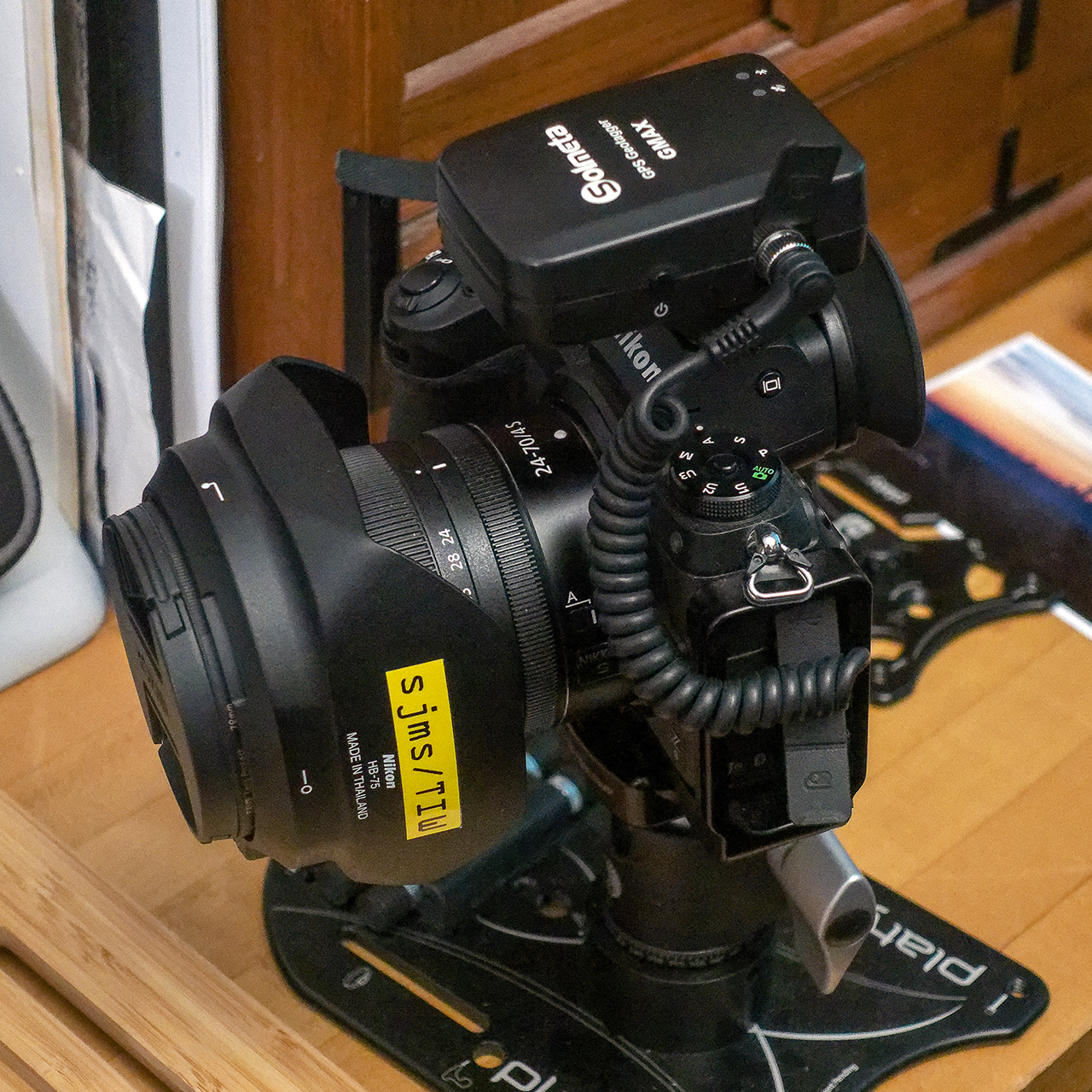

i use the Solmeta GMax for my D500 and Z6. there are modular cables the 2 styles of input to match the cameras.
https://www.solmeta.com/Index/index
there is also the Dawntech product
https://dawntech.co.uk/shop/
my Z9 has a minimalist GPS built in.

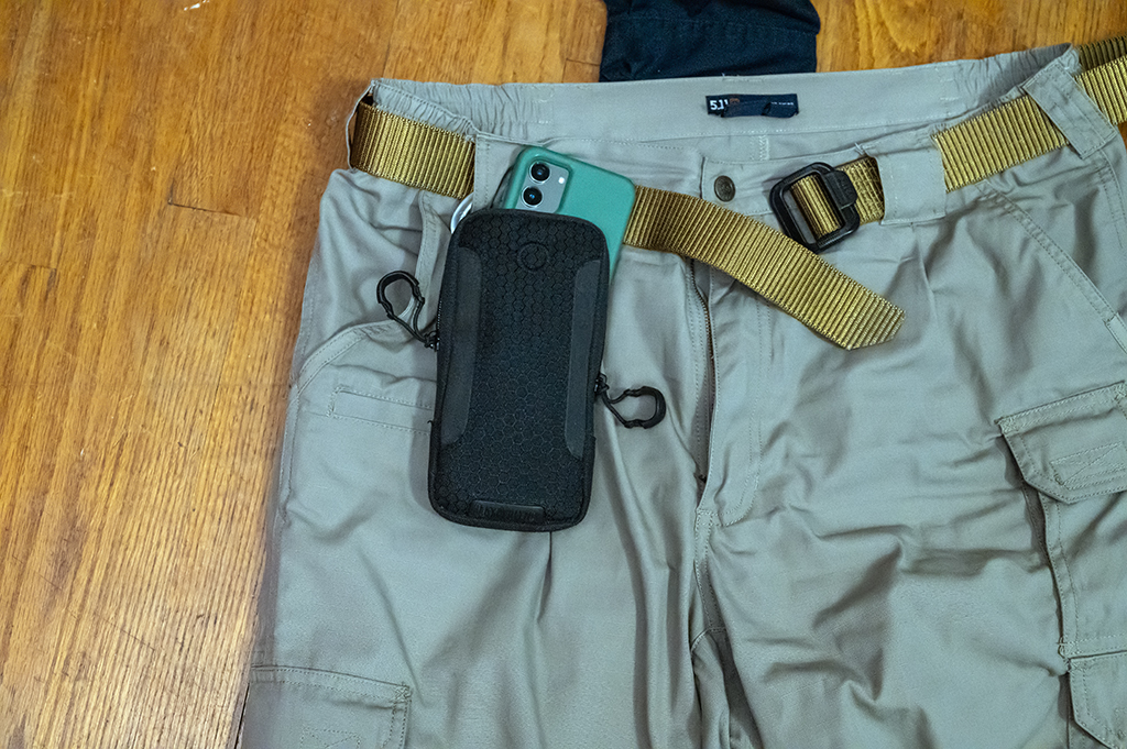

Over the years I have tried various gadgets including Solmeta, and while they worked I did find them annoying being attached to the camera. These days I find Snapbridge does all I need. If I'm going to be out for several hours or in remote locations I will throw in a Garmin GLO 2 GPS receiver into my pocket. This also connects to my phone via bluetooth but does the hard yards for GPS.

At least for my needs the solmeta has done the job. And like you all I have run the gumat of products too. I guess I have a higher tolerance adsit sits up topside and does the job that I needed it for. Easily works on multiple camera bodies. Yes, I do prefer hard wired setups.
Jun 27, 2023 at 12:01 AM

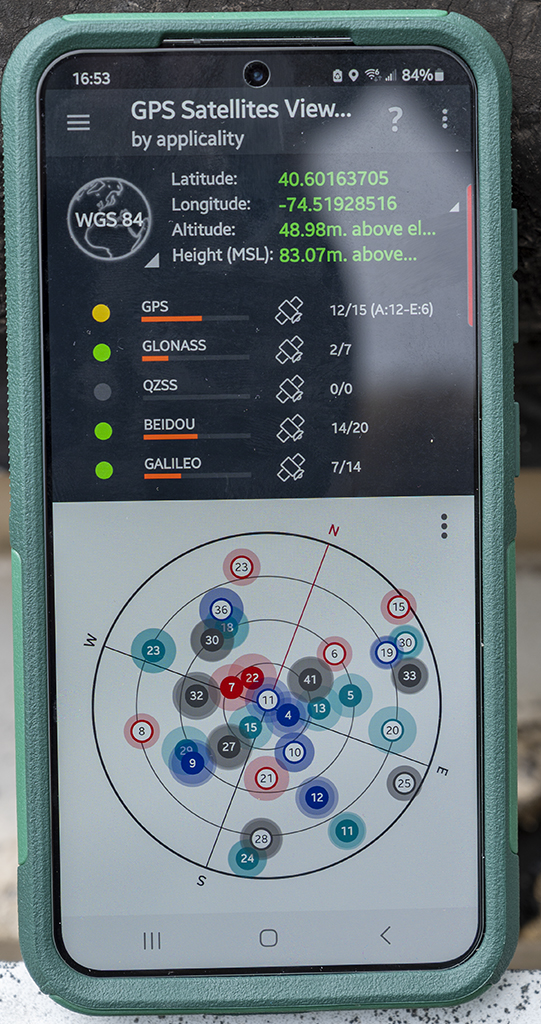

GPS or as it is known today as GNSS is a constellation of sats that provide signals that GPS/GNSS receivers can decode to calculate their exact location. that signal is constant. there is no GPS provider other than the US Govt (there are other systems of different freqs and usable locations). minimum 4 GPS sats to get a precision location. the chip in your device does the all the math (kalman filtering). the more strong signals your receiver can capture the more precise your position can become. there are variables that can throw off that precision.
US: Navstar US Govt USAF (Z9 supported)
Russia: Glonass (Z9 supported and various gps supported)
QZSS: Japan (Z9 supported)**
China: Beidou (solmeta supported)
EU: Galileo
the availability/usability of these systems will vary by location and the receivers.
the availability of said systems constellations varies considerably.
reading taken from my backyard.
** https://en.wikipedia.org/wiki/Quasi-Zenith_Satellite_System
