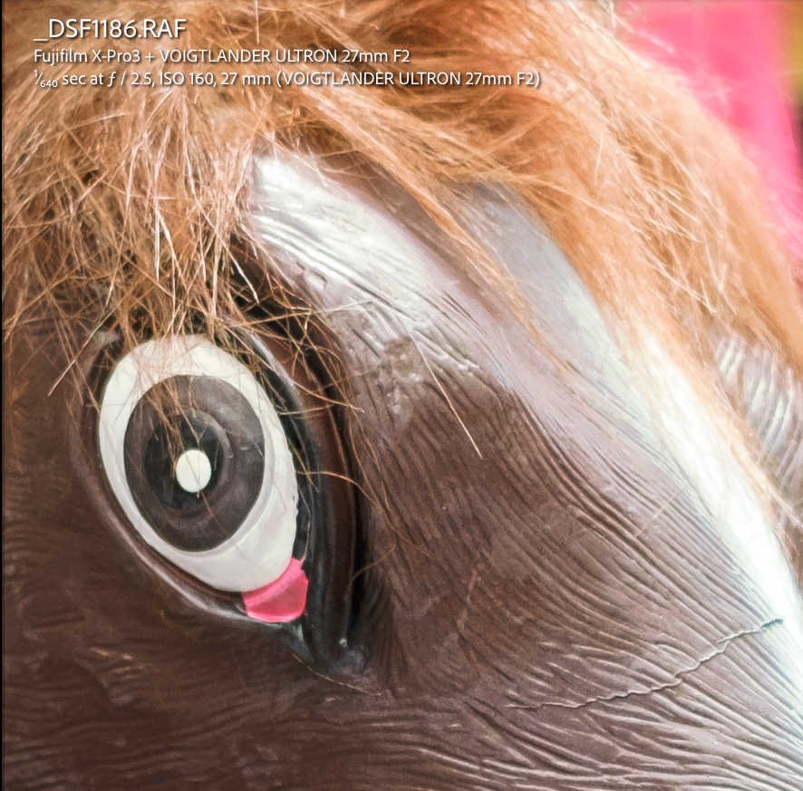

If this bug exist in both X-T5 and X-T50 I'm 100% sure it will occur on my X-H2 also.
Crap 😑
I will wait, untill Fujifilm (or Cosina) will release firmware with this bug fix.
It's rally shame, as this lens is exclusive for Fuji X mount - so it could attract more people to jump into Fuji X to have this very veristle lens, but You pay premium price for this CV 27/2 mainly for premium features, like full exif data recorded to file, superb build quality, fantastic rendering.
*edit*
Bug in exif data info from lens, where You pay among other premium features - for having aperture value recorded into file, is like.. "Made in China" behavior.

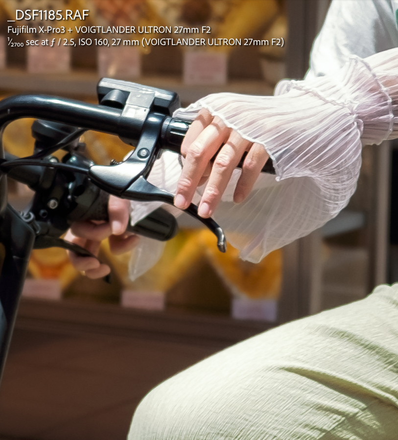

Fuji made changes in the latest firmware for the "newer" cameras. I can confirm this issue does not occur on the X-T30 II, X-E4, or X-Pro3. It would be helpful to inform Fujifilm so they can address it in a future firmware update.
In any case, I’ve already notified Cosina about this. Hopefully, they can reach out to Fuji and collaborate on a solution.

I think the issue started to be reported after a firmware update Fujifilm released around May 2024 for their current latest cameras at the time. It never happens on older cameras that didn't receive that or newer firmware updates. My X-S10 is one of those unaffected cameras.
I don't think the lenses can have their firmware updated by users and Cosina hasn't ever released any user-installable firmware updates for their mirrorless lenses. I suppose they could update the firmware back at the factory but it would seem far easier for Fujifilm to do something to revert the problem.

Guys, I found a temporary solution for wrong aperture value data recorded to exif data from CV 27/2 lens.
This freeware software allows You to edit exif data just by click:
https://www.colorpilot.com/exif.html
Even though this solution requires another step in editing, I think this lens is worth it
Anyways fingers crossed for Fuji so they will fix this bug in another firmware update..

I think exiftool (https://exiftool.org/) would also allow batch processing of files, changing any particular EXIF data as per given parameters with suitable commands. When C1 Pro was slow to bring A7CII support, I did batch processing of my Sony RAW files to change camera model from A7CII to A7IV in EXIF, and it worked well. I'm not sure which specific fields would need to be changed in this case and don't have a suitable command at hand but I think it would probably be another suitable option.

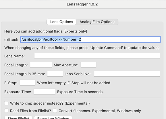

I can confirm this issue also occurs with the X-T50 body and the CV 27/2 X-mount. Fujifilm made changes in their latest firmware that conflict with Cosina's previous lens firmware code.
For those using "Lens Tagger", it’s easy to change f/22 to f/2. Simply open Lens Tagger and add -FNumber=2 to the top field:

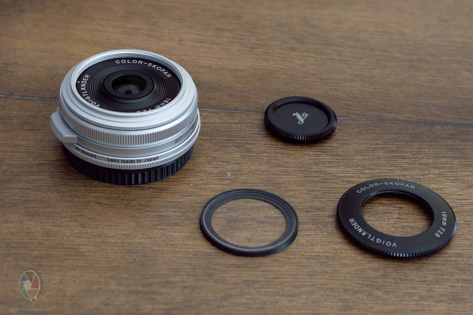

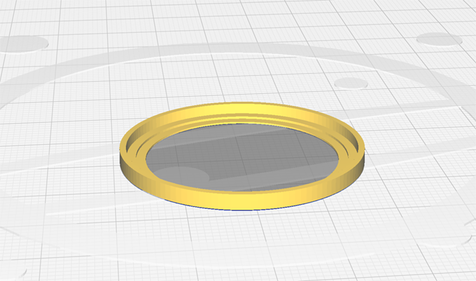

p.9 #13Voigtlander 27mm f/2 Ultron X-mount Review
Fred Miranda wrote:
Here are some images showing the filter adapter for the Voigtlander 18mm f/2.8 and CV 27mm f/2 Ultron lenses. You can remove the filter from either a B+W UV filter, 39mm or 43mm. Surprisingly, they have the exact same size glass!
You can print the adapter from this STL file:
[broken link]
I just purchased the 18mm lens based on reviews and comments on this site, and was hoping someone could point me to download link to the STL file for this UV lens adapter (this link appears to be broken).
Really appreciate any help in advance.
Thanks!
Sep 04, 2026 at 12:45 PM
