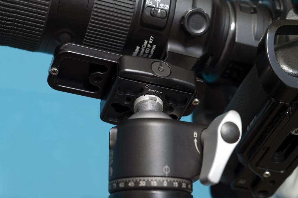

I own an Arca Swiss Monoball that I used on a Gitzo series-3 tripod. Me too had to return to warranty because it locked up. In cold weather I had no problem though. I do not use it anymore.
At present, I use a Sunwayphoto FB-44 II (on Gitzo series-2 tripod). Excellent quality-to-price ratio. I haven't used it in cold weather yet.
