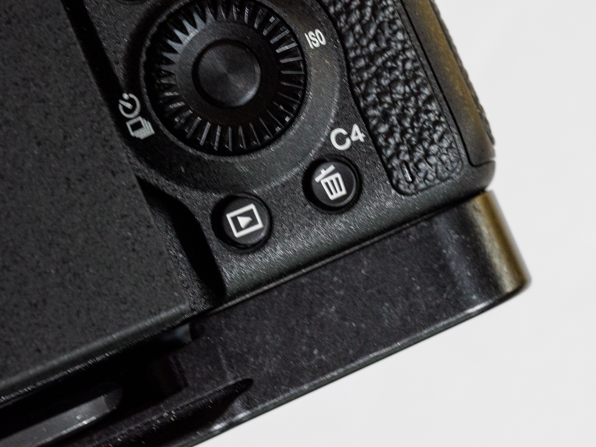

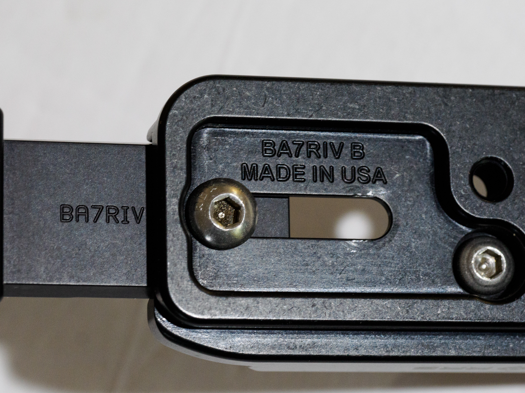

I just tested my RRS ultralight L-Bracket from my A7RIVa on my A7RV (which just arrived) and it fits perfectly. I have almost full movement on the screen (totally full movement if I pull the screen out a tiny bit from the body) and everything is tight.
The only issue is that the doors to ports are hard to reach. I just loosen and pull the bracket out a bit and reach them that way. For me, this would be a rare situation anyway (hooking up a remote cable release, or powering the camera with a battery bank while doing astro are the only cases I can think of where I'd need to access the ports while the L-Bracket was attached).

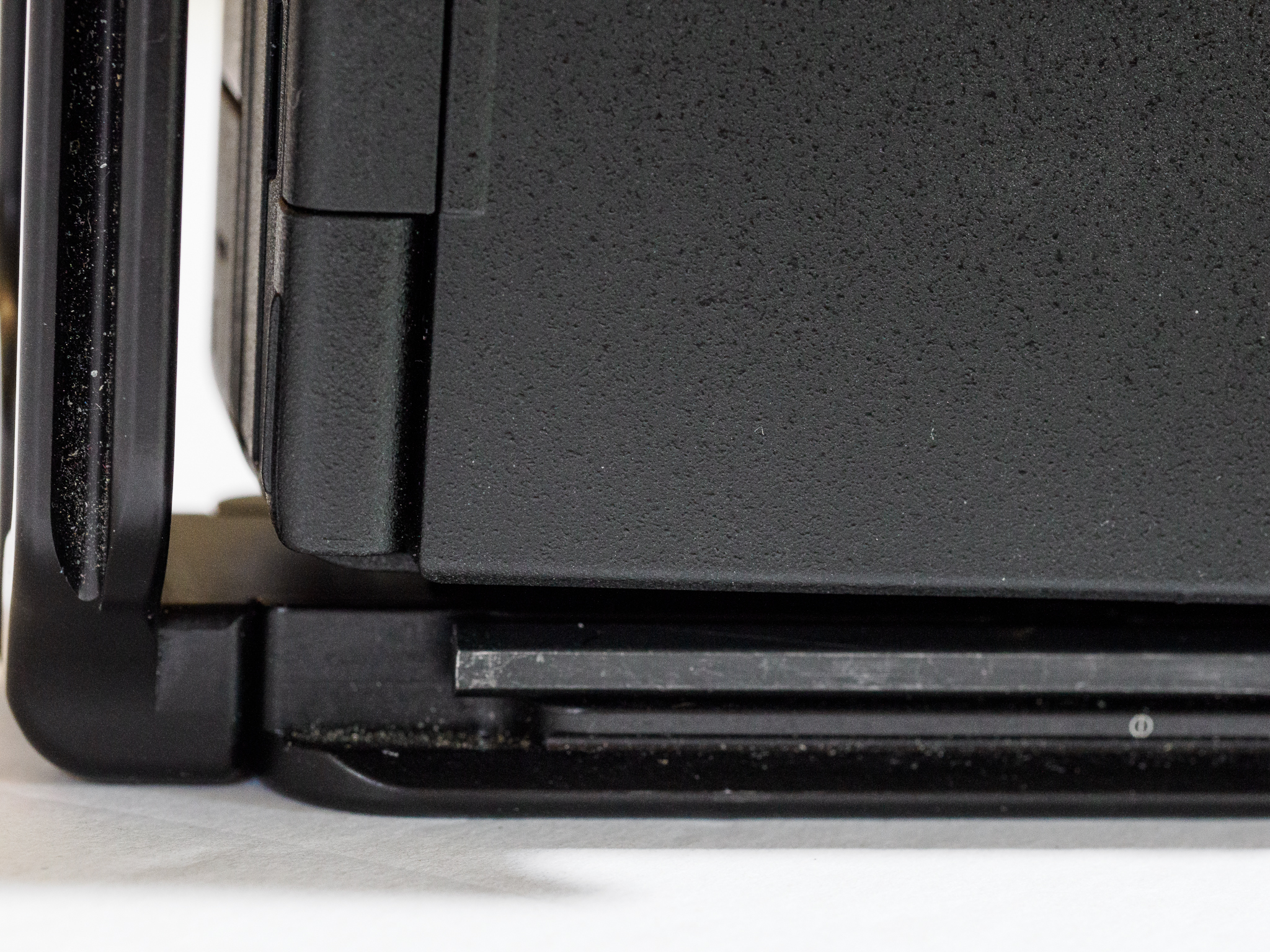

I have a Kirk a7R IV and it is not a good fit on the a7R V. It seems that the anti-rotation curvature feature on the front and rear of the Kirk is a millimeter or two too narrow. The side by the ports is cockeyed when installed. It’s a mystery to me unless there are subtle dimensional tolerances and it’s enough to make a difference. I just ordered a Rogeti L-Bracket and they claim it fits. I wanted the Kirk to be my go-to L-Bracket.

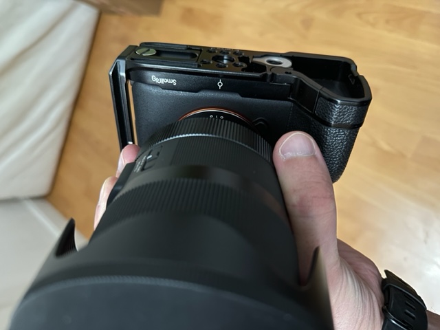

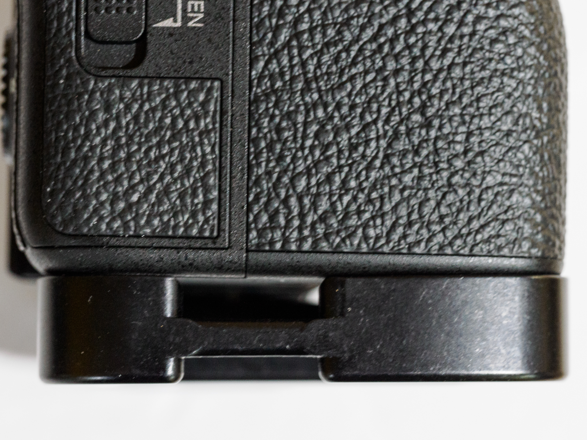

Agree the Small Rig 3660 L-bracket fits well and feels good in the hand.
It does have a couple of annoying problems though when used in camera-vertical mode.
If you have a long arca clamp like the RRS 60mm lever release clamp,
you cannot align the zero position on the clamp with the lens center index mark on the L-bracket.
It is about 5mm short. You need to go down to a 50mm or less length clamp to be able to align to the zero mark.
If you go below 50mm length and want to align to the index mark the clamp will only make contact with the one half of the rear L section because of the rear gap.
Also because of the gap in the rear part of the L-section there is no index mark there so you have to use the front mark which can be hard to see, being under the lens.
Thinking of getting the angle grinder out and extending the bracket channel a bit.
Small Rig's L-bracket for the A7M3 has the same first alignment problem.
