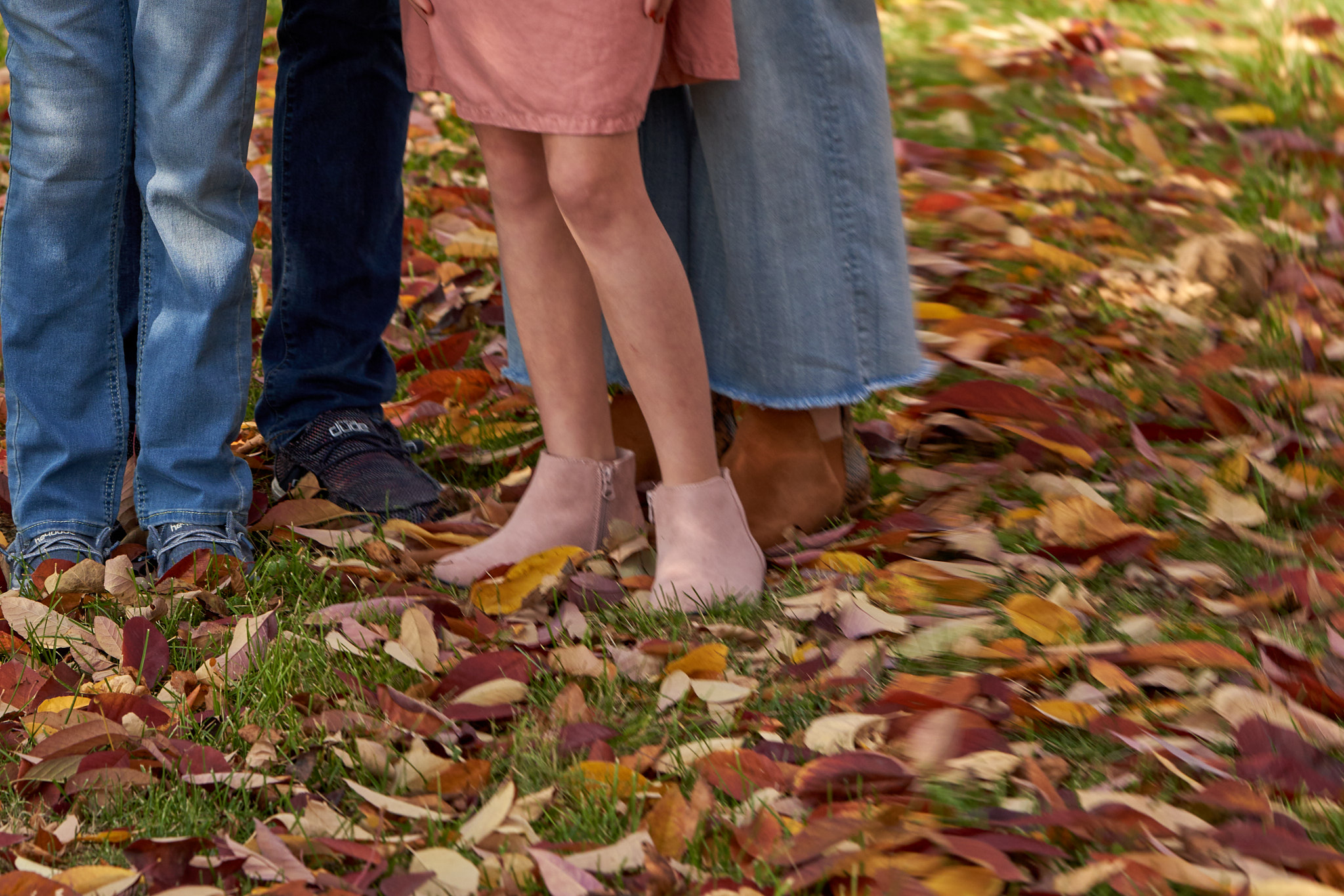

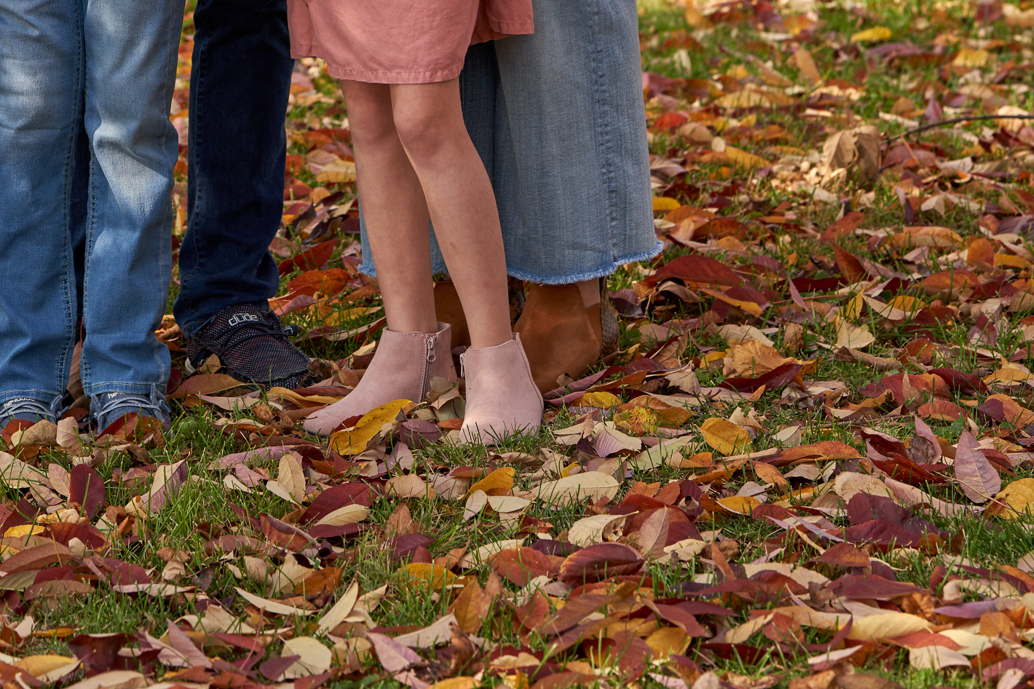

So I was taking some portraits over the weekend using electronic shutter on the a7Riv. Fast lenses with fast shutter speeds. I see some distortion in some of the files (stretched or compressed on the vertical axis) . I am thinking this was caused by camera movement as the sensor was being read. Basically rolling shutter by my not holding steady enough. At fast shutter I am less careful about holding the camera still. I know poor technique that must have some effect even on very fast shutter speeds (something to work on for better results).
No real disasters, but a mix of good and poor shots.
I have seen the numbers posted here before, but can't find them in search. Does anyone know the sensor readout speed of the a7Riv, a7iv, and A1? Also how does this compare the the speed of the mechanical shutter? I am thinking a camera with a flash sync speed of 1/250 must have a shutter that crosses the sensor in at least 1/500. So the A1 must be at least 1/800. This will help me understand how good my technique must be for electronic shutter, maybe there are very few use cases for electronic shutter with the Riv for me. Also one more consideration in my next camera either the Rv or the A1.

My Issues were defiantly due to motion of the camera using ES. I was shooting outside in the day at f/1.4 so depending on shade or not SS was up to 1/8000, but typically over 1/2000. When I shoot at the reciprocal rule or even 2x the reciprocal rule I consciously work on holding still during the shot. At faster speeds not so much (poor technique).
So as Dave mentioned the shots are sharp because of the high shutter speed, but distorted due to the rolling shutter and my camera movement. I was shooting at med frame rate and have several shots that are similar. As I was looking through them I noticed sometimes the people looked wider than normal and sometimes thinner (camera in vertical). So these would be consistent camera movement during the shot. For some I had a vertical strip that was expanded (clearly visible in the leaves on the ground). I'm guessing maybe some small movement from my shutter press.

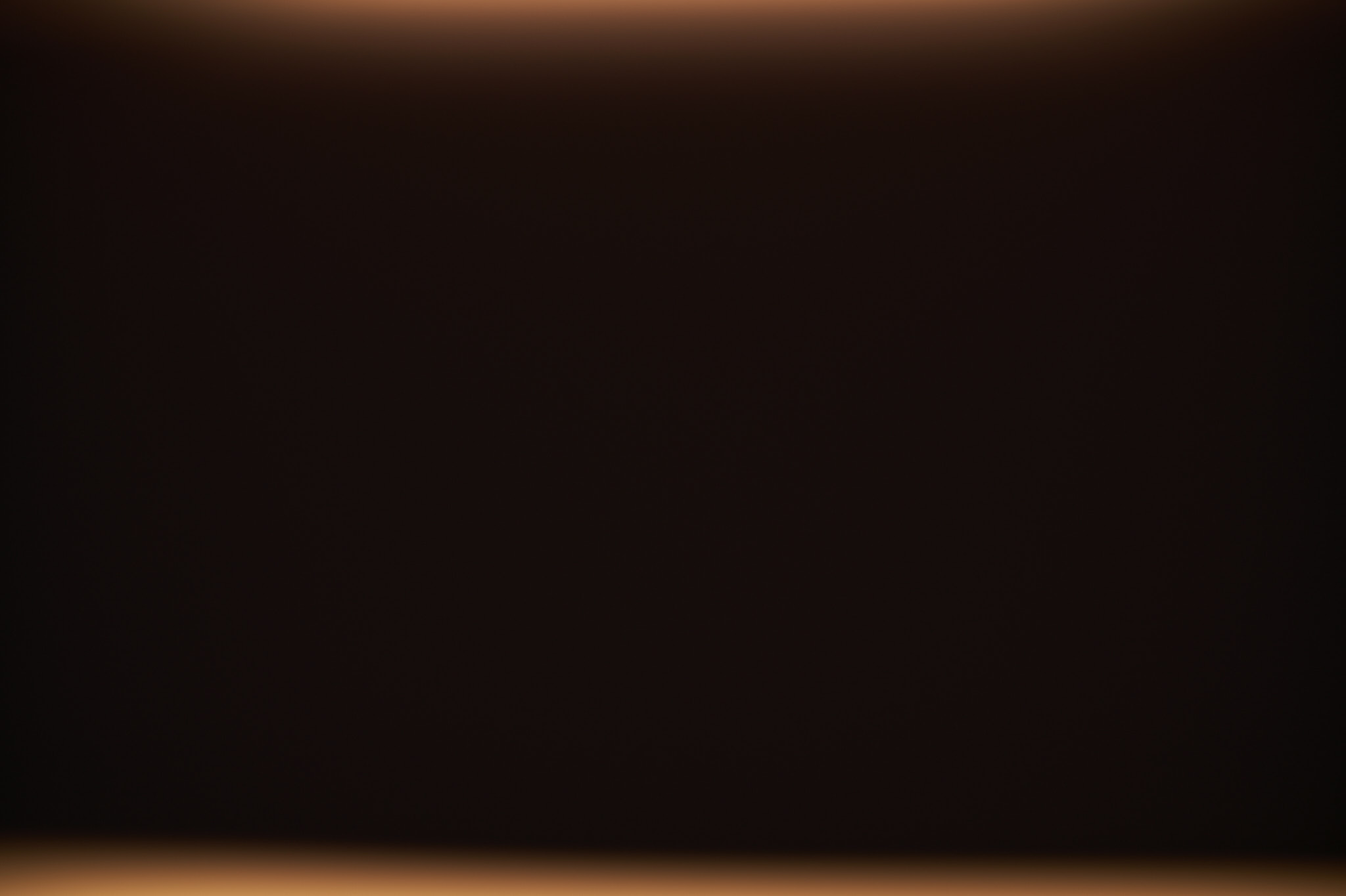

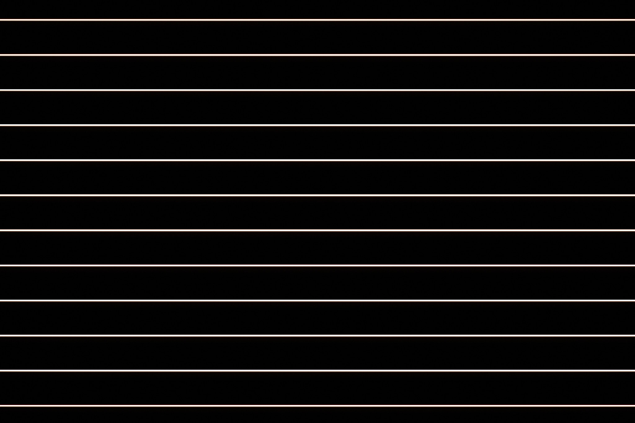

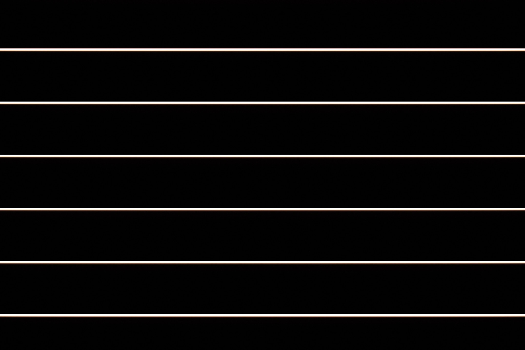

So I decided to measure the readout speed myself. Learned quite a bit about the camera. In compressed raw the ES speed is 1 / 18.21 sec, in uncompressed raw it is 1 / 9.95 sec. Or roughly 1/20 compressed and 1/10 uncompressed. These are both slower than I would want for the FL I typically shoot handheld. My LEDs were operating at 120Hz, that seems right for a cheap rectifying circuit.
To get the shot I took off the lens and held camera near a diffused LED on low brightness (low duty cycle).
compressed: 120 cycles/sec * 961.5 px/cycle / 6336 px/frame = 18.21 frames / sec
uncompressed: 120 cycles/sec * 525.4 px/cycle / 6336 px/frame = 9.95 frames / sec
I also measured the Hi+ frame rate. For mechanical it was 10 FPS, with ES it was 7.5 FPS.
I also figured out where my asymmetric vignette was coming from.
https://www.fredmiranda.com/forum/topic/1765676/2
In the pictures taken with mechanical shutter, the shutter does not expose the entire frame evenly. You can see in the upper corners and to a slight degree in the lower right corner.
Also included 50% crops from the photoshoot that made me ask this question.
I guess realistically the only path forward is to pick up an A1!
good shot
  ILCE-7RM4    Sigma 85mm F1.4 DG DN | A (Sony E) lens    85mm    f/5.6    1/400s    200 ISO    0.0 EV
distorted / blurry shot from camera motion with ES
compressed ES at 120Hz LED
  ILCE-7RM4    ---- lens    1/8000s    320 ISO    0.0 EV
uncompressed ES at 120Hz LED
Mechanical shutter, note shutter induced vignette in upper corners
  ILCE-7RM4    ---- lens    1/250s    100 ISO    0.0 EV
Uniform exposure below this point
Oct 22, 2022 at 05:55 PM

That ES blur shot is very interesting, I've never seen something like this on A7III. The effect was mostly visible as elongated features...
Also, unless you're using EFCS, I think mechanical should always result in even exposure/vignetting?
