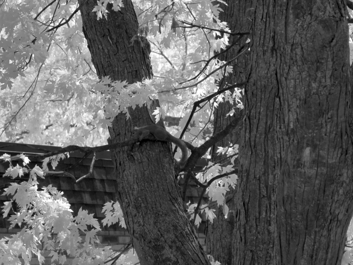

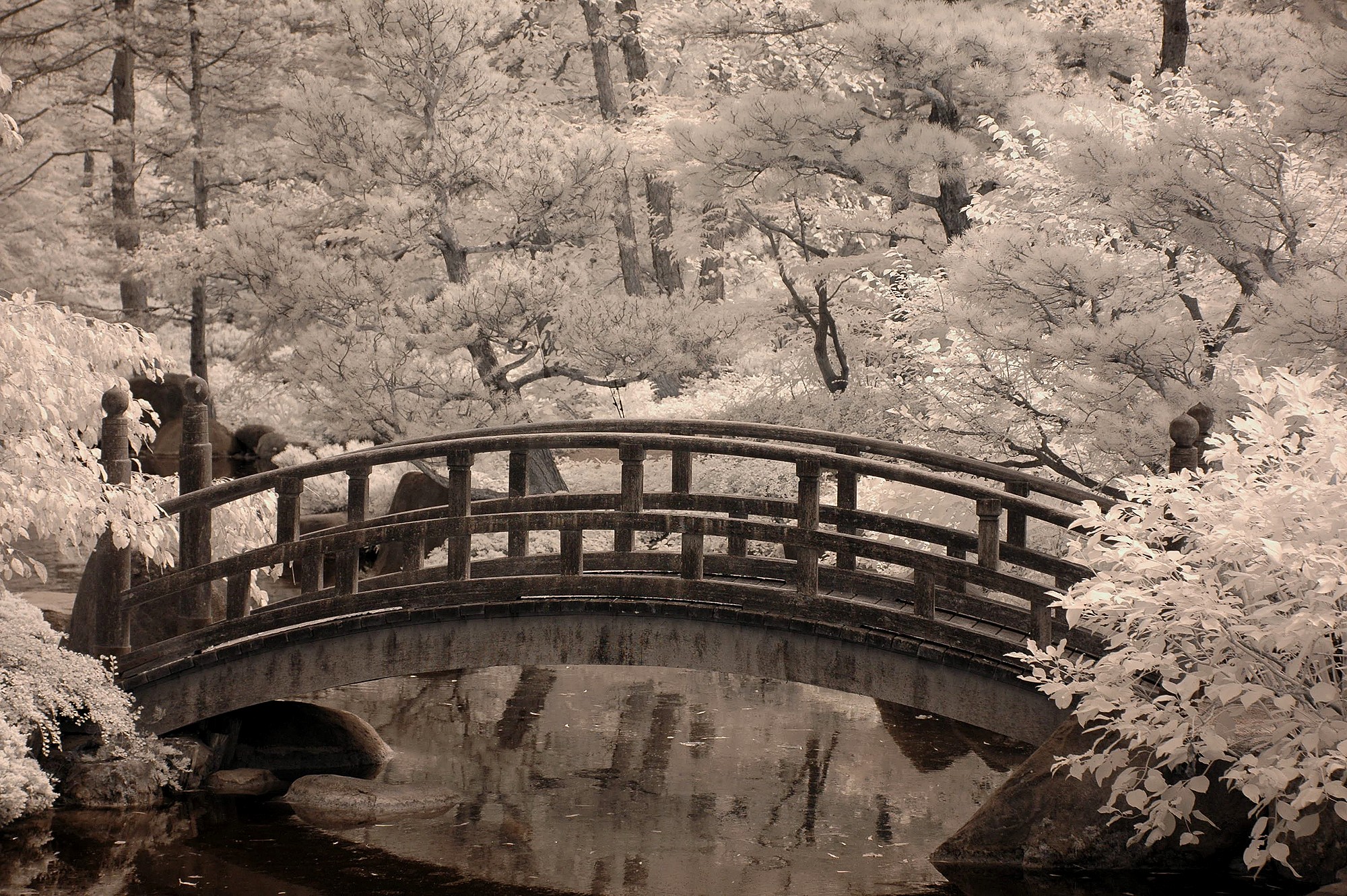

Kolari and LifePixel have sample images of IR filters. 720 gives a sepia tone to skies. I stopped using filters and went to converted cameras. The entire switcheroo became too tedious. These are done using Nikons but IR is the same everywhere.
720 NMimage

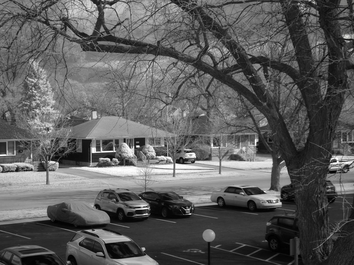

850 NM
Edited on Sep 29, 2022 at 10:26 PM · View previous versions
Sep 29, 2022 at 10:09 PM
runamuck
p.1 #4 · Infrared filter strength (nm)
nother deep IR 850 NM There is no color. ETA: Check facebook for IR grous. I am in 2.
Sep 29, 2022 at 10:21 PM
