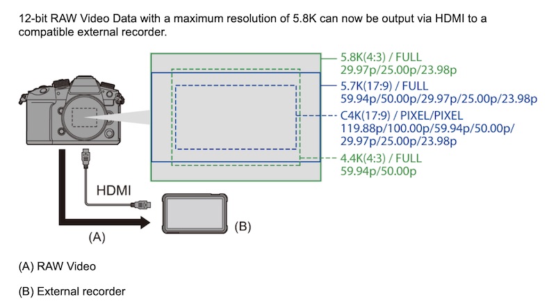

Regarding shooting "open gate" on the GH6 (and my S1's), it is my preferred method for shooting wildlife video for the very 4K-cropability reasons you state and there's also the benefit of providing for some extra image stabilization and 4K/1080P frame-panning in post with one's NLE (see image below). I'm greatly looking forward to see what Panasonic will offer in an 8K camera!

Sensor Aspect Ratios for Frame Rates from GH6 Manual.

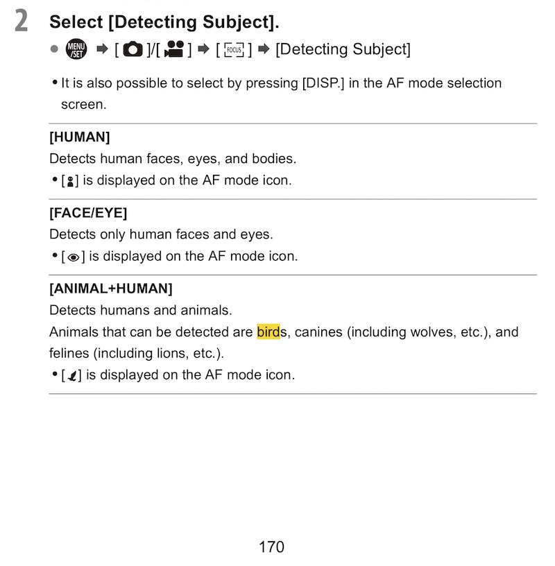

Um, well, my GH6 actually does AF birds...and wolves, and lions apparently, but I've never tested the latter two...
Source: GH6 User Manual
I guess the reviews I read where people complained about the GH6 not having bird/animal detect AF were obviously wrong... I never bothered to dig any deeper since I have no interest in the GH6 myself, but it's good to know that feature is there.
