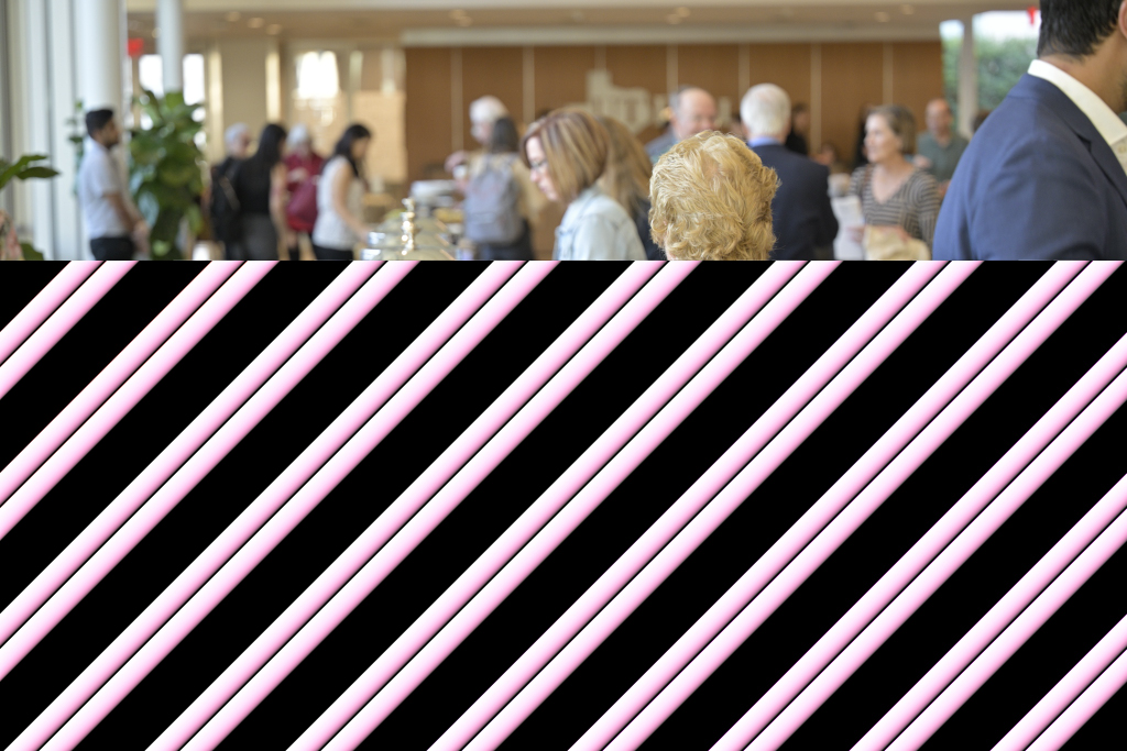

I've had my two Nikon Z9's for a couple of months now. I've used them for over 10k shots so far. I'm experienced D6, D5 shooter and have had two latest Flagship cameras for the past 20 years.
I have had my Z9's freeze up twice on me where I had to pull battery to reset. Both times the camera wasn't lighting up, preview, EVF or any response to any input. No error message either.
I found this one corrupt file within a 1900 image shoot. When viewing in Adobe Bridge, I can see the thumbnail for a split second, then the bottom 2/3rds of the image goes black. When you open the file up, it's 2/3rds black.
I've sent to NPS support but of course, no response.
here's a dropbox link to the image
https://www.dropbox.com/s/gdy2mw7rerexapp/004-22-102.NEF?dl=0

full nef observed here using NX studio exported out and it loses it.
with Adobe raw just like what you see.

camera firmware?
cards used?
you are using 14bit raw from what i see.
i have gotten one or two blanks so far myself
other than that a good run.

same w adobe bridge accept solid black. ??

I'm shooting compressed raw only w prograde 640gb cfexpress

i have shot HE* with no issues

nice. Not that it matters. that was part my test shot before capturing the image w people in line and getting food. It's weird though that the nef didn't record fully.
I wondered if I turned camera off too soon but all the D cameras would finish writing the file before shutting down.
I'm still shooting test shots like with the D series because I haven't totally trusted the preview EVF yet.
I'm also finding that using Auto ISO or any auto exposure functions, Im' a good 2/3-1 stop under. That doesn't work well at over 6400iso. I'm back to manual everything except focus like I've shot for decades. It's easy.

When I have had these problems it was with defective memory cards. If the camera cannot write to the card the firmware does not recover and have the memory card write to a different sector. A bad sector or a card that is too slow with data writes from the camera will cause problems.
