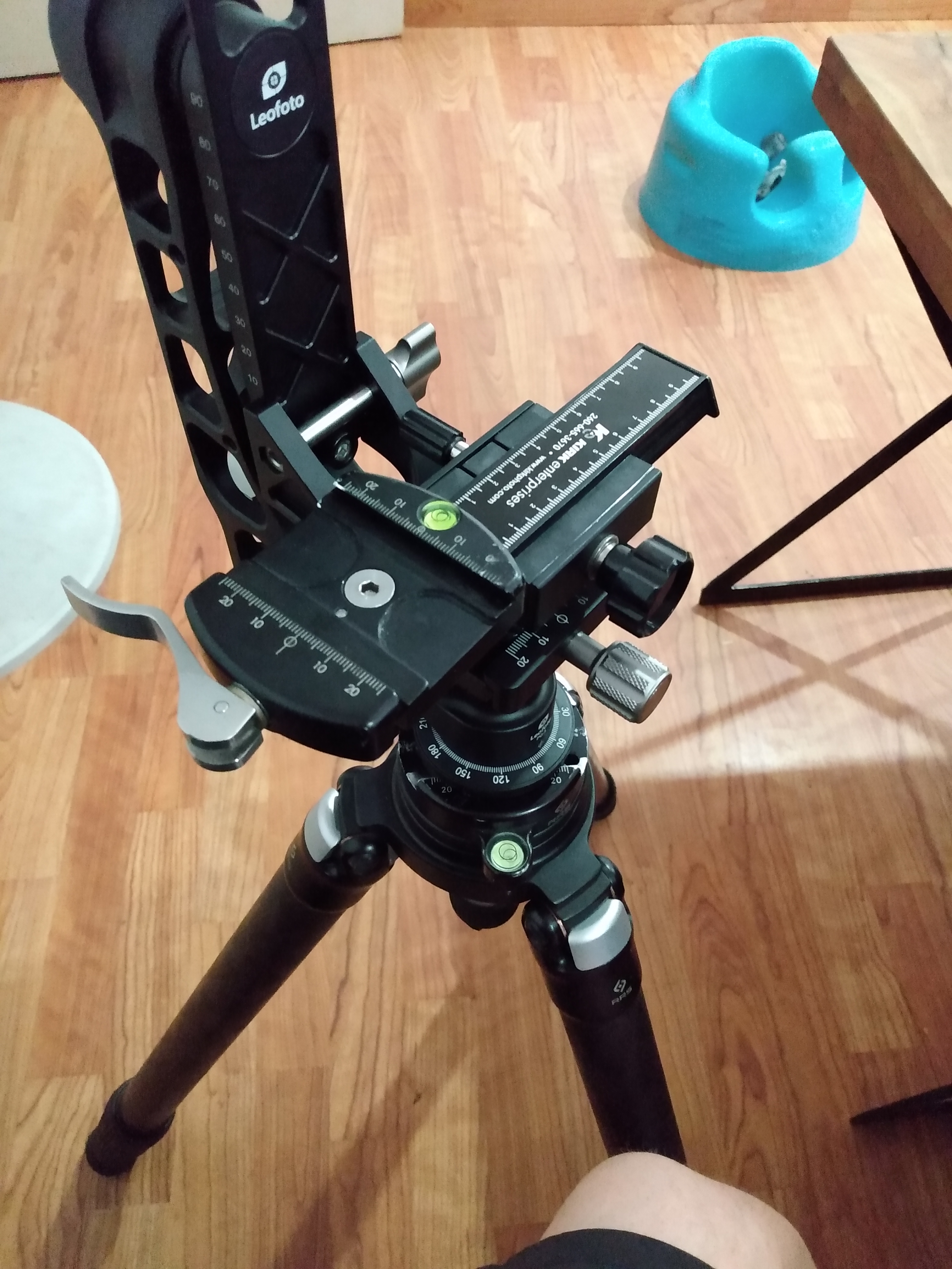

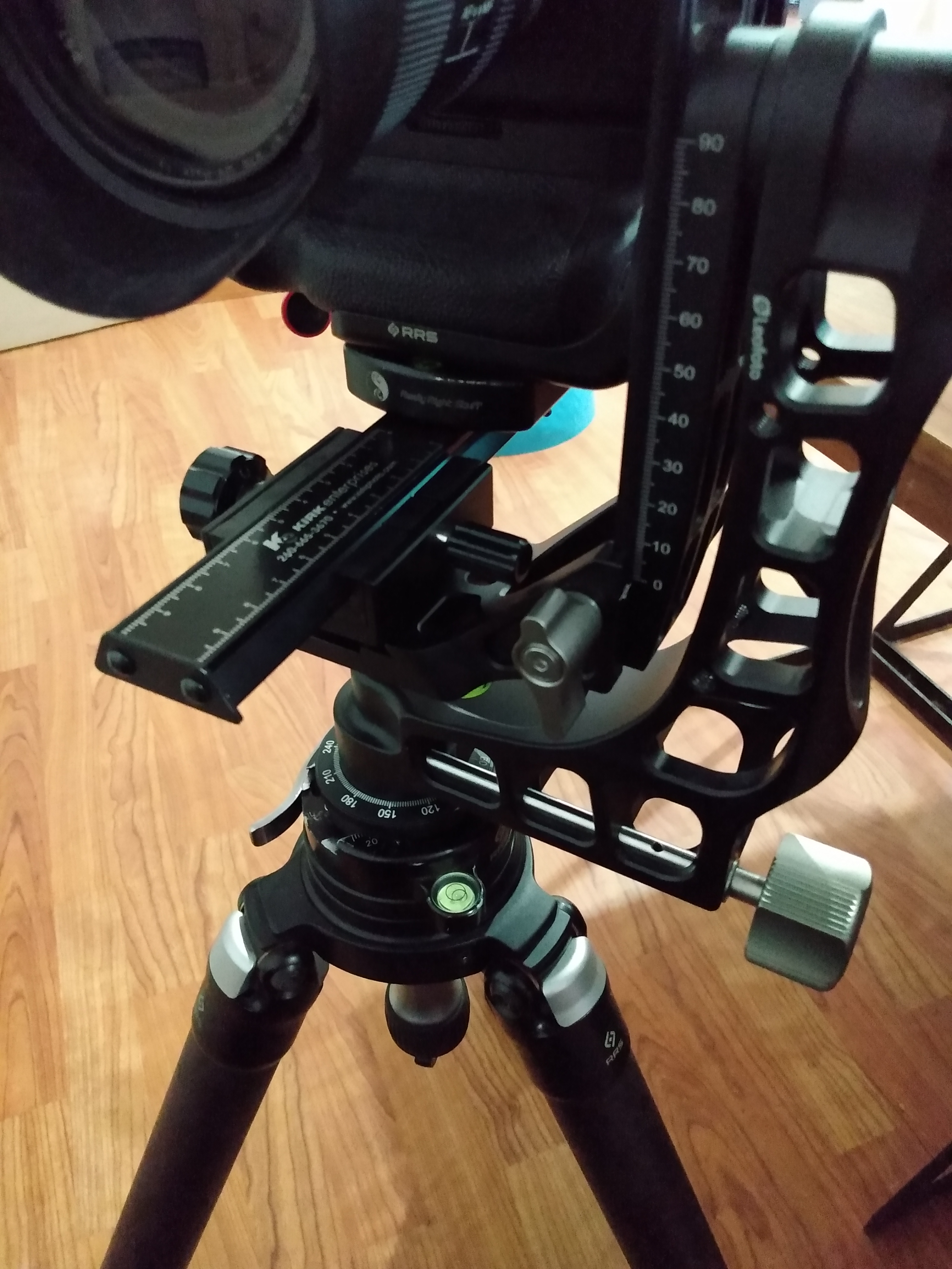

jschulze
p.1 #3 · L-bracket on Gimbal
Search for a nodal slide and that should do the trick for you. You can spend anywhere from $20-$200 depending on your budget. Just clamp the bottom rail of the nodal slide to the clamp on the gimbal and then your camera to the clamp on the nodal slide. It also has the benefit of still being able to balance your camera on the gimbal. I use a Kirk macro slider for this same function, but only because I already had the slider.
This one is on the more expensive side, but would do the trick nicely.
https://www.adorama.com/rrsmprclii.html?gclid=Cj0KCQjw3f6HBhDHARIsAD_i3D-c3NkDzLS43KxuTWWQZ4QOjp2I3bdFnnilQ51is6lh8TodJeGaXYgaAiLcEALw_wcB&gclid=Cj0KCQjw3f6HBhDHARIsAD_i3D-c3NkDzLS43KxuTWWQZ4QOjp2I3bdFnnilQ51is6lh8TodJeGaXYgaAiLcEALw_wcB&utm_source=adl-gbase-p
edit: Added pictures of setup.
Edited on Jul 27, 2021 at 11:53 AM · View previous versions
Jul 27, 2021 at 11:32 AM

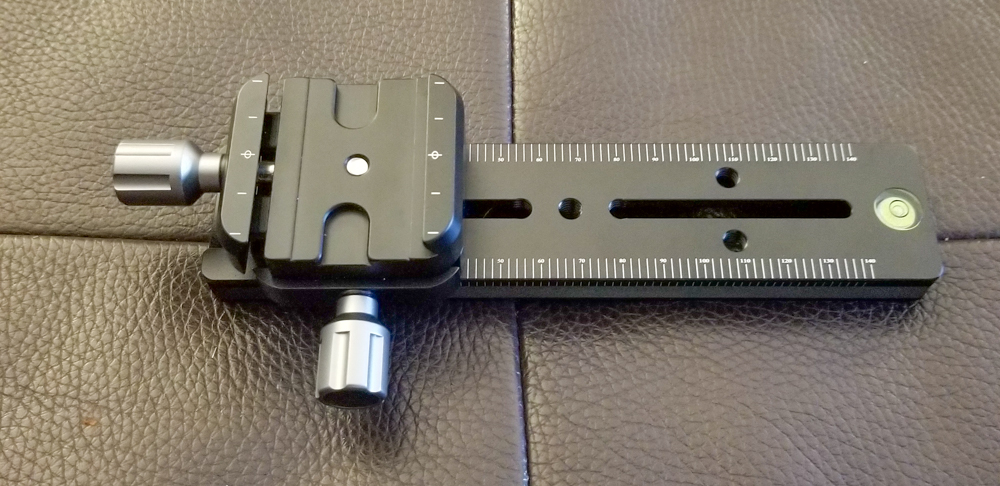

Dragonfire
p.1 #7 · L-bracket on Gimbal
I recently purchased an inexpensive system from Amazon that allows me to set my nodal point for panoramas while using my 150 x 170 Haida filters on my EF 14L II.
I can set camera position and nodal point independently, unlike a bar with a fixed clamp position.
Clamp - https://www.amazon.com/dp/B08H5RKNSR?psc=1&ref=ppx_yo2_dt_b_product_details
Plate - https://www.amazon.com/dp/B08H8SHZH3?psc=1&ref=ppx_yo2_dt_b_product_details
Jul 28, 2021 at 05:36 AM
