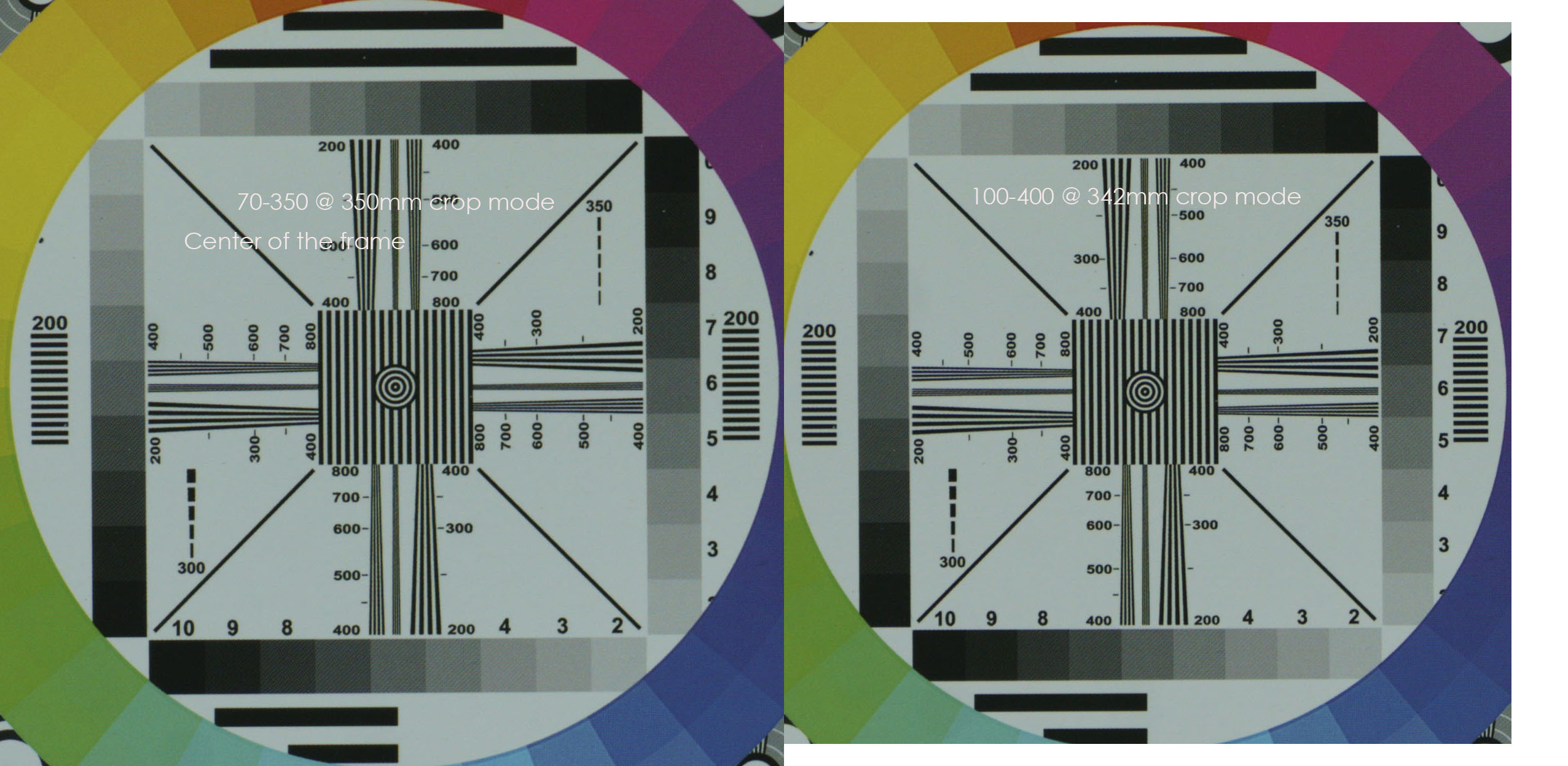

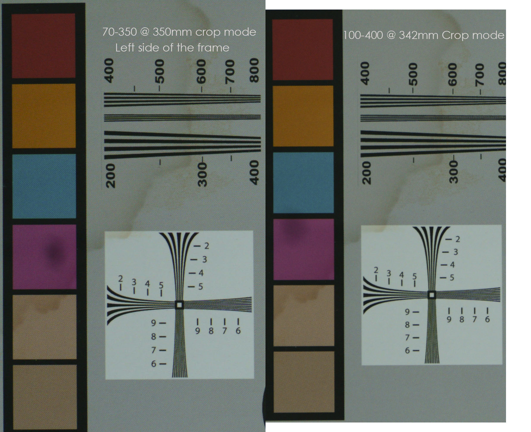

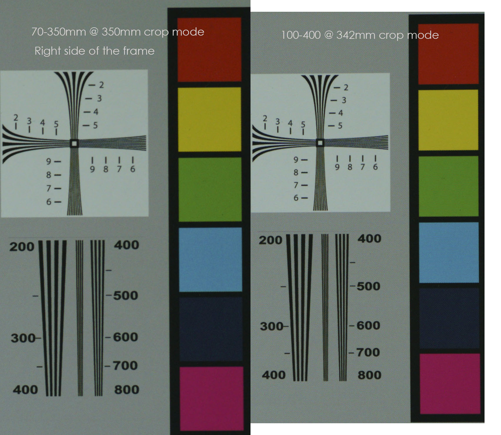

Your experience doesn't match mine of course. Anything is possible. My 100-400 could've been a bad copy, your 70-350 is a bad copy or even my 70-350 is a special piece (I like to believe this ). Anyway I tested 100-400 against Nikon 300 f/4 PF and 100-400 was sharper. It was almost equal to 500PF. My 200-600 is slightly softer than 500PF (now sold)
Anyway I was looking for a lighter lens that can reach around 500mm and I'm very happy. It didn't matter to me even if 100-400 is slightly sharper. For me 100-400 cannot be the only WL lens and it's not a everyday walk around lens. So 70-350+200-600 suits me best.
Below is one of the tests I did. Both shots are on tripod using wireless remote and OSS off.
Please note that my setup was not 100% parallel to the wall. So in 70-350 shot left side is sharper and 100-400 the right side. Both looks same at the center. Both shot in crop mode on A9. 100-400 was set at 342mm. It was also interesting that 70-350 don't have much breathing (if at all). What do you think?
Both processed using ACR using neutral picture style with ZERO sharpening. So they look soft. What do you think?
Actual frame using 70-350
Left side of the frame @ 100% (neutral style, zero sharpening using ACR)
Center of the frame @ 100% (neutral style, zero sharpening using ACR)
Right side of the frame @ 100% (neutral style, zero sharpening using ACR)

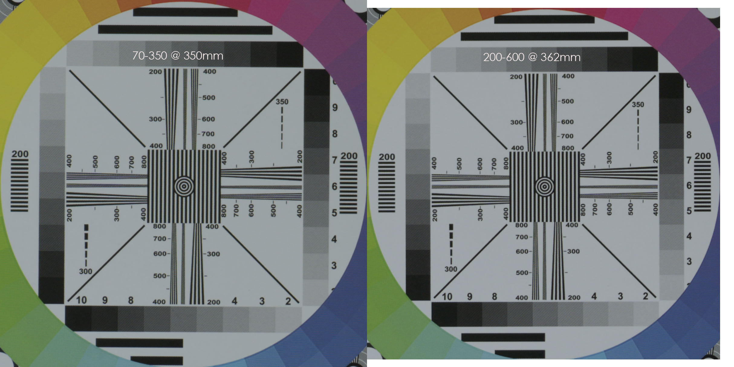

and here's the center of the frame between 70-350 and 200-600 (same setup and processing as above). 200-600 was set at 362mm. You can see 70-350 has more magnification! 200-600's 600mm is close to 525mm at closest distance. So no surprise.
70-350 vs 200-600 center of the frame, neutral style zero sharpening
