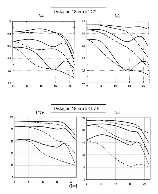

I've been using the 18/3.5 ZE for many years. Now, mostly on the 50 MP 5DS. I decided to spend more for the newer ZE design because its MTF curves are usefully better than the CZ 18/4 C/Y, and it provides the same 'look' as my other ZE lenses; 21/2.8, 35/2, 50/2, and 100/2. I've been very pleased with it. A couple of years after getting the TS-E 24/3.5L II, I bought the CZ 18/3.5 ZE and sold the CZ 21/2.8 ZE. Of course, I somehow ended up with another 21/2.8, but the 18/3.5 has been a keeper, since Day 1.
I haven't directly compared the CZ 18/3.5 ZE with the CZ 18/4 C/Y, but I can say with confidence that the CZ 18/3.5 ZE holds up as well as the Distagon 21/2.8 ZE, for higher MP cameras, and with respect to the competition (e.g. Canon TS-E and L-series). That's really well. They're generally at the top of the IQ heap.

Here's the MTF curves, from Zeiss data sheets.
MTF curvesL Zeiss Distagon 18/4 C/Y (top) and Zeiss Distagon 18mm f/3.5 ZE (bottom)

Thanks a lot all of you. @f8-11 based on the MTF, I assume the c/y may show little weaker extreme corners (field curvature), besides this it is a wash between the two, is this correct?

Advantages of the 18/4 C/Y Distagon over ZF 18/3.5 Distagon are three: compact size,slightly less geometrical distortions and older "film" look.
ZF 18/3.5 is better in all other respects,i.e. sharpness across the frame no mater aperture,(corners included),better microcontrast overall and slightly less CA.
Yet it doesn't mean that 18/4 is a crappy lens.It is only dated by design.One has just remember to stop it down to f8-11,bearing in mind it's field curvature and try to get well,evenly lit subjects to show the lens at it's best.
