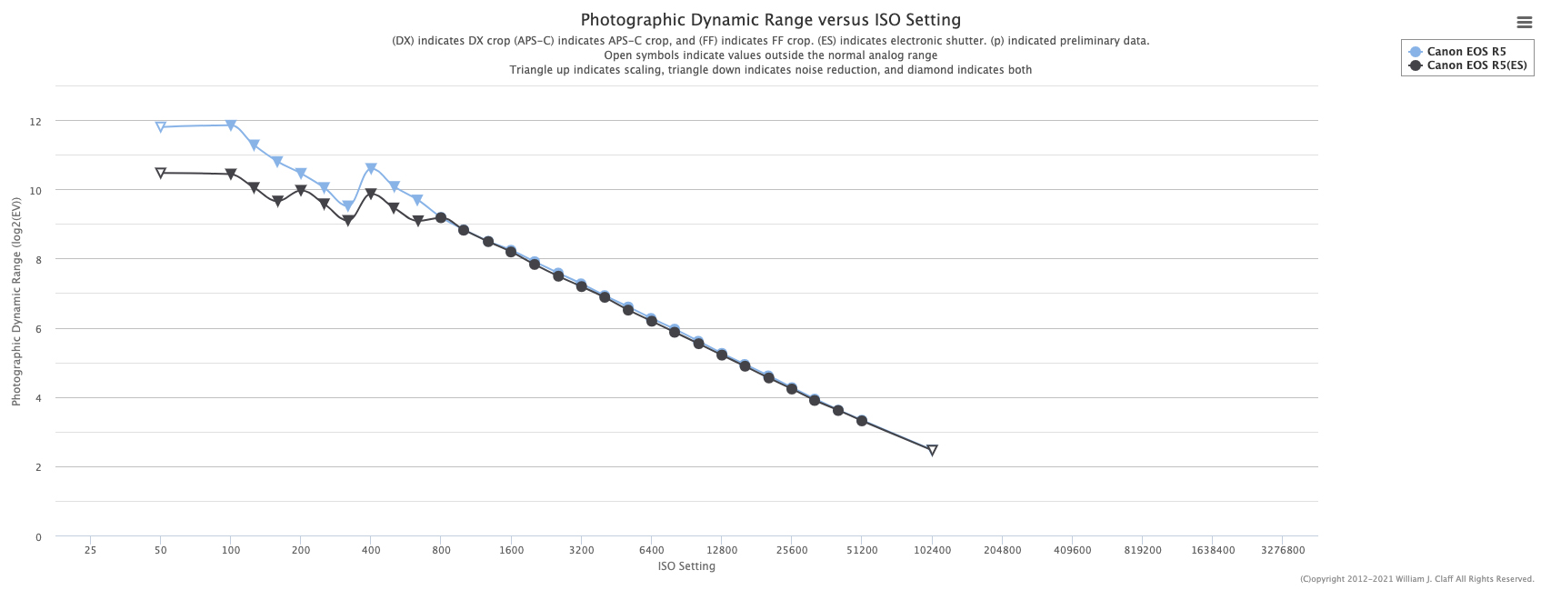

Using the Electronic Shutter mode seems to have a pretty significant effect on dynamic range...

armd wrote:
That goes away for those of us who shoot sports, WL, BIF at ISO's > 800 for those applications where rolling shutter is not a consideration, it's ES all the way, baby.
If I were shooting landscapes/fashion at low ISO's where DR might be a more important consideration then MS is the ticket.
No kidding. At lower ISO's the DR of the R5 and R6 is worse than some m4/3 cameras if you have to use ES.
Which ones? I had a look through the Olympus and Panasonic recent models and the R5 was either better or at worst dead even for DR at the lowest ISO values. Only the G9 at ISO 320 was higher than the R5 at 320.
But I guess without the R5's baked in RAW NR then the M43 sensors could be slightly better.
Now the R6 is worse than some of the M43...I'll give you that.
