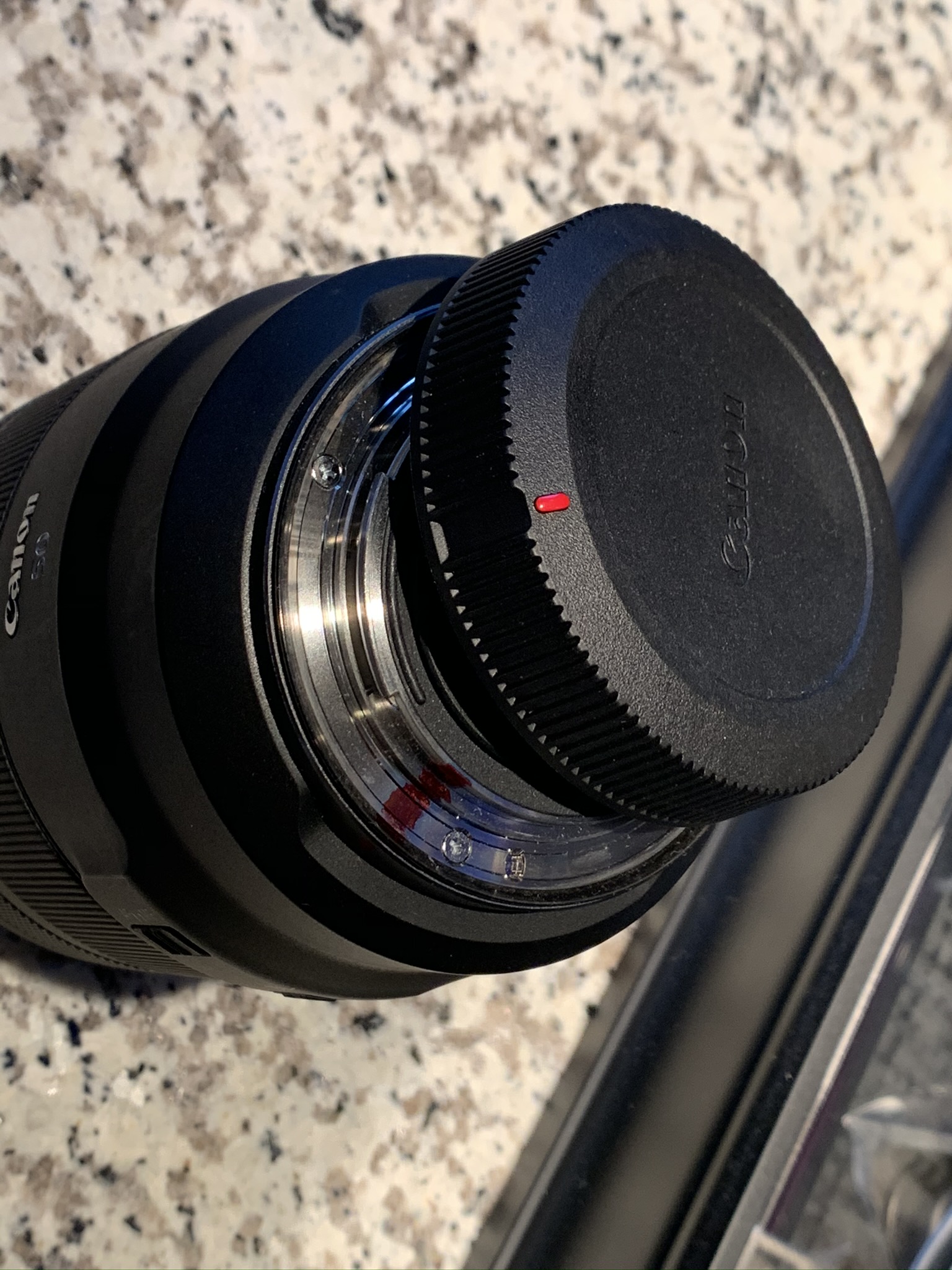

Since the RF caps are slightly different, I bought colored ones from Amazon, and used black permanent marker pen to mark the spot on the side that aligns. I keep black EF caps for most of my EF lenses.

In the absence of a nice protruding ball on the lens that can be seen from the rear, and anything on the cap that can be seen, I apply nail polish to the dot on the cap (can also add to the edge channel but gets ugly) and some red Sharpie marking to the mount to see from the rear. This also aids in mounting the lens to the body.
