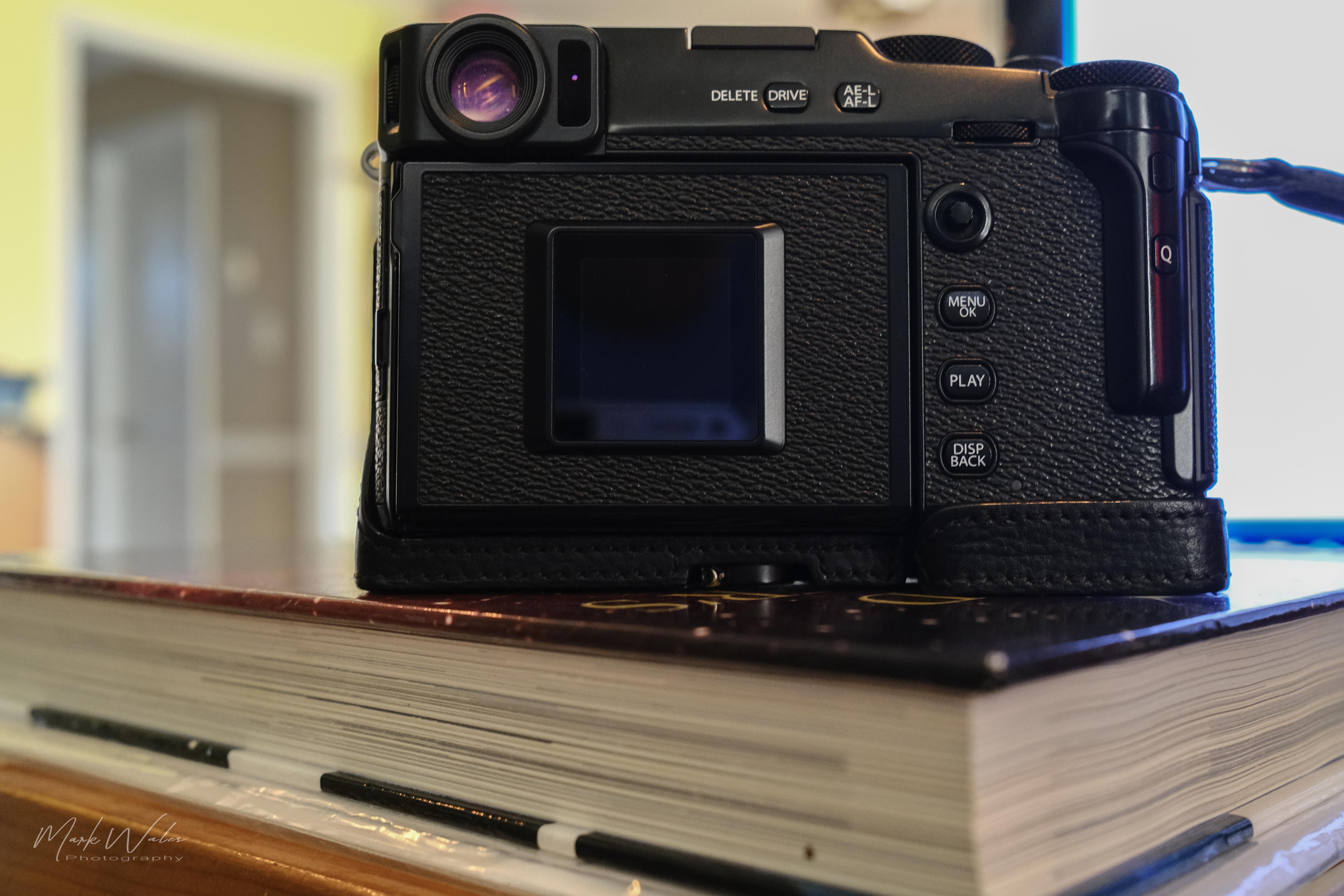

My sub monitor is now either silver, half & half black and silver or just black most of the time.
Anyone owning an X-Pro3 have this issue or heard of it?

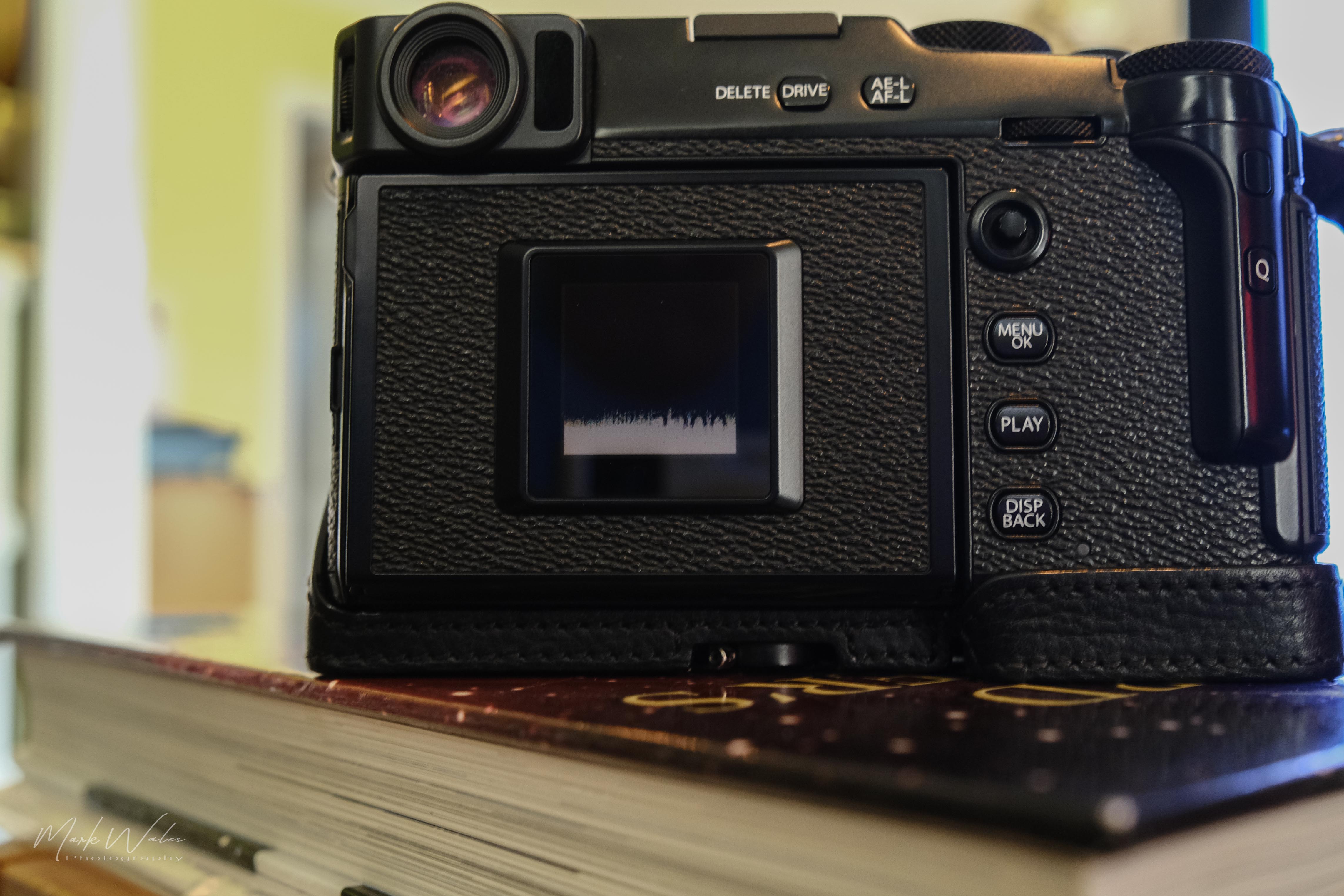

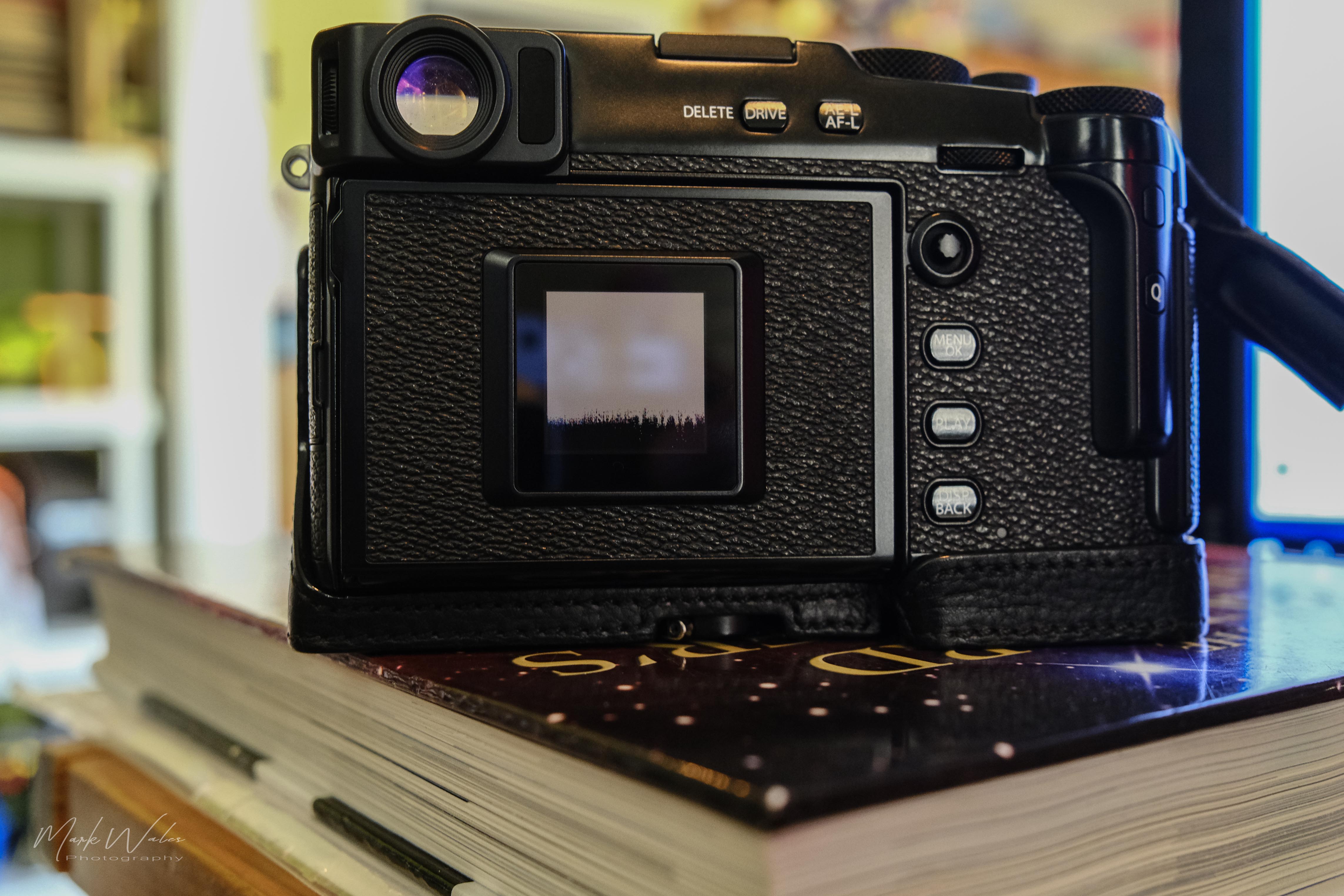

Here's what the screen looks like. Now and then it does come back to normal, but then changes back to one of the images below.
On or off It does it in either standard or classic mode.
