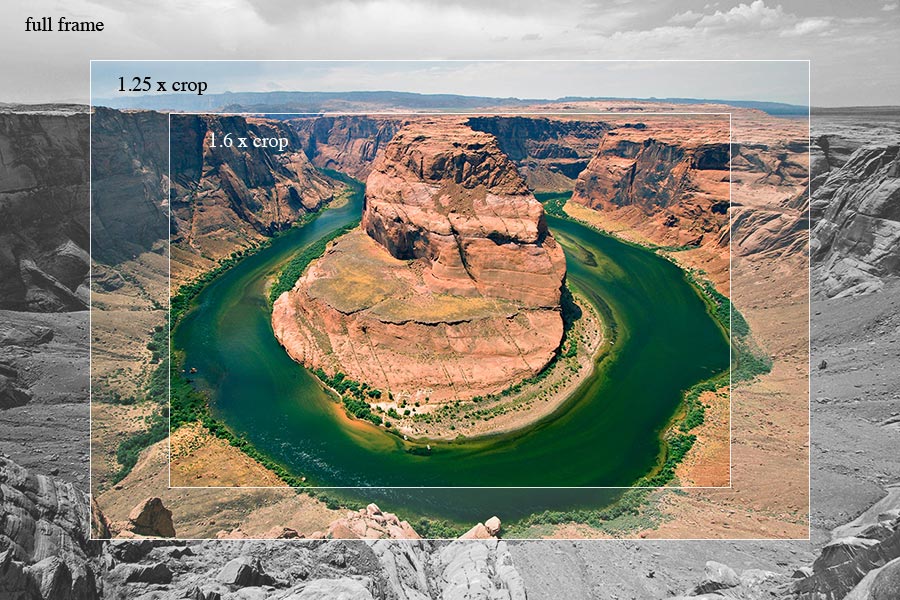

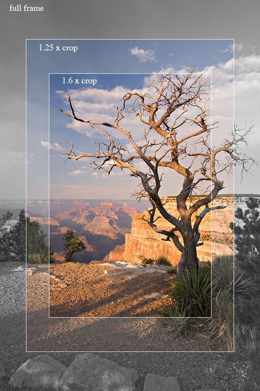

drimer's and Jeff's replies clued me in to the fact that you're not shooting on full frame. That affects my advice in two ways:
1. The differences in focal length (20 vs 24, and 17 vs 20) are not so dramatic on APS-C or APS-H as they are in full frame. So I encourage you to look into something wider than 20 if you really want to get into wide angle. The 17-40L is a better choice than any zoom starting at 20 mm.
2. I warned in my previous reply that the 17-40L is weak in the far corners at 17 mm. That doesn't apply in your case, because none of the camera bodies you use actually capture that part of the image circle. So that makes the 17-40L even more viable as a choice for you. Look for a used one in excellent condition.
Edit: Here are some images illustrating the differences between full frame, APS-H (1.25X) and APS-C (1.6X), with wide-angle compositions. (I think these were shot at 16 mm.)
