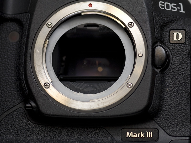

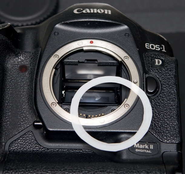

You could try taping the contacts, to eliminate comms between the lens and camera. I prefer using a mylar anulus that fits just inside the mount, as shown below. Another way of saying "mylar anulus" is "flat ring cut from drafting sheet plastic"
You'll have to enable "shoot with no lens" in the camera settings (or whatever it's actually called).
© jcolwell 2019
Mylar ring on 1DII (cure mount microswitch-adapter issue)
© jcolwell 2019
Mylar ring in 1DIII (cure non-reporting lens on Canon Extender issue)
Will try your idea. Thanks Mr. Colwell.

Added benefit: when inserting the mylar annulus , your camera body gets upgraded to the next higher version (Mark II -> Mark III, etc.)!
