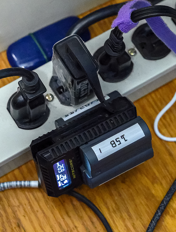

EB-1
p.1 #9 · Does any have the NITECORE UCN3 digital USB travel charger?
I have the UCN1, UCN2 and UCN 3.
LP-E6 and LP-E6N are the same for the charging, but give me a bit of time and I will update this thread with the UCN2 and UCN3 issues.

UCN1
I'm not commenting on the UCN1, because I think it is obsolete and the UCN3 is similar. I have no issues with the UCN1 though I never used it for anything but a single LP-E6N.
UCN3
The UCN3 is fine for a single battery, but with two batteries attached it alternately charges one battery for a few seconds then charges the other until one of them is completely charged. The overall charge time can therefore be rather long for two batteries in different charge states. A basic LP-E6 charger from various manufacturers that charges two in parallel can be faster than the UCN3 in that case, though they don't provide the detailed display info of a Nitecore. If you use two batteries at the same charge state, e.g., in a grip, then most all of the USB 2x chargers will end up about the same time since they are limited by 10W input.
UCN2
The UCN2 is a larger and heavier dual battery charger. It charges two batteries at the same time on the same side and has electronics and a display for each. It is unusual in that although the input is a conventional micro USB port, it accepts QC 2.0 or higher, 9Vx2A in this case. A single battery charges at a max 1.2A vs. 0.8A for two batteries. Unfortunately either due to heat or inaccurate voltage measurements, and battery chip reset, or a combination, there are problems. Much of time the battery will not charge completely and charging two at a time doesn't fully resolve the issue. Sometimes re-installing the battery will restart charge and it will complete.
At this time I'm mainly traveling with a UCN3 in the carryon, but with 1-2 LC-E6 chargers in the luggage. The LC-E6 is still the fastest and most reliable charging option for the LP-E6/N. I have the UCN2 set up at home in a central charging area, but I would not buy one again.
In case anyone is into testing batteries and chargers, I use cheap LED video lights to discharge the LP-E6/N. Several are available with various adapter plates for Sony, Nikon, Canon, etc. batteries.
