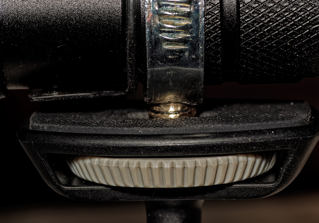

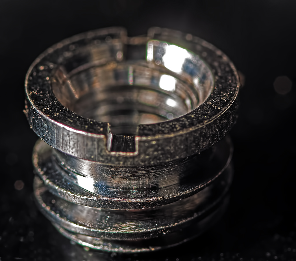

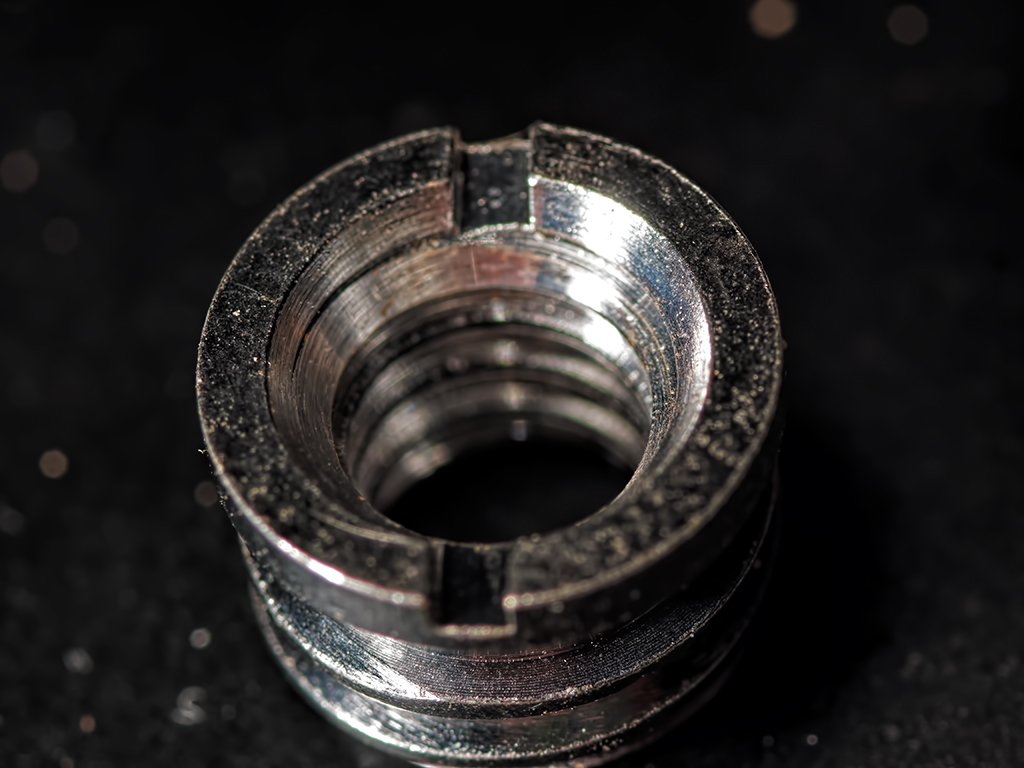

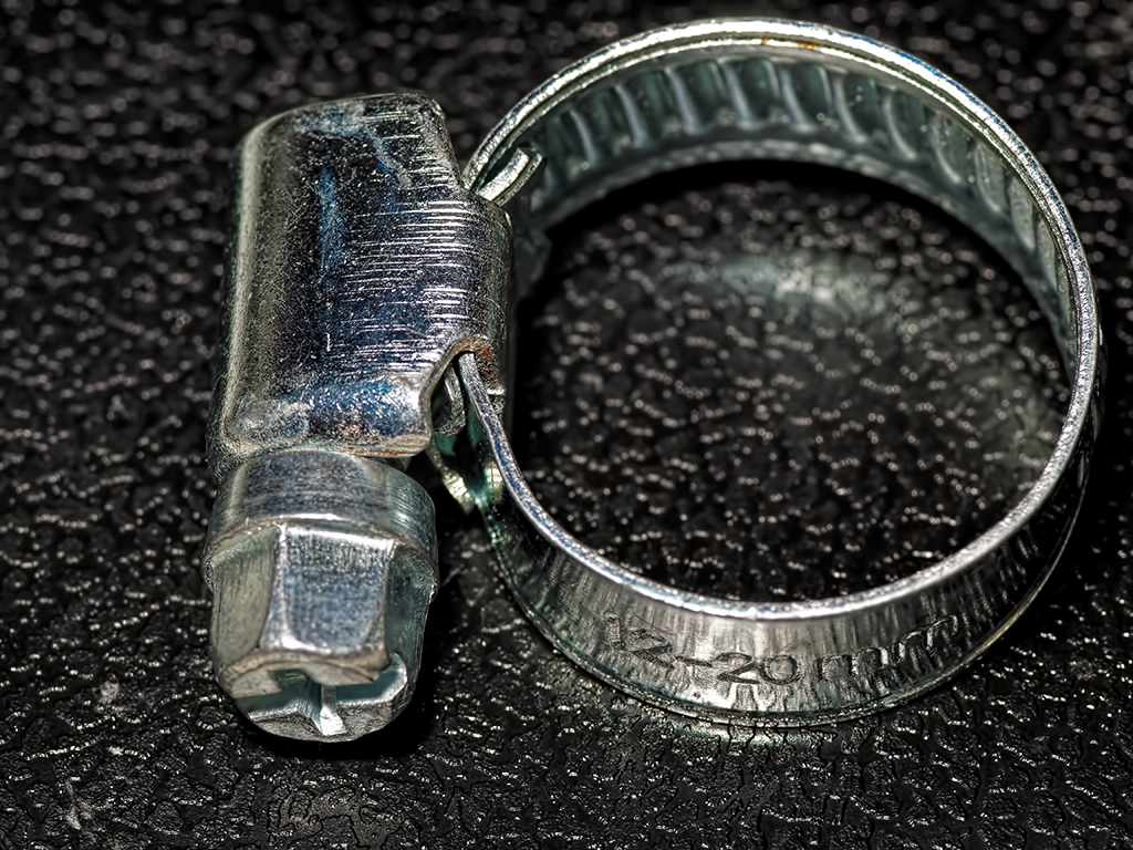

To mount to a typical tripod requires a female ¼ inch tread. I obtained this by purchasing a 3/8” to ¼” bush adapter. I did not want to drill the torch so I purchased a selection of Jubilee Clips (aka worm drive hose clamps).

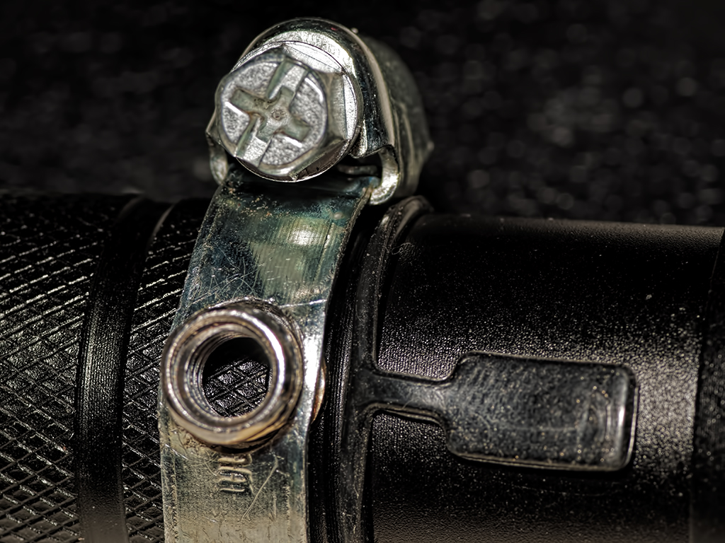

I chose a clip to fit the torch handle and set about drilling a hole to take the bush. The problem was that the external threads of the bush were about 7.5mm and the clip was 9mm wide. The largest drill bit I could use was 7mm. I then had to file off some of the external thread (which I originally intended to use to secure it), stretch the drill hole, and, finally, use pliers to squeeze and lever the adapter into the hole from the inside of the clip. This gave a tight fit, which was totally rigid when the clip was finally fitted and screwed tight.

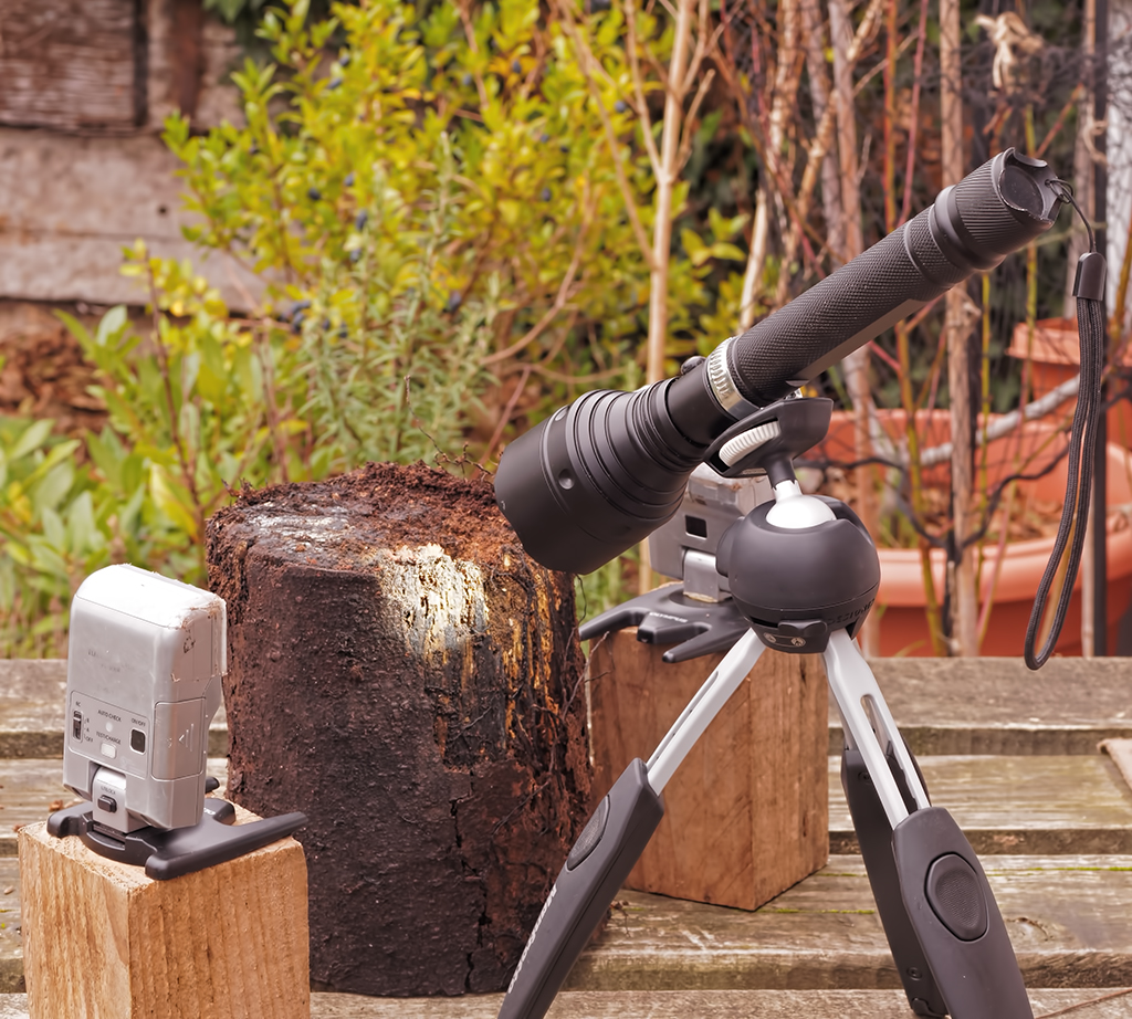

I think the images are self-explanatory. (A tip: a single flash gives best results with these shiny metal parts).
The final image shows a typical use. Note how much brighter is the part of the subject in the beam on a cloudy day.
