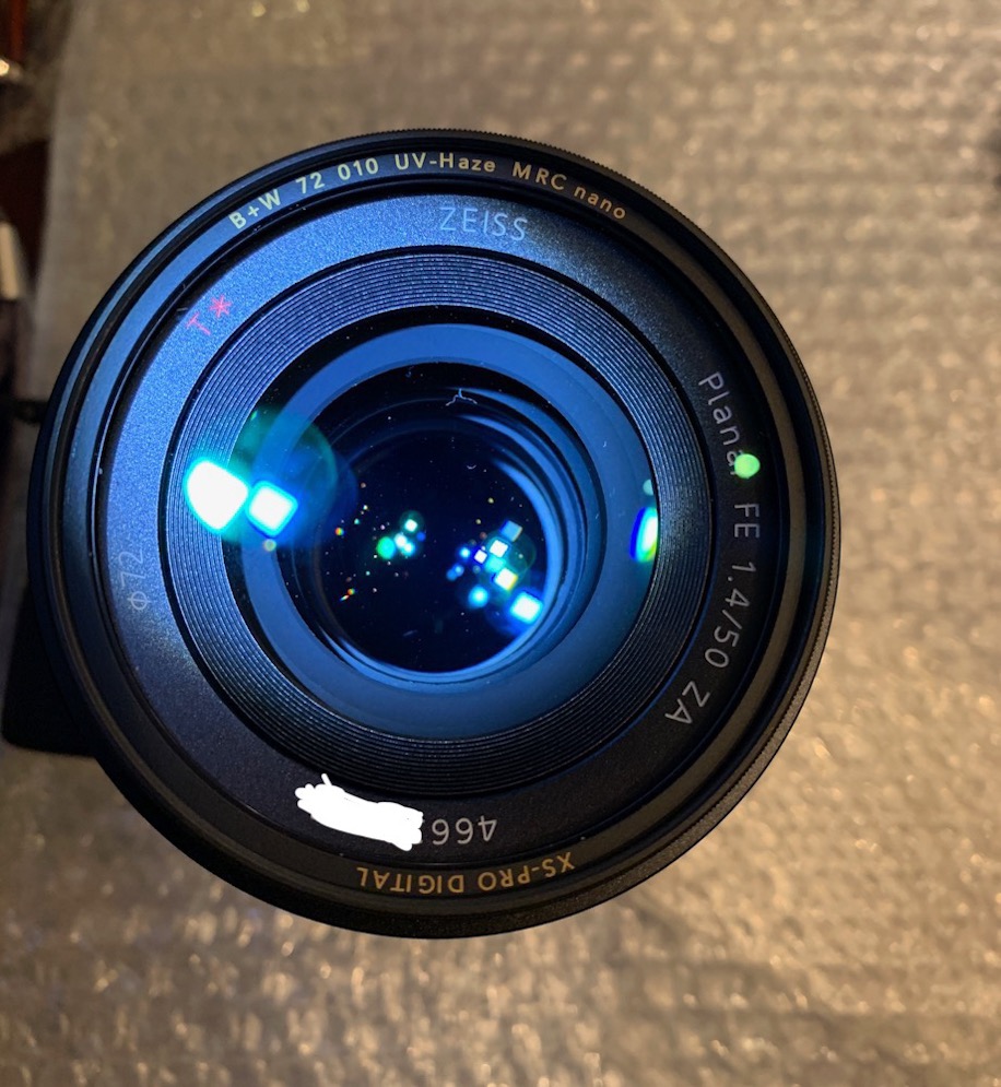

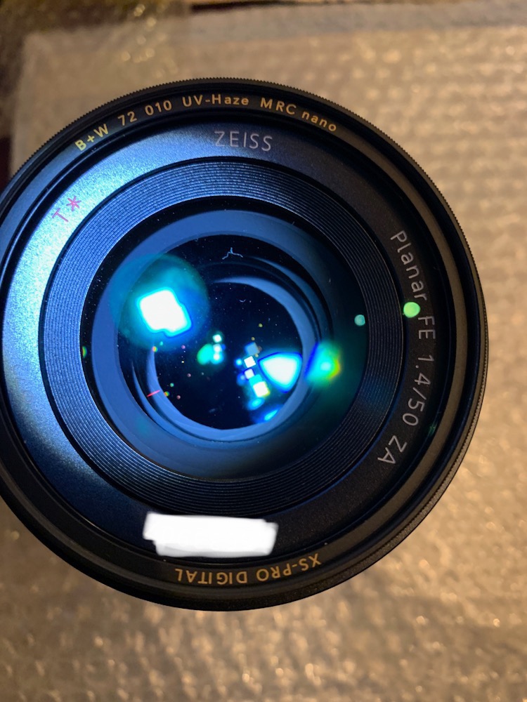

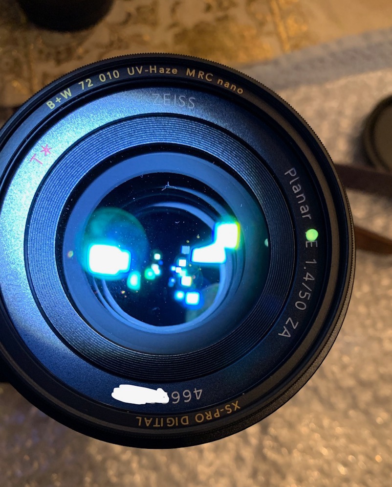

I recently tested the Sony 50/1.4 ZA Planar E-Mount and I noticed that when at f1.4 (wide open) the aperture automatically closes down when the lens is focused at minimum focus distance, 1 meter, 2 meter, and somewhat up till 3-4 meters. At longer distances and infinity, the aperture appears more open. Is this the same issue users experienced with the Zeiss Batis 40?
I tested this on an A7r3, in Aperture Priority MF and Manual Mode with MF. I saw when the Batis 40 performed in a similar manner, it was surprising to many forum users here. It seems like the Sony 50/1.4 ZA Planar behaves somewhat similarly. The light meter on the camera moves about 1 stop when changing focus from MFD to Infinity, and the shutter speed changes about 1 stop in Aperture Priority as well.
Great lens though, stunningly sharp.
See sequence of pictures below. Is this typical behavior with all Sony lenses or otherwise the A7r3?
MFD
1 meter
Infinity

I haven’t tested the bokeh, but I’m pretty sure it’s the aperture blades, as you can clearly see the blades physically move and tighten when you turn the focus ring from MFD to infinity while looking into the front of the lens. The pictures are taken from my iPhone but still pretty clearly show the condition.
Also, on the exact same Manual mode settings, the 85 GM does not exhibit this condition.
Also, the shutter speed changes on Aperture Priority. I face the camera at a wall about 3 inches away and turn the focus ring from MFD to infinity and the shutter speed changes from 1/125th to 1/160th (I think or faster I can’t remember). The light meter does change though from -1 to -1.3 in my test on Manual mode facing a wall.
I’m no expert though, let’s see what GM finds out and if Fred has a 50/1.4.
