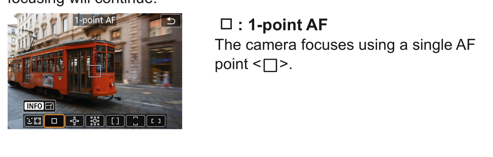

This is as small as it gets and you are correct in that it is too large for some subjects. The DSLR Canon single point is much smaller and of course Spot AF even more precise.
EDIT: May have spoke too soon...looks like there is a way to get a smaller point if in One-shot mode...see the second screen grab from the EOS R manual.
What I don't see is a picture showing how small it gets.

Would be great if some EOS R owners could take a shot of the rear-LCD with the regular smallest point in Servo compared to the small point setting available in One-shot. I'm curious to see how small it gets.

Here is a comparison of the normal AF point size and small AF point size in one shot. When you switch to servo you only have the option of normal size (the bigger one)
You can switch quickly between these sizes by hitting the info button on this particular screen (no need to go into menus).

Thanks, that clears it up...I'd say the small point is similar in size to a DSLR point on the current 61/65pt system.
