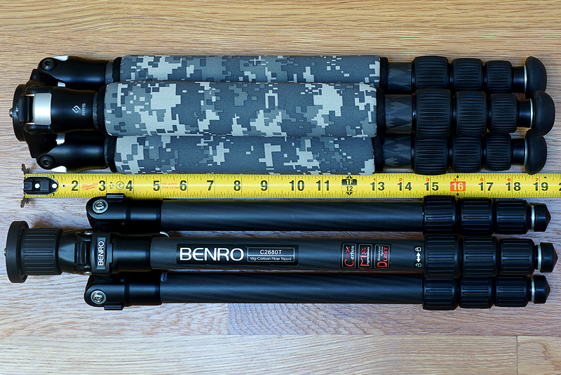

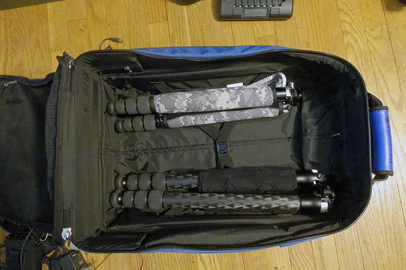

Here is a travel tripod that I am very familiar with: The Feisol 3442 weighs a little over 1Kg. I have made sharp exposures with ND filters lasting up to 5 minutes. The 3442 is offered with an optional center column but used without the center column it is high enough me at 6 ft. This tripod folds down allowing it to fit in a 22 in suitcase. We can go on discussing this tripod but there are many descriptions on-line. It represents the lower rung of high end tripods; it is good enough. You can rely on its stability and rigidity. If you plan to mount a 600 mm lens, you won't be satisfied; but up to 300 or 400 mm, it serves well as long as the wind is not too strong. Here is an example of 3 sec exposure made back in December at Hanalei Bay, HI.
