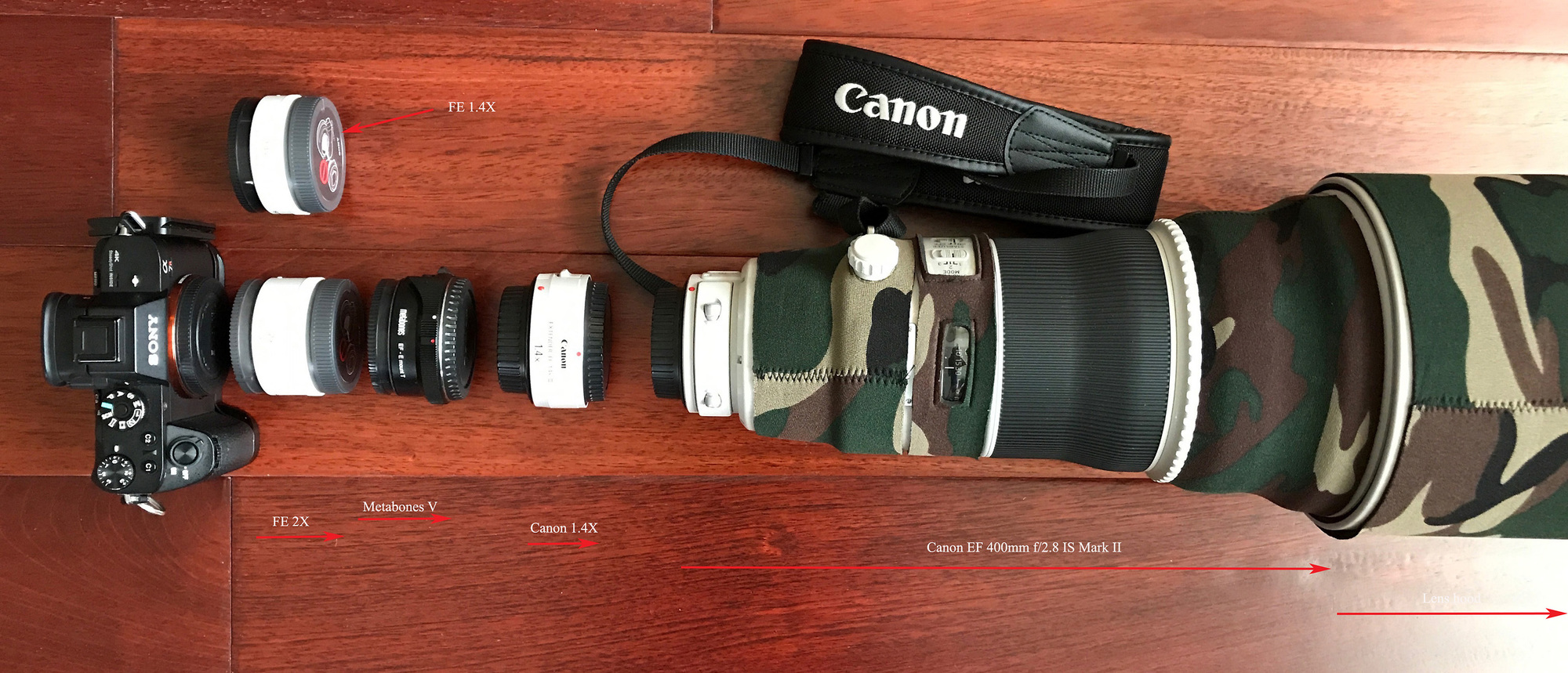

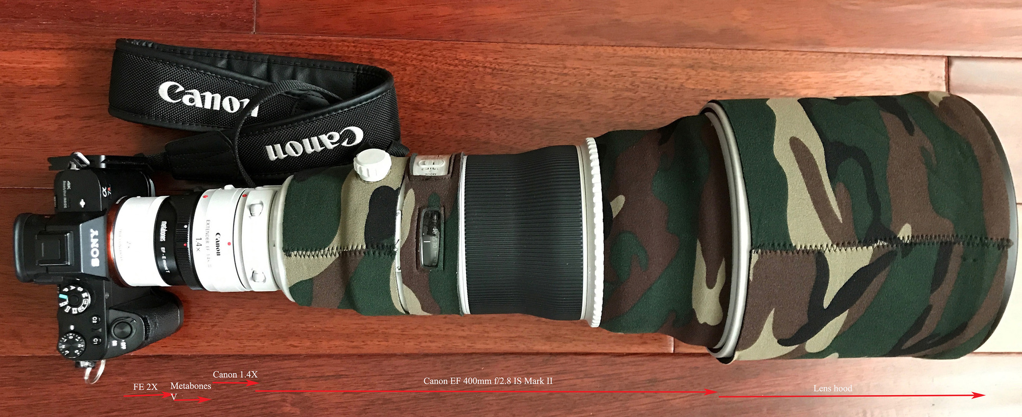

Here are 3 images taken of the setup using my iPad. I hope these help. Please let me know if you have any further questions. The total focal length of this is 1,120mm. I replaced the FE 2X with the FE 1.4X for the owl in flight image and the FL is 784mm. I could also remove the Canon 1.4X TC in the setup above and get a focal length of 800mm. The image quality between the two is virtually the same.
BTW, I do have a Canon 2X Mark III TC. Too bad, the AF doesn't work reliably any more. If you want to manually focus, it still works and again, the total FL would 1,600mm then.
Please note that the size of the FE 2X tele extender is approximately the same as that of the Canon 1.4X TC, just a tad thicker.

© AGeoJO 2017
Setup unmounted
Setup mounted together
...Show more
This picture made my day Joshua. That's another advantage for Sony when adapting Canon big whites. You can have extenders from Sony and Canon at the same time!
I will be the first to ask. Did you try the Sony 2x extender combined with Canon's 2x? Physically, it would be possible with your set-up.

Thank you, Fred! Yes, and Metabones V made it possible. Again, I am not related to Metabones in any shape or form. I edited my post to just address exactly what you meant. Physically, yes, I could actually use both 2X TC from both brands and I did try it out. The AF is kind of iffy though but the optical quality is OK. The longer you get, the less the light, the worse the AF and the IQ. At f/2.8, the Canon 400mm is the fastest lens and one can try the 500mm for longer reach but the aperture of that lens is "only" f/4. The same goes for the 600mm f/4 Mark II but I don't have that lens anymore. I am putting the Canon 2X TC for sale but I may have to withdraw that and use it if push comes to shove to get a FL of 1,600mm .
Frankly, the longer the lens, the more difficult it is to zero in on your target. With a 1,200mm FL lens, even if the bird is just perching on a branch you have to look for it. We can forget about tracking a bird in flight with that, even if the AF is enabled, let alone at 1,600mm . I can't do it, maybe some of the more skilled birder can but you need a nice gimbal head for that, too.

Thank you, Fred! Yes, and Metabones V made it possible. Again, I am not related to Metabones in any shape or form. I edited my post to just address exactly what you meant. Physically, yes, I could actually use both 2X TC from both brands and I did. The AF is kind of iffy though but the optical quality is OK. The longer you get, the less the light, the worse the AF and the IQ. At f/2.8, the Canon 400mm is the fastest lens and one can try the 500mm for longer reach but the aperture of that lens
...Show more
We would lose 4 stops of light but with your 400/2.8, the A9 should still focus at f/11.
1600mm f/11!

Yes, it was tough for the A7r II to pull it off. It struggled and most of the time it gave up. You are right, aperture-wise it wouldn't be any issue for the A9, sure! But we are talking about dealing with double the maximum FL that the FE 100-400mm GM can reach though. Again 1,600 instead of just 800mm. It remains to be seen, I guess. I will consider getting an A9 for a wildlife photography trip but more towards the end of the year. if there is a local A9 user, I can get together with him at the burrowing owls place this Sunday and find out. Anyone?
