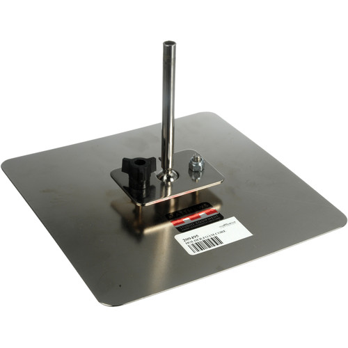

1              end
Archive 2017 · Anyone else shooting a Samyang/Rokinon 135 have this issue?
rico
p.2 #1 · Anyone else shooting a Samyang/Rokinon 135 have this issue?
A rear rectangular baffle as seen on high-grade lenses should serve. I'm not certain how it might be secured without falling backward into the mirror box and wrecking stuff, but you're welcome to try. I will proceed with my matte box because it will fix flare on some other problem glass I use.
Feb 15, 2017 at 09:19 PM
lbloom
p.2 #2 · Anyone else shooting a Samyang/Rokinon 135 have this issue?
A fine set up and test.
Feb 15, 2017 at 10:59 PM
elimoss
p.2 #3 · Anyone else shooting a Samyang/Rokinon 135 have this issue?
rico wrote:
A rear rectangular baffle as seen on high-grade lenses should serve. I'm not certain how it might be secured without falling backward into the mirror box and wrecking stuff, but you're welcome to try. I will proceed with my matte box because it will fix flare on some other problem glass I use.
Rico, where did you get the flat plate that you are attaching to the C-Stand? Is it custom?
I'm in Chicago, too. Nice use of the 1800 Maple Parking lot sign at Church St. Plaza as an example. I know it well.
Feb 22, 2018 at 04:05 PM
rico
p.2 #4 · Anyone else shooting a Samyang/Rokinon 135 have this issue?
elimoss wrote:
Rico, where did you get the flat plate that you are attaching to the C-Stand? Is it custom?
I'm in Chicago, too. Nice use of the 1800 Maple Parking lot sign at Church St. Plaza as an example. I know it well.
Greetings! I test lenses at infinity off the Metra platform in downtown Evanston where there are several urban views: nothing interesting unless I can catch a peregrine eating dinner. The plate is a Matthews foam core holder:
The idea is to tape the plate onto the back of some reflector material. I never actually deploy it in this way but, rather, as a support for gear and props. The ball joint is vaguely useful but unnecessary with a knuckle in the mix.
Ref:
https://www.bhphotovideo.com/c/product/32862-REG/Matthews_209495_Foam_Core_Holder.html
Feb 22, 2018 at 06:27 PM
elimoss
p.2 #5 · Anyone else shooting a Samyang/Rokinon 135 have this issue?
rico wrote:
Greetings! I test lenses at infinity off the Metra platform in downtown Evanston where there are several urban views: nothing interesting unless I can catch a peregrine eating dinner. The plate is a Matthews foam core holder:
Thank you so much, Rico!
Feb 23, 2018 at 12:09 PM
1              end
1              end
