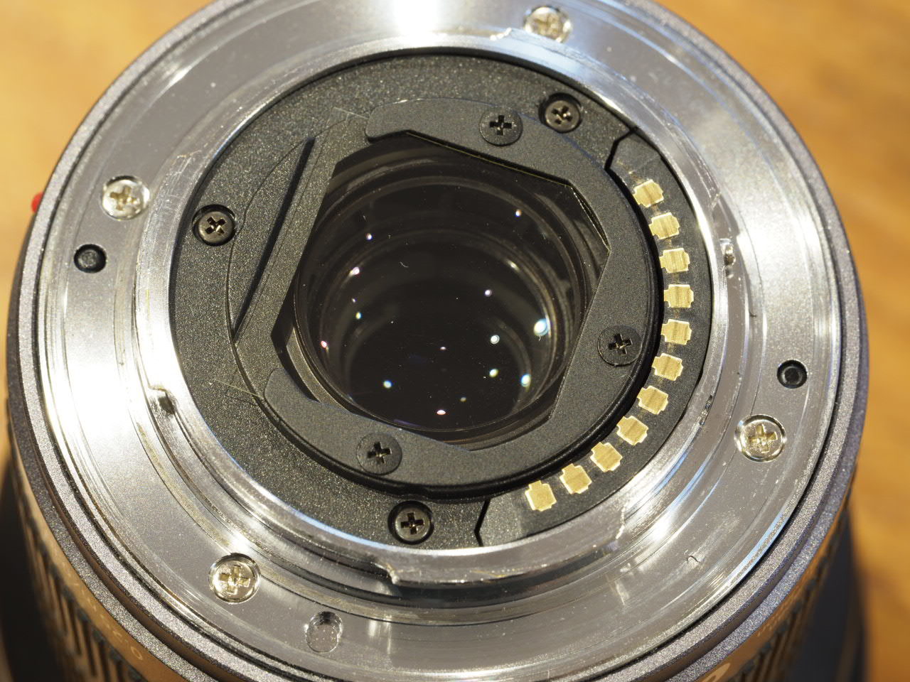

There is a work around, though a bit of a hassle. You can swap out the plastic back of the lens with the one from the Panasonic 8.5 fisheye so that you can mount a gel filter there. The appropriate UV cut filter will eliminate the effect on Olympus bodies by cutting out UV in a way similar to the filter stack in Panasonic bodies.

I have owned the Panasonic 7-14 since it came out and shot with it on multiple Panasonic and now Olympus bodies. As a landscape shooter, I ran into the purple flair issue only a couple times and solved it with the modification mentioned by kwash and a gel filter. No issues at all for me now.

This is the solution to the purple flair. It works. Get the rear filter holder for the Panasonic 8mm and it is a simple part to replace.
Panasonic 8mm rear filter holder on Panasonic 7-14mm
