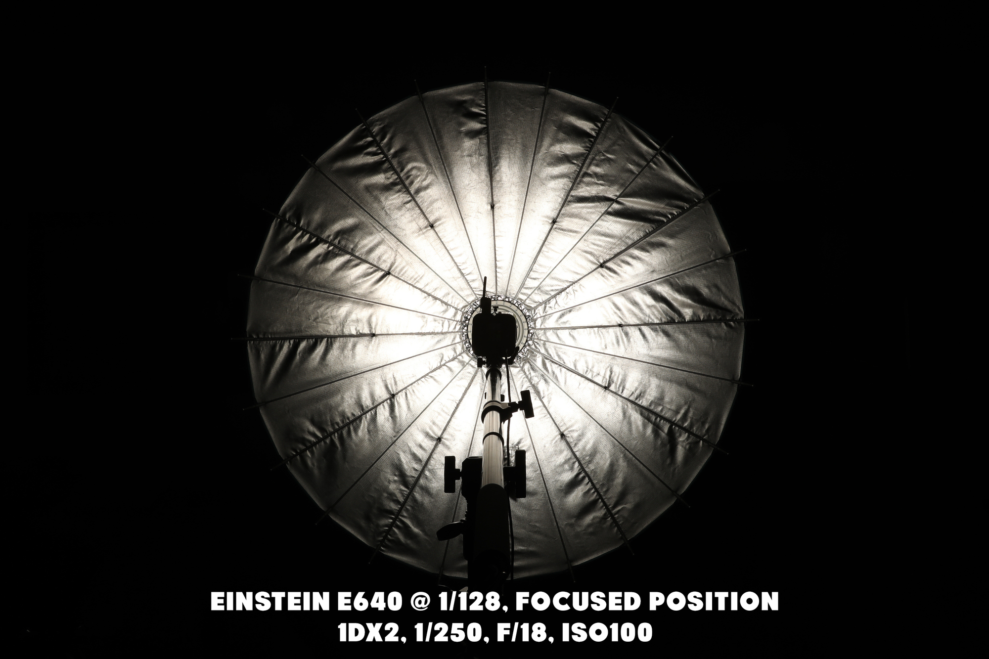

I have seen other people boom a D1 into a para, and it works as well -- I did it with my PCB ABR800 and einsteins in some testing I did, and it wasn't an issue and worked pretty well, actually.

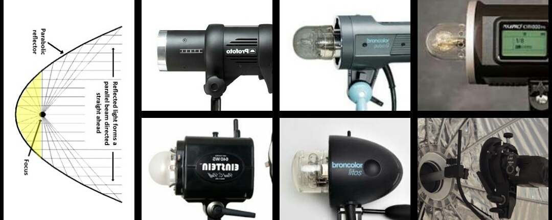

Deep parabolic needs more light to the side and to the back.
B1/D1 head is not for deep parabolic. Even Einstein. Einstein might be perfect for shallow parabolic like PCB PLM.
Deep para needs protruding head.

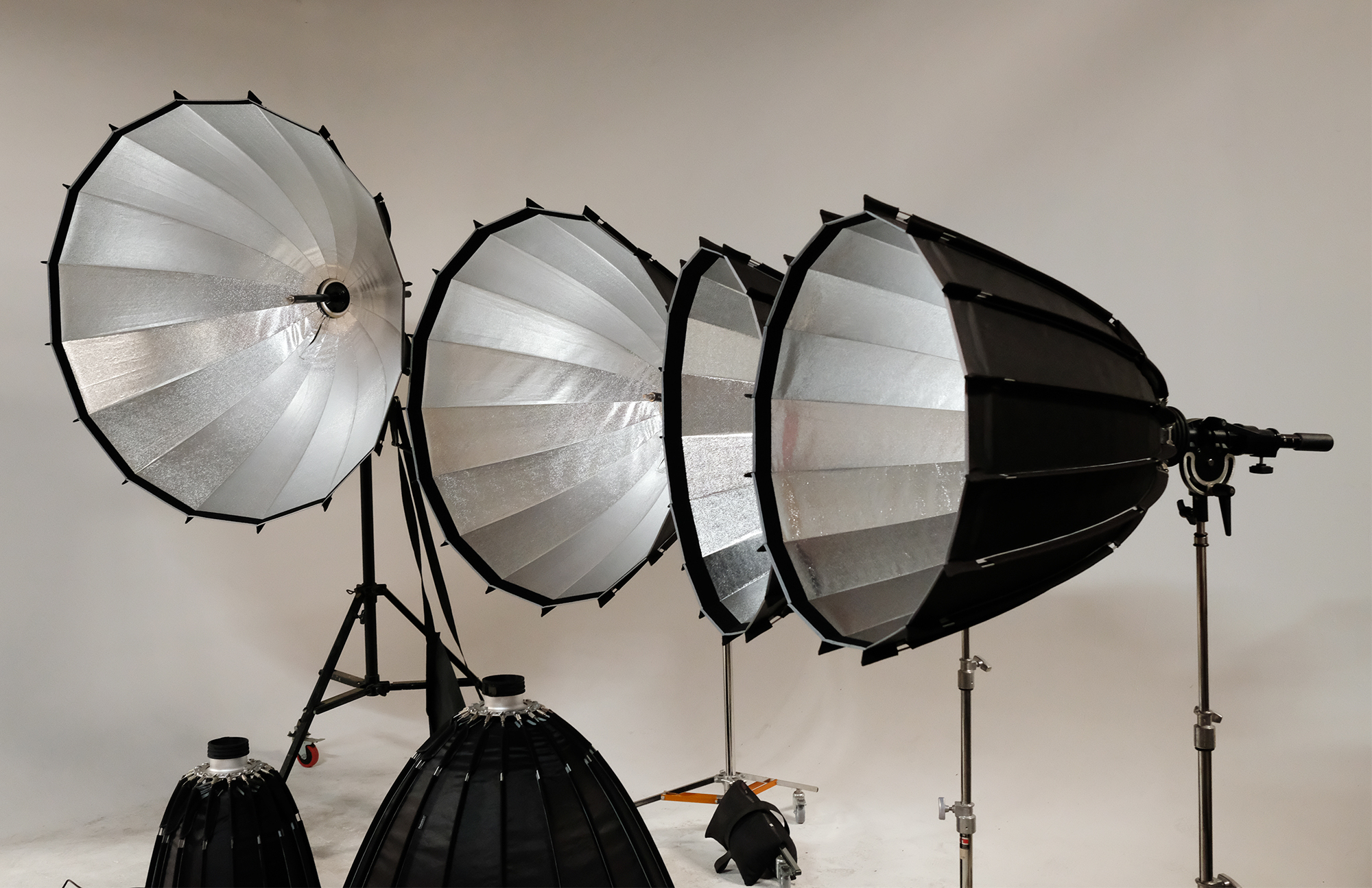

I myself use Godox AD360 on my para (bottom right)

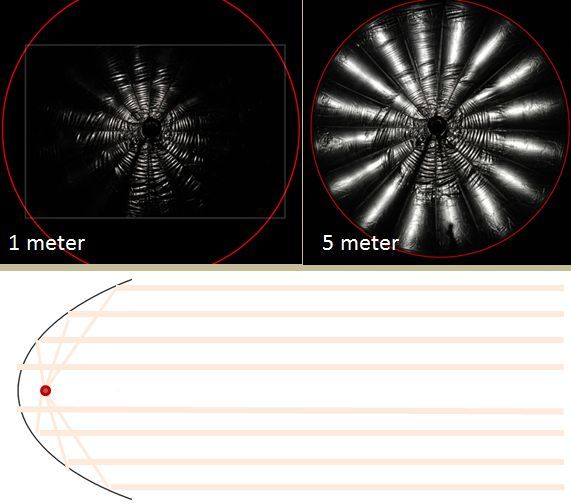

To test light pattern of the para we need to put the camera, or to the white wall (if we want to see it on the wall) as far as you can due to the paralel light comes out from the para.
