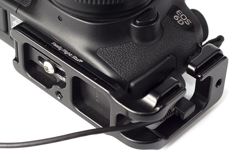

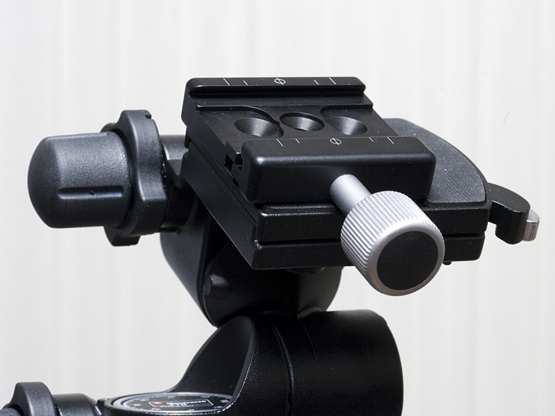

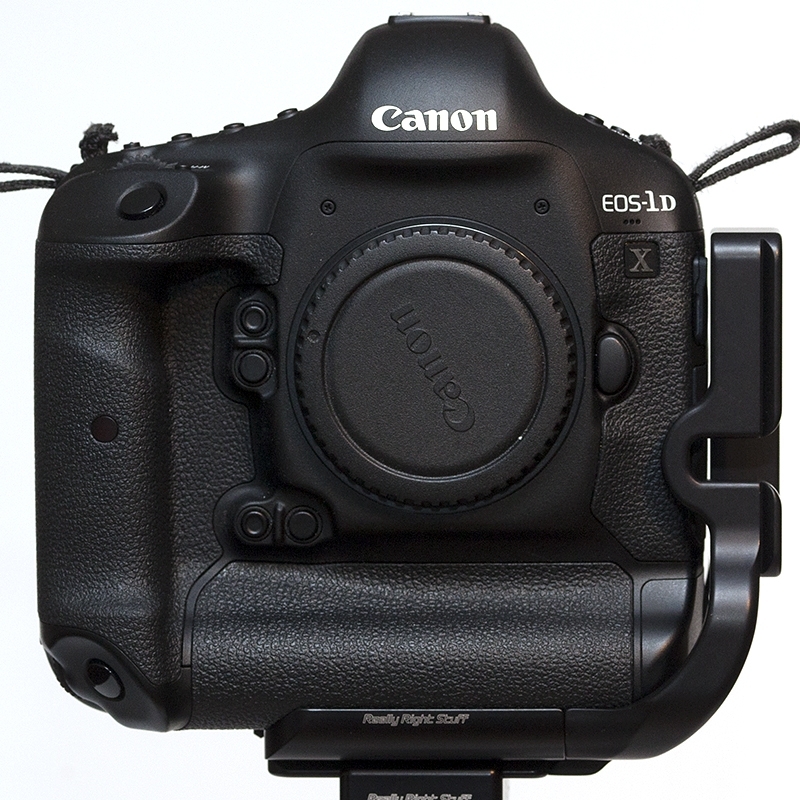

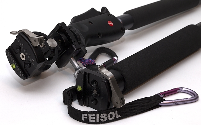

Here's some of my support gizmos.
© jcolwell 2016
Bottom oblique view of 6D with RRS L-bracket and mini USB cable

1DX on RRS L-bracket

Monopods with lever-release clamps

Manfrotto 410 geared head with screw-release clamp (on Hejnar RC4 adapter)
