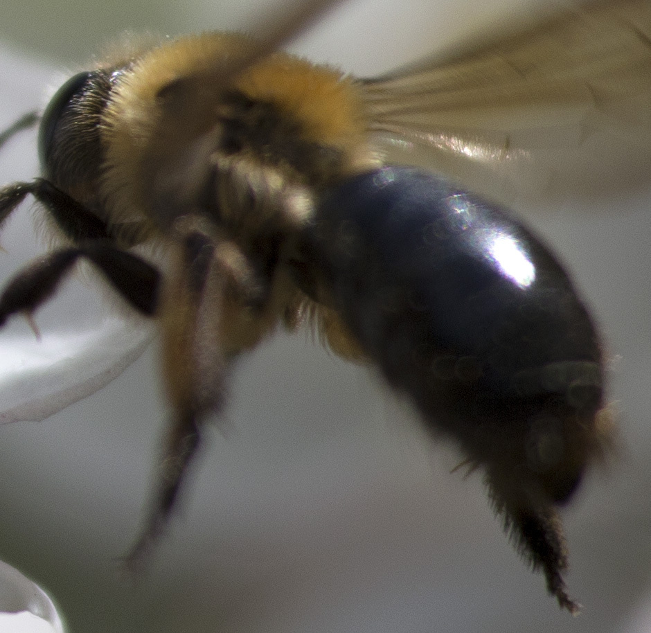

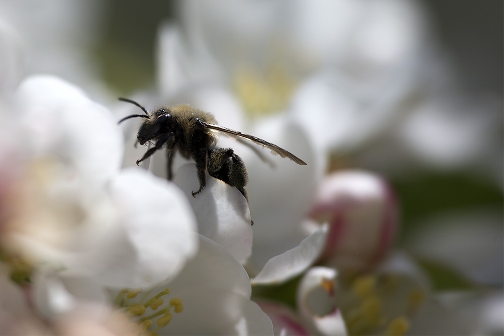

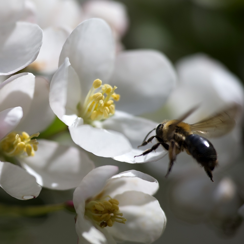

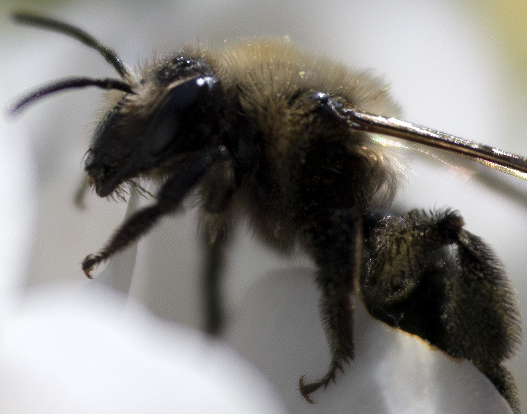

jcolwell
p.1 #6 · 500D - vs - Extension Tubes for a 100-400mm MkII
I often use the 500D close-up lens with my 100-400L IS II. It provides magnifications from [1:4.7] at 100mm to [1:1.3] at 400mm, for working distances of about 20" to 10". The magnification ratio of [1:1.3] is about half way between a "life size" [1:1] macro (mag. 1.0) and a "half size" [1:2] macro (mag. 0.5).
I use extension tubes to increase magnification with my bellows system and to reduce MFD for my 500/4L IS and 300/2.8L IS, but I don't like using them for handheld photography, because they reduce the light so much.
Here's two images from the series I posted in the Canon Spring 2016 thread,
https://www.fredmiranda.com/forum/topic/1417275/28#13594298
In each case, the full image is posted first, followed by a 100% crop from the same photo.
© jcolwell 2016
Full image
© jcolwell 2016
100% crop of image above
© jcolwell 2016
Full image
© jcolwell 2016
Jun 28, 2016 at 08:32 AM

shutterbug guy
p.1 #18 · 500D - vs - Extension Tubes for a 100-400mm MkII
My fail with the 500D was probably due to shooting very active bees, if the subject had been more static like a sleeping butterfly I'm sure the results would have been better.
jcolwell wrote:
I find it works just as well on the Mk II. The Mk II's shorter MFD allows you to get higher magnification, if required.
Jun 29, 2016 at 11:24 PM
jcolwell
p.1 #19 · 500D - vs - Extension Tubes for a 100-400mm MkII
The DOF is so shallow that it takes many OOF photos to get one that has the plane of focus in almost the right place. Thank goodness I'm not shooting film, whatever that was.
Jun 30, 2016 at 06:33 AM
