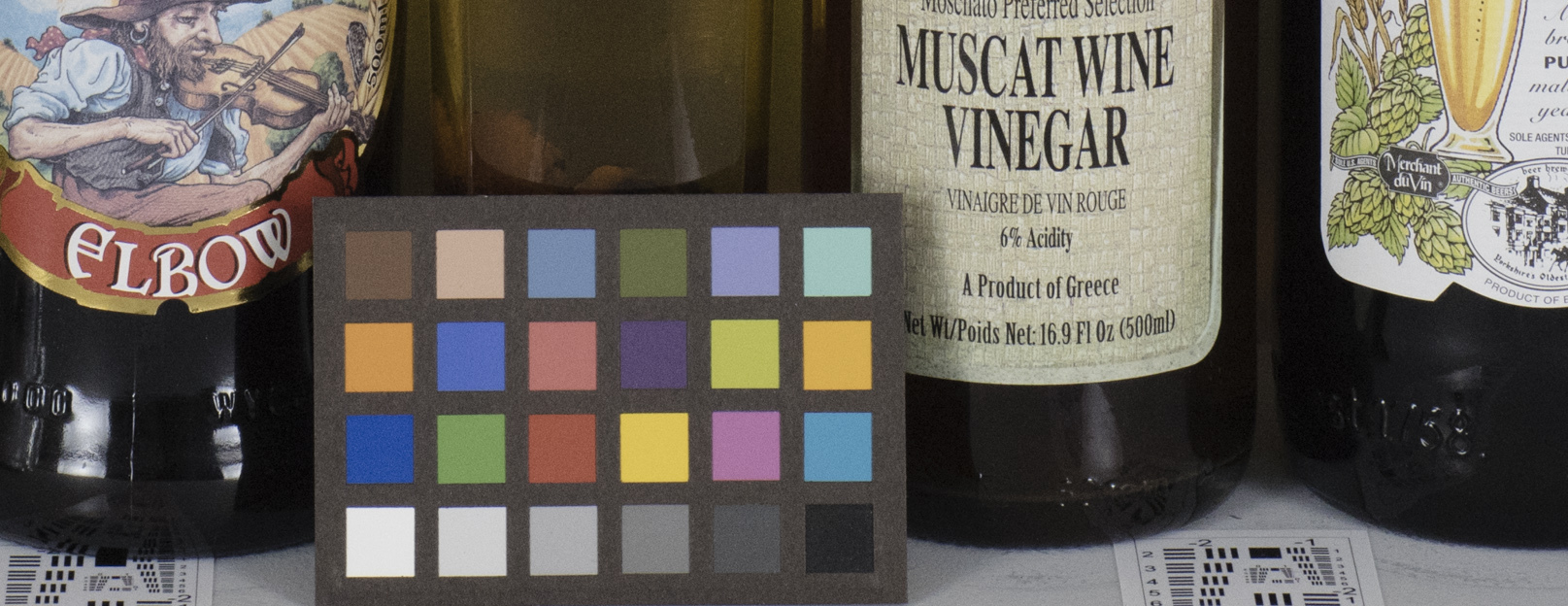

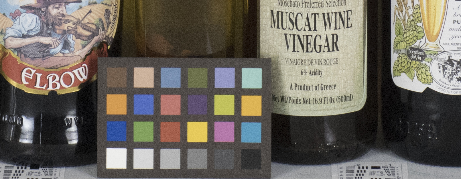

Go to imaging-resource, download studio RAWs from each camera at ISO 1600, process them the same as much as possible, resample 5DsR to 24.2MP
I did this for ISO 1600 and 5DsR is a bit better with finer noise. I made 100% crops from test scene for perusal. First two are 80D with defaults and then boosted contrast and sharpening, third is 5DsR. Note that the ACR profiles for 5DsR are very contrasty so I knocked contrast down 30 and added +10 to blacks,
