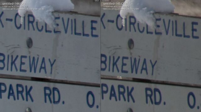

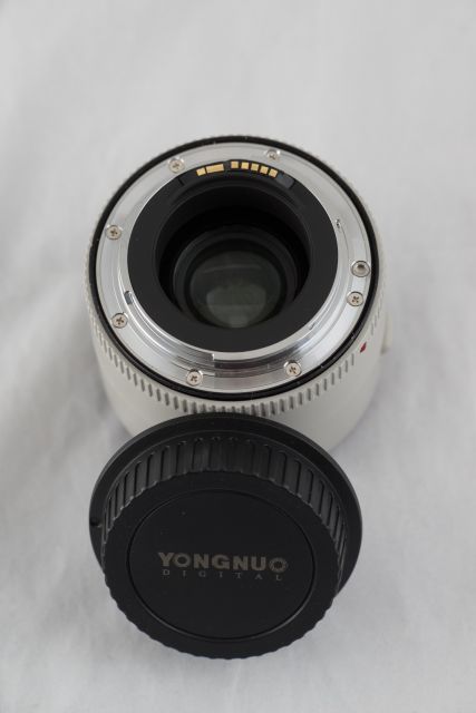

Many apologies for the delay, I know how annoying it can be when people flake out on stuff like this. In any case, without further ado, the results of my comparison between the Yongnuo 2x III and the Canon 2x Mk III.

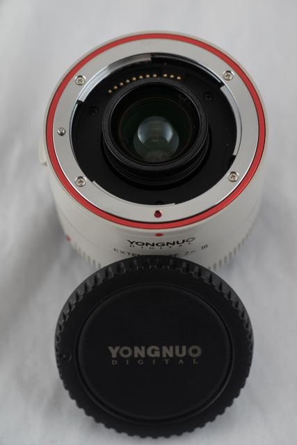

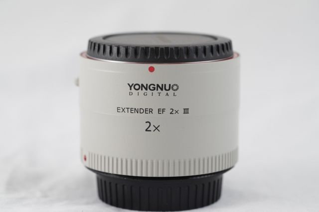

Build Quality
The extender seems reasonably well built and even includes a gasket on the lens mount side. It's easily distinguished from the Canon version by the red anodized ring on the front surface. The outer shell seems to be made of a cheaper plastic than the Canon (I couldn't tell if the Canon is actually plastic or metal) as you can feel it flex and shift much more than the genuine article.
Jan 29, 2015 at 11:50 PM
whumber
p.3 #3 · Yongnuo 2.0x TC

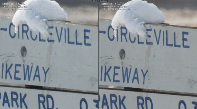

Center Performance

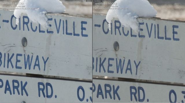

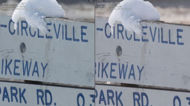

The 70-200ii is the only lens that I've tested this with as I don't normally shoot long focal lengths and this whole endeavor is really just a curiosity for me. The first copy of the teleconverter I received showed a bizarre behavior where it seemed to give great results while shooting test charts in my office, but once I took it outside and shot at longer subject distances the results were pretty terrible. I was able to get a second copy and I'm happy to say that the results are much better! I also was able to borrow a Canon 2x III although I only had it for a short time and so the comparison between the two is not exactly exhaustive.
The results shown below are all done with the 70-200ii mounted on a 5D3 @ 200mm (400mm with the 2x extender). I used live view autofocus for each shot with the focus point in the center for the center samples and the focus point moved to corner for the corner shots. All shots were tripod mounted with IS turned off. The light was changing quite a bit so the shutter speeds aren't all the same but I don't think it had any effect on the results. Results are shown for both the center and the corner at f/5.6, f/8, and f/11.
Center at f/5.6 : I can't really see any difference in sharpness here although maybe the YN has very slightly higher contrast.
Center at f/8 : I can't see any difference between the two.
Center at f/11 : Again, no difference.
Jan 30, 2015 at 12:06 AM
whumber
p.3 #4 · Yongnuo 2.0x TC

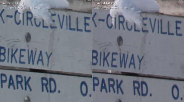

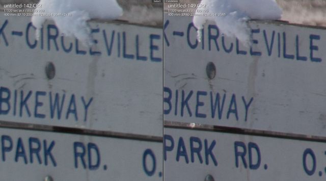

Corner Performance
Corner at f/5.6 : The Canon appears very slightly sharper with a bit less CA, but not much difference.
Corner at f/8 : By f/8, they appear the be equal to my eye.
Corner at f/11 : The Yongnuo seems to have sharpened up nicely but it seems like the Canon is actually getting softer as I stop down. Maybe field curvature issues or a mistake on my part?
Jan 30, 2015 at 12:09 AM
whumber
p.3 #5 · Yongnuo 2.0x TC
Autofocus Performance
The Yongnuo doesn't seem to completely report as a teleconverter as the focus speed doesn't slow down at all whereas the Canon shows a noticeable decrease in focus speed, even on my 1D bodies. Single AF seemed fine even without an AFMA. I tried doing a little BIF and the results were not great, but I think that's mostly due to my inexperience with that kind of shooting so take that with a huge grain of salt.
Conclusion
Yongnuo's first forays into optics (see also their 50 1.8 copy) seem to be pretty decent. I'm a little bit confused about the corner performance of the Canon 2X III as it seemed to get softer when stopping down and the only thing I can think of is that there's either some field curvature issue or I made some gross error in my setup. In any case, the performance of the Yongnuo seems really good for 38% of the cost of the Canon, although I'm not sure how good the AF is and I really doubt I would trust the weather sealing. Please ask questions if there's anything I've missed that you would like to know and I'll answer if I can.
Jan 30, 2015 at 12:20 AM
