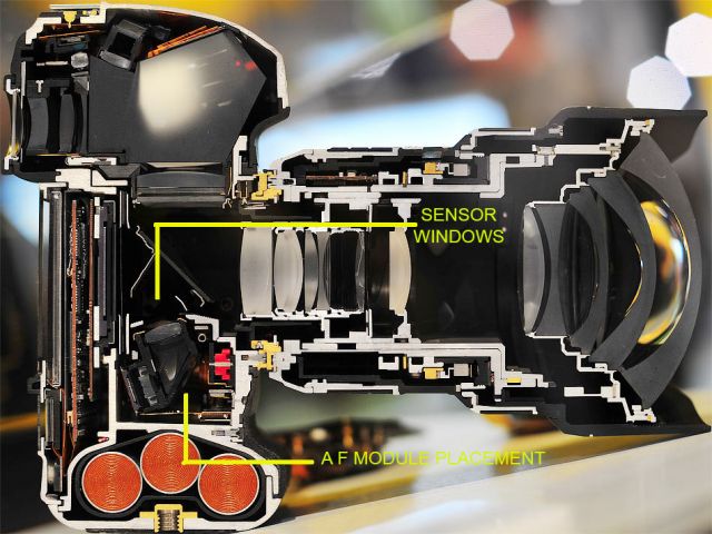

Just for future reference in case people don't know where a Nikon AF module is located, here is a cut-a-way of a typical Nikon body showing the lower AF module location and the sensor windows located just behind the mirror itself.
One should lift the mirror when attempting this fix to blow free anything on the sensor. I have, on occasion needed to take a camel hair brush to this array and then followed up by a 3rd & 4th blowing out. Making sure that NO HAIRS get left behind.
Check that cut-a-way of this 14-24 here... Doesn't that make ya feel funny looking at the cross cut of those elements?
Just freek'in awesome that lens !

Blowing with Rocket Blower, mirror up, holding camera body face down (in case there's something falls, it'll fall outside). Be careful not to touch anything with the blower. I have done this numerous times, didn't seem to hurt anything.
Just don't use compressed / canned air!

Also, you know you can simply turn the camera off, and gently lift the mirror from the leading edge with your finger....this also reveals the secondary mirror which directs light to the AF module, which can also get a little dust on it...that's how I've blown mine in the past...
