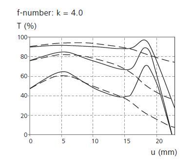

p.1 #6 · Testing the ZM C Sonnar 50 1.5 & 3 other lenses
Thanks for these well-prepared images, they illustrate so much about the need for good corner MTF in lenses for the a7r, if corner resolution is needed or wanted.
I can provide a long answer, it is tedious for lay observers, but the short answer is this: this lens, the C Sonnar has very poor long edge/corner performance, consisting of strong sag data and very low tan data. Wide open both are low and very low contrast with good shaping results.
At f5.6 sag data has skyrocketed over 60% tan is still around 20%. The result is rampant CA in a radial direction, good contrast radially but very poor contrast tengentially. Compare and contrast the Canon FD image crop immediately below this one. See how branches look equally good in both directions?
Now here is the relevant MTF chart for the C Sonnar ZM:
http://lenses.zeiss.com/content/dam/Photography/new/pdf/en/downloadcenter/datasheets_zm/csonnar_1-5_50_zm_en.pdf
You can read my comments and see the chart reflects them - f4 in the chart is close enough to f5.6 for this exercise.
Zeiss will tell you to look for flat near to parallel lines or slowly declining lines in MTF charts if you desire good image object shaping and low CA, quite the opposite of what the C Sonnar shows us. Of course it is not ideal as an all of frame landscape lens but has other fine attributes, which I thank you for pointing out and showing here. It's a fast lens and like so many of them designed for wide open work.

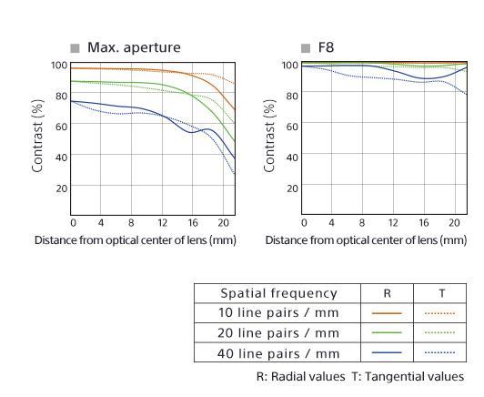

Brian, thanks for that information. Zeiss are now seemingly treating their fine lens titles as marketing tools, sad but true.
I am presuming you are referring to the C Sonnar 1.5/50 in your main para. I thought readers might like to see what the talk is about. Here are lens design schema for the C Sonnar 1.5/50 and the FE 1.8/55 along with Zeiss own (measured at infinity) optical bench actual lens data for the C Sonnar at f4 and the 'calculated' MTF for the FE 1.8/55.
The bottom scale shows in mms the image height - distance away from the image centre; the left side scale is percentage of contrast - more is better. The take home message is that calculated MTF is a probably reliable guide to the profile of lens performance, but is optimistic by an unknown degree, perhaps by around 5-10% for the lower spatial frequencies (5 lpmm and 10 lpmm) and by 20% for the higher spatial frequencies - 40 lpmm. That is an 'educated guess'. These are still useful because they indicate the general behaviour of the lens.
Obviously designs are very different, and as you say the C Sonnar is close to the appearance of a traditional 'real' Sonnar. The FE 1.8/55 is something again...Maybe Zeiss can start new names for new designs they feel have passed the test. Perhaps they are making what is needed on a case-by-case basis though; who knows?
The MTF data chart for the C Sonnar 1.5/50 shows the huge departure from ideal from image height (IH) of 16mm to the very corner of 21mm. This is the fly in the ointment described in my above post.
The MTF data chart for the FE 1.8/55, in the left side 'Max. Aperture' diagram shows the ideal characteristics of near to parallel gently declining line pairs. We look at this kind of chart with great satisfaction, as it indicates very good handling of aberrations across the board, with very little curvature of field (no rapid departure from steady decline) and excellent and high data across the entire frame. You can see performance is high from image centre and stays at that level almost to the long edge at IH of 18mm.
The main point I wish to make is that the main issue is that the *shape of the lines as they move across the frame strongly influences perceived performance* and perceived image quality. It does not hurt that the new FE no doubt has very high measured MTF, from early on in the aperture range, say f2.8. The great additional benefit is it is still very good indeed at f11.

C Sonnar 1.5/50mm - Zeiss Actual Lens MTF at f4
FE 1.8/55 - Sony Calculated MTF at f1.8 and f8
