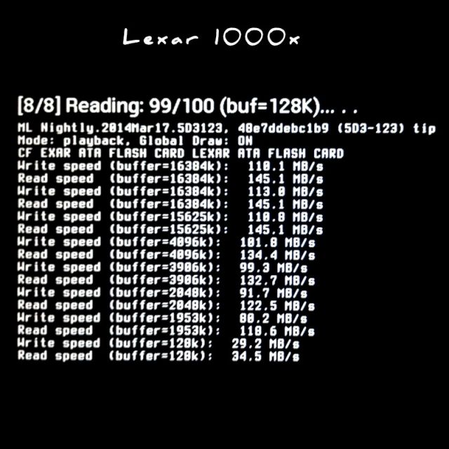

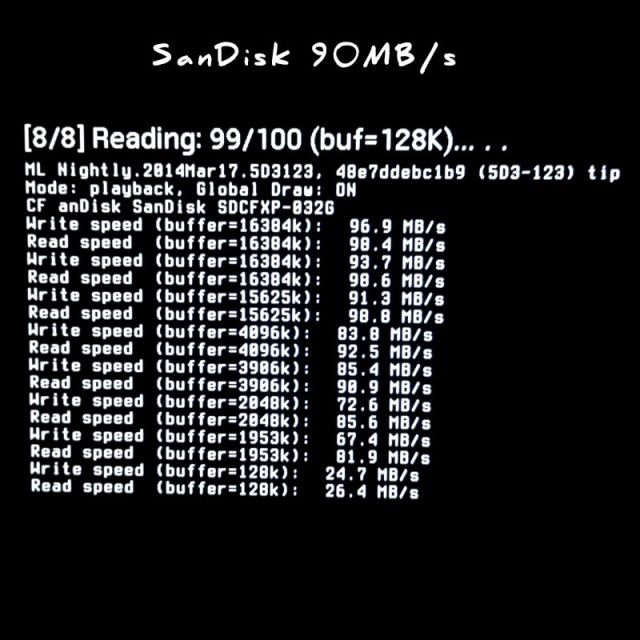

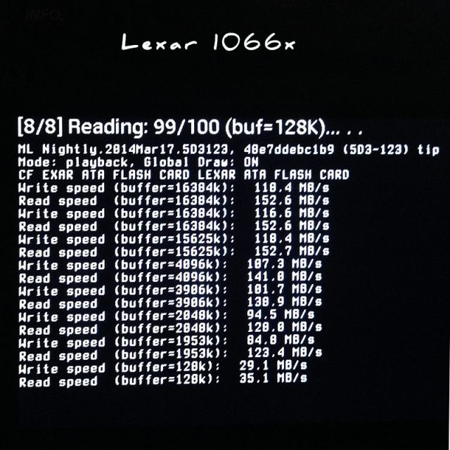

Just a little bit different view on the speed of Lexar 1066x cards...
I've got a 64GB 2-pack on Amazon (which are on sale right now http://www.amazon.com/gp/product/B00IQCRTXU/ ) and I run a Magic Lantern speed test on my 5DIII using 3 different cards: Lexar 1066x 64GB, Lexar 1000x 32GB and SanDisk 32GB 90MB/s. Test was run 4 times for each card and I'm posting a screen shot of the best result for each card:

A little is right. The results are as expected based on the previously reported data.
I'm curious if there is any real difference between the Lexar 1066x and the latest SanDisk 160MB/s cards.
