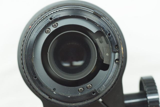

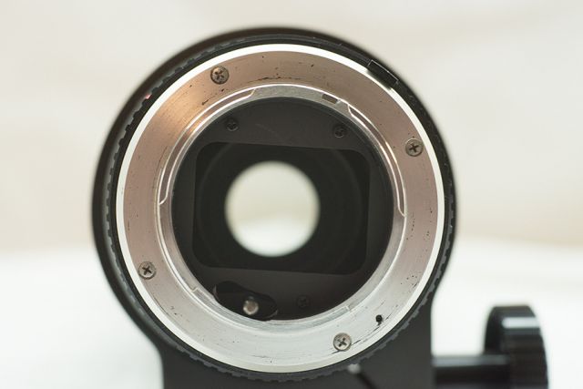

i can probably tell you how easy it will be to convert to sony alpha mount if you send me a picture of the mount. i can definitely tell you if you remove the mount for the picture.
You are the man. I'll shoot them over lunch tomorrow.

Good news, though. Whatever those spots were, they were apparently on the back of the rear element, because they're gone now after I got in there with a blower and microfiber.

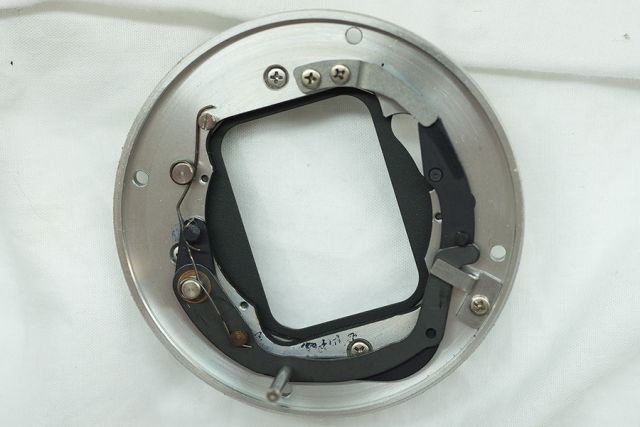

looks like it's got the same ridiculously over engineered lever system on the mount as my 135/2.8.
conversion should be relatively easy, just add a spring or rubber band to the on lens piece that would normally connect to the on mount lever contraption in order to make the aperture open close properly and stick a lever free new mount on (probably need to add a little ring to keep the aperture ring from wiggling too much as well).
the hardest part is probably finding that new mount. i wouldn't trust any of the typical m42 to alpha adapters to function as the mount for such a heavy lens. you'll want a thicker chromed brass mount. there might be something that would do the trick from leitax though it would probably have improperly placed screw holes already on it...
...Show more
Oh, good. I'm not the only one, then. When I pulled the mount off and looked under it, all I could think was, "Whose bright idea was this?"
Thanks for looking at it! I'll hunt for a new mount. I've got a secret handshake with broken AF and a stuck zoom. I wonder if it could be a donor.
you should try removing the mount on your 17/4 or 28/2 if you want to see something ridiculous.
what's the secret handshake? i can never keep track of the alpha mount nicknames.
the leitax contax to alpha mount looks promising, but i have a feeling the diameter between the screw holes doesn't match up, so you'd have a mount with 4 unused holes.
Now I get the feeling that a bunch of spring-loaded crap is going to fly out at me if I do remove them, so I'll pass.
Secret handshake is the 28-135. I'm not entirely sure where I picked it up, but I'm pretty sure it was for a situation like this.
Which Contax mount are you thinking? I wonder if David could come up with something if I just sent him the mount. I guess that would depend on how much I'm willing to pay for, "I need this in Alpha and .88mm thinner."
probably nothing will shoot out at you, it's a convoluted process just to successfully remove the mount though and even more levers and springs come with it (also the whole aperture ring).
i was looking at the first one shown on the contax to alpha page:
http://www.leitax.com/images/bayoneta-Contax-Sony.jpg
having something specially machined is always the best solution, i'm guessing david would charge a lot more for a one-off though even though it would be comparatively simple compared to many of his mounts. i doubt making it .88mm thinner would be that important by the way since the lens probably focuses past infinity that much already? there's probably an infinity adjust somewhere too.

Yeah, they're not coming off now.
Okay, we will call the Contax "Plan B". Redrilling holes I can do. I don't see leaving the others empty as a big deal, do you? It's not like there's not already a big gaping hole in the back anyway and no worries about light leaks since they'll be up against the camera mount.
