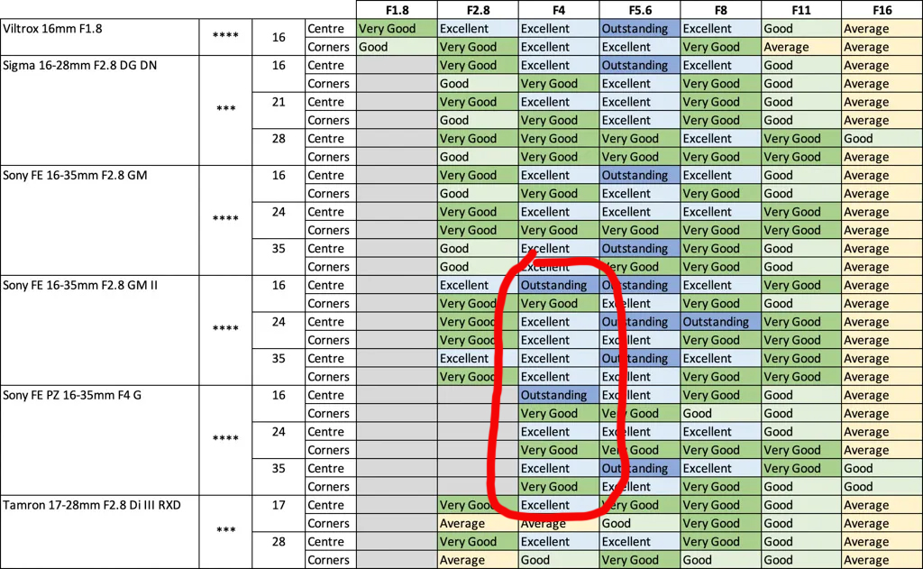

I moved from the Sony Zeiss 16-35mm f4, to the GM 16-35mm ff2.8 to the PZ 16-35mm f4, then, finally, to the GM 16-35mm f2.8 II.
I mostly agree that, at f4 the PZ and GM II lenses are quite similar in terms of sharpness. At 35mm, f4, however, my GM II is noticeably sharper - particularly in the outer frame. When shooting on the A7R5, I often crop 35mm, so I find the difference noticeable. Also, the distortions on the PZ lens are fairly wild; and, camera corrections do create a bit of pixel-level degradation, mostly seen in the outer frame... admittedly only noticed by a few technical perfectionists, like myself.
While I found the PZ lens to be mostly outstanding, I never warmed-up to not having the FL's on the lens barrel and I really missed f2.8 for interiors and evening shooting.
Lens performance table from SonyAlpha.blog
Edited on Jun 06, 2024 at 12:13 PM · View previous versions
