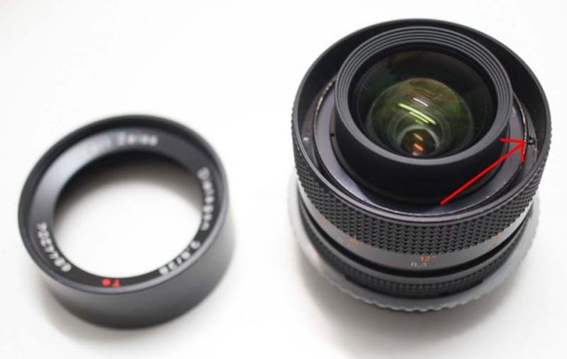

shirozina
p.1 #5 · DIY infinity adjustment on 1st gen Elmarit 28mm
The lens elements stay put - this picture shows what should happen and I've arrowed one of the screws.

s23chang
p.1 #6 · DIY infinity adjustment on 1st gen Elmarit 28mm
Thx for the photo. I don't own any Contax mount lens but it is interesting to see that it looks identical to my Flektogon 20mm 2.8 lens from the 60s.

shirozina
p.1 #7 · DIY infinity adjustment on 1st gen Elmarit 28mm
They are also very similar to my Hassleblad lenses externaly - but quite different internaly.

StevenPA
p.1 #8 · DIY infinity adjustment on 1st gen Elmarit 28mm
Aha, I think I would have needed the pic to understand. Thanks, it's something to keep as a reference for the future.
