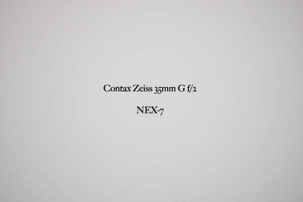

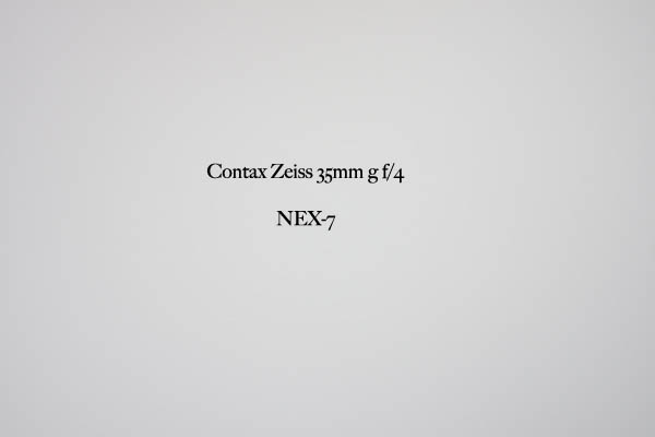

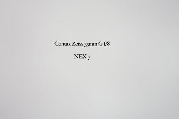

First, the white tissue test:
Very little vignetting or color shift, apparent at f/2. The real-world shots look fine.

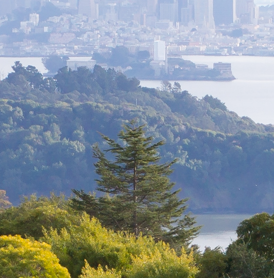

Next, the full frame test shot at f/8:
Here are 100% crops from the frame center at f/2, f/2.8, f/4, f/5.6, and f/8:

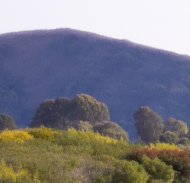

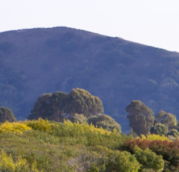

The frame center looks pretty good to me from f/2.8 or certainly f/4 for most purposes. However, the corners and edges are pretty soft up to f/4, or even f/5.6, depending on your needs. Here are 100% crops from the upper left edge at f/2, f/2.8, f/4, f/5.6, and f/8:
Overall, I\'m happy with the performance, since I tend to shoot this FL at f/5.6 or f/8. Unfortunately, I haven\'t shot this lens on any other camera, so I can\'t say how sharp it should be.
