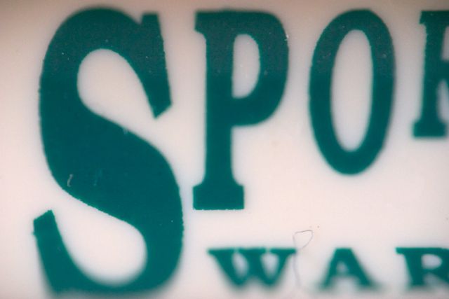

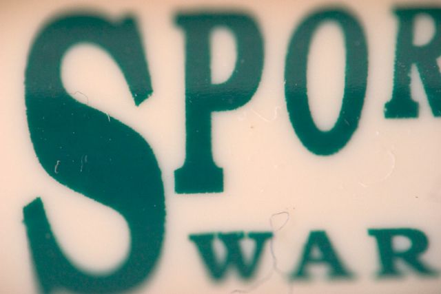

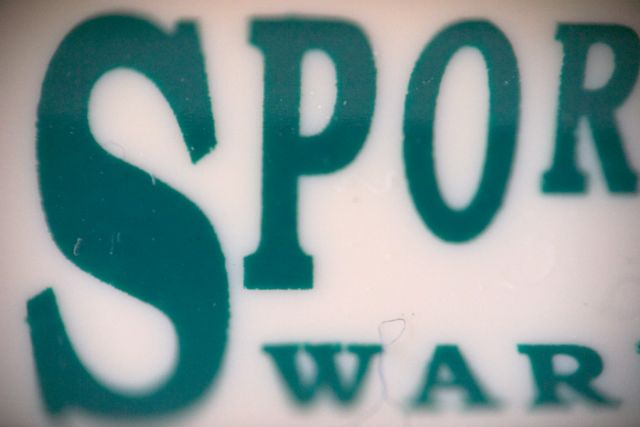

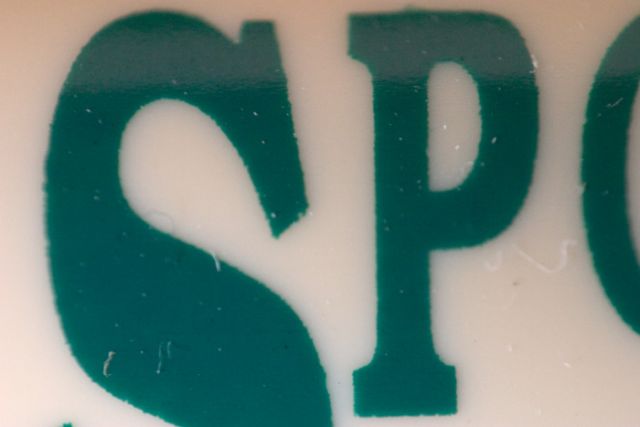

Hump Day and nothing to do. So I played. Canon 1D (1.3 crop) 100mm macro, + 500D, + Nikkor 50mm f2, + Canon EF 24mm f2.8.
Straight 100mm Macro set to 1:1, 1/100 @ f5.0
http://www.canelabistro.com/images/670D9386.jpg
100mm Macro + 500D
http://www.canelabistro.com/images/670D9385.jpg
100mm Macro + Reversed Nikkor 50mm
http://www.canelabistro.com/images/670D9384.jpg
100 mm Macro + Reversed canon ef 24mm
http://www.canelabistro.com/images/670D9383.jpg
I will appologise for the narrow depth of feild, I also tried to center the ruler at the 3 to 4 scale of the .50th inch side of the ruler (oops I should have flipped it over and used the centimeter side) . I have yet to do the math, it is 8:40 pm and my days normally start around 5:00 am here. So the math will have to wait a day.

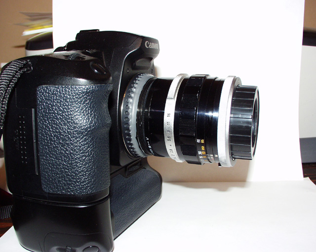

Very interesting thread and most informative. Many thanks to all the posters. Brian has already advised me of the value of extension tubes and I'm tweaking my budget to buy the 3 tube set from Kenko.
In the meantime, I'm intrigued by the possibilities of lens reversing. I have a Tamron 90mm I'm using with my XTi. Buying a reversing adapter to fit a Canon EF 50mm 1:1.8 II lens on the XTi seems pointless, since I already have the Tamrom 90mm. Is that true?
However; using a 52mm reversing ring to mount the Canon EF 50mm on the Tamrom 90mm seems like a plan. I'm guessing that would produce a magnification a little less than 3:1. Is my thinking correct?
Also, I have a Canon EF 70-300mm 1:4 - 5.6 IS USM lens. I could mount the Canon EF 50mm on it using a 58/52mm reversing ring. I'm unable to figure the math as to what magnification that would produce.There might be some vignetting and the IS may not work, but that's fine. Will that plan work?
Perhaps neither plan will work. I'm thinking the minimal cost of two reversing rings would be well worth it, if it's doable. All comments would be appreciated.

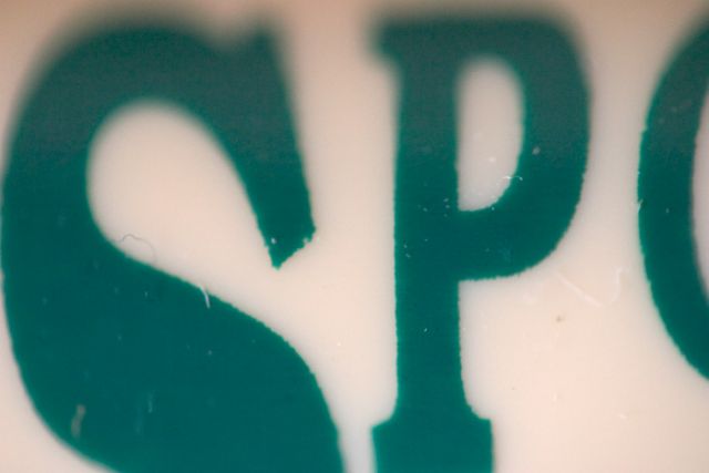

restating my earlier question:
When using a lens as an extension tube, i get great results. I have been, with brian's prior advice, able to reverse mount a Nikon f/1.8D 50mm on my Sigma 150mm macro lens. Having come from using a Tamron 90mm, wow, the learning curve is tougher than i would have thought it would be.
Anyway, my question:
Should my Sigma 150 be set at 1:1 or at infinity focus? I have done some rough tests, but infinity focus does not seem to give the same level of magnification as setting it 1:1 and it seems to cause a bit of additional vignetting.
Thanks all you great people!
examples this time:
at infinity focus:
_JMB1120
at 1:1 focus:
_JMB1121
these are not great images, they are just here for informational purposes
Jan 11, 2008 at 11:05 AM

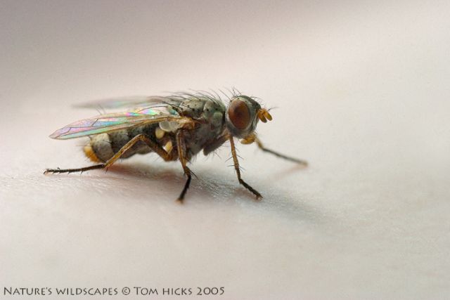

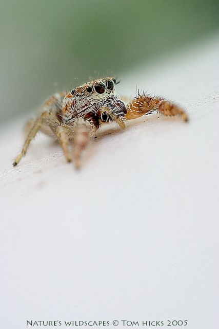

Tom Hicks wrote:
Yes, and taking in account the crop of the camera 3 to1
Ok let me try and explain. I will post some sample shots .

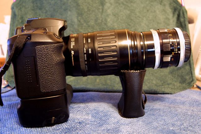

This first image is shot with a 100-300 lens with the 50mm on front. The 100-300 lens is set at it min focus distance, 50 set at 1.4 and infinity , 100-300 set at f8 and is at 100mm EXIF intact.
Jan 11, 2008 at 04:55 PM
Tom Hicks
p.3 #20 · Reverse mounting info. Topic Name Change.
The next image is set up the same except a 100mm macro lens was used and the focus was set at min . Note the increase in image size.
Jan 11, 2008 at 04:57 PM
