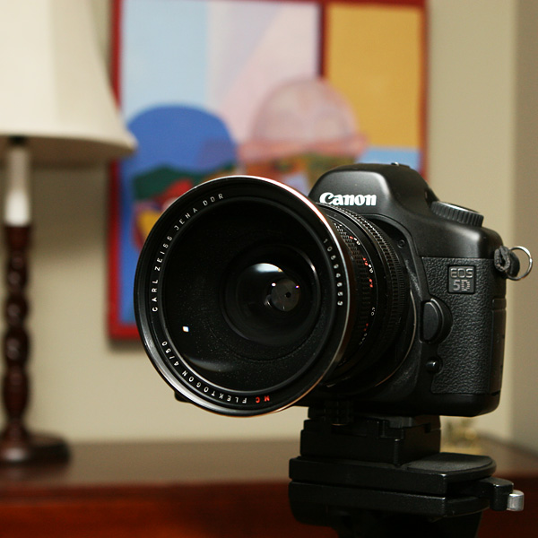

I'm starting to use a few Pentacon 6 and other MF lenses on my 5D. Here's a photo of a Pentacon 6 Carl Zeiss Jena Flektogon MC 50mm f/4 on an EOS 5D (it's a big lens, 86mm front filter thread). I also posted some comments and photos on a Pentacon 6 tilt adapter and a Mamiya 645 shift adapter on the thread Medium format to EF mount t/s adapter?.
The lens in this photo is shifted 11mm upwards using a P6 to M645 adapter on a M645 to EOS Shift adapter.
