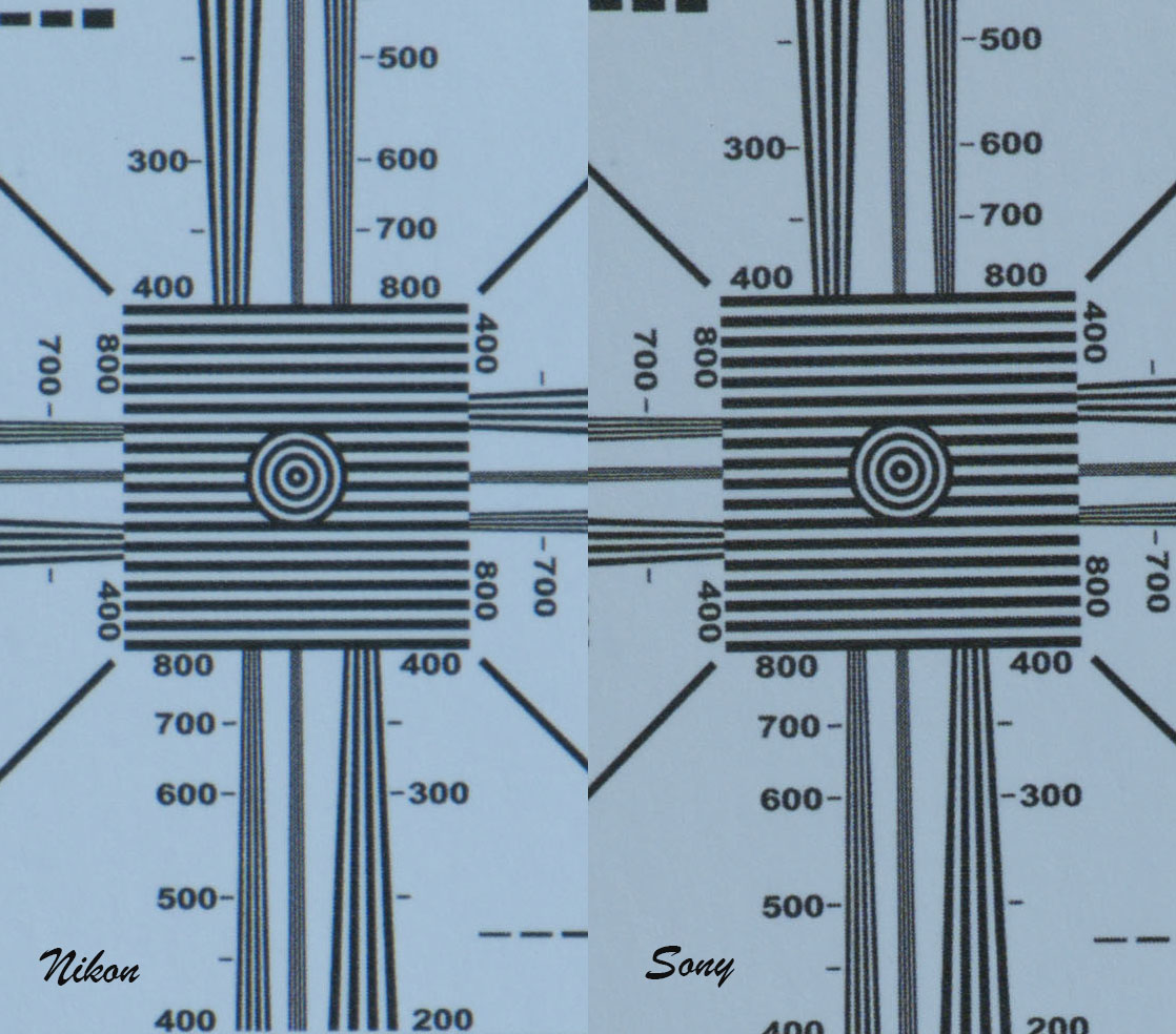

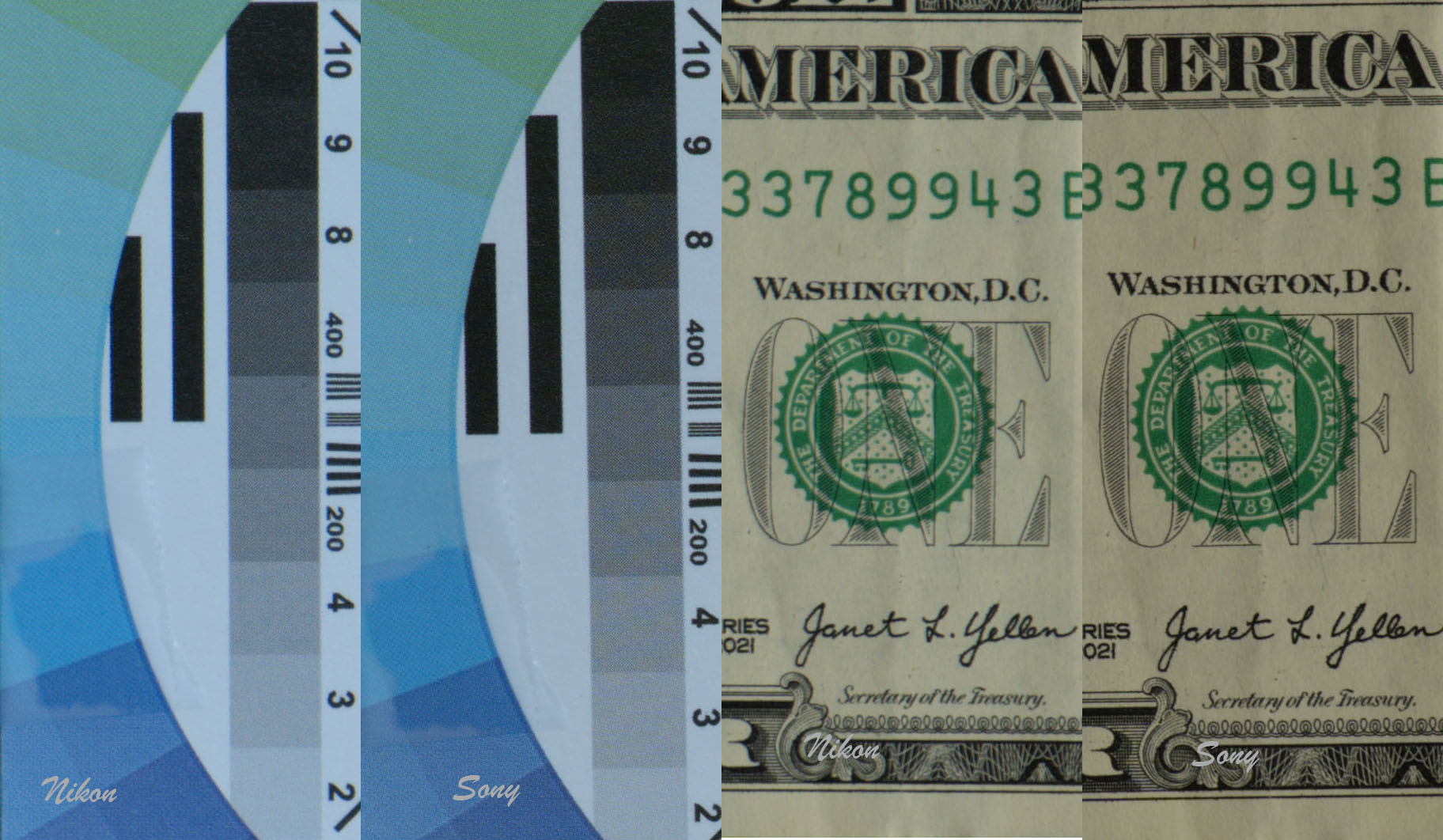

Interesting results. I did similar comparison (on Z8 with megadap). I've used two different copies of Nikon 400 over years and have tried only one Sony lens which is very sharp for me
I found they are pretty close at 400. Sony is more contrasty and feel slightly sharper. Anyway negligible. But when TC added Sony pulls ahead. I never tried Nikon 2X TC because I was not very happy with even 1.4x. But Sony is useable with 2X.
Again it could be my copy of the Nikon lens. I'm not selling Nikon yet. Waiting for the mythical Z70 and then decide which setup to keep. The Sony setup is way better for BIF for now especially with pre-capture.
Below some comparison pictures at ISO 100 on tripod and timer. All with 1.4TC
...Show more →
I think the Nikon is not in focus. the fuzziness seems to be due to incorrect focus plane, not CA. I could be wrong, though.
