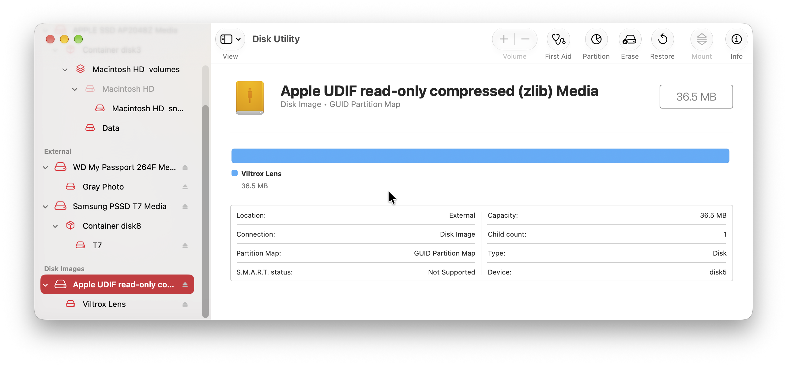

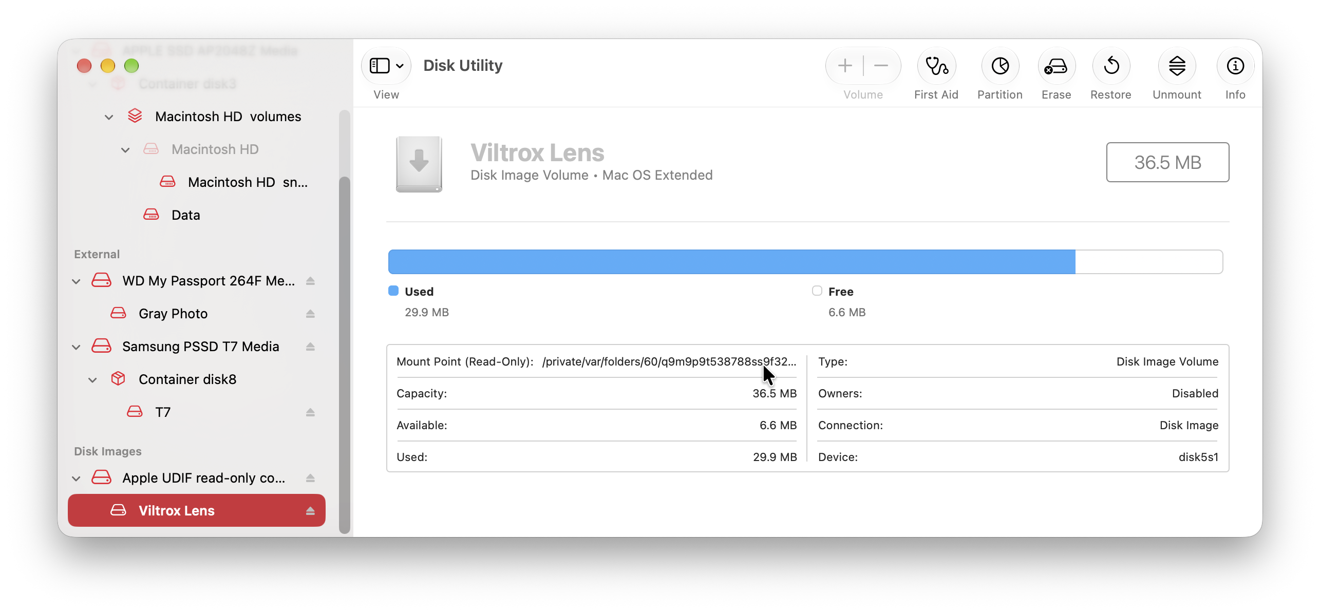

p.1 #8 · Trouble updating Viltrox 20mm f/2.8 Z lens firmware
kerrymattson wrote:
The 0.?0 firmware reading is definitely interesting. Since your other Viltrox lenses connect normally on the same Mac and cables, I’d suspect the 20mm itself rather than macOS. I’d try connecting it directly without a hub and check Disk Utility as well as Finder
I have been connecting direct to the MBP.
Disk Utility shoes this: Apple UDIF read-only compressed (zlib) Media : See attached screen shot
and under the above Viltrox Lens (also screen shot attached.
So, it shows in Disk Utility, but not in Finder or in the Viltrox Lens software.
I don't know what to make of this.
